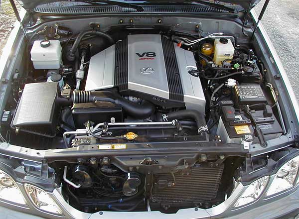

Can anyone speak to the differences between the 80 and 100 boxes?
It's quite different... the entrance and exit of the filter box. But probably could be done if you relocated the filter box's intake tube. (pics stolen from internet and mud)
yes only 2 major parts, 17700 and 17875. You may will need some bolts and clamps, but they are minor parts and maybe you will be able to reuse the original ones.
