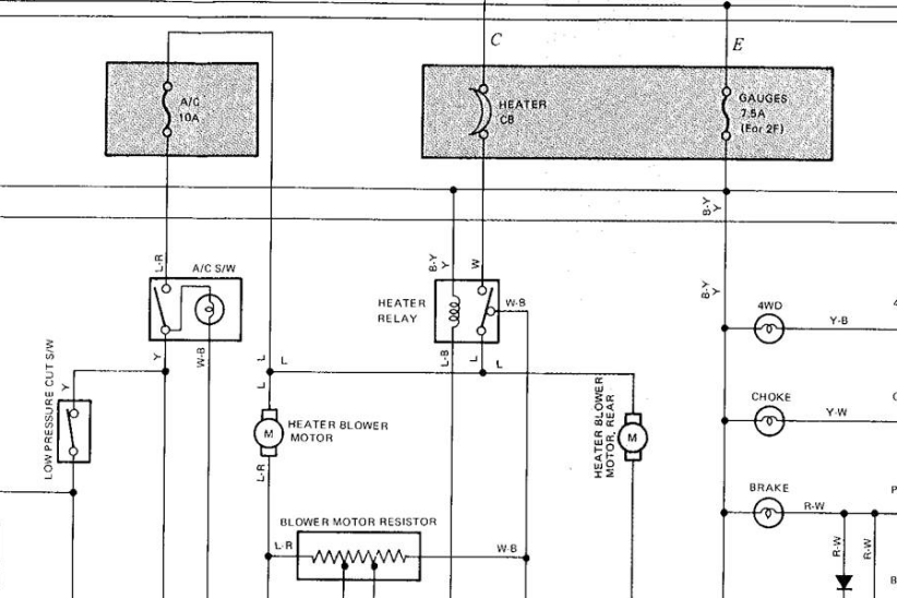

Does anybody have any thoughts? I have my ignition. I am not getting any power to fuse number 10A for the AC. All other fuses light up and work, but the A/C 10A has no power.
I just had a similar issue with my 80. It actually ended up being the switch itself on the AC climate control panel.
My mechanic was able to figure it out, try holding down the button to see if that helps.
