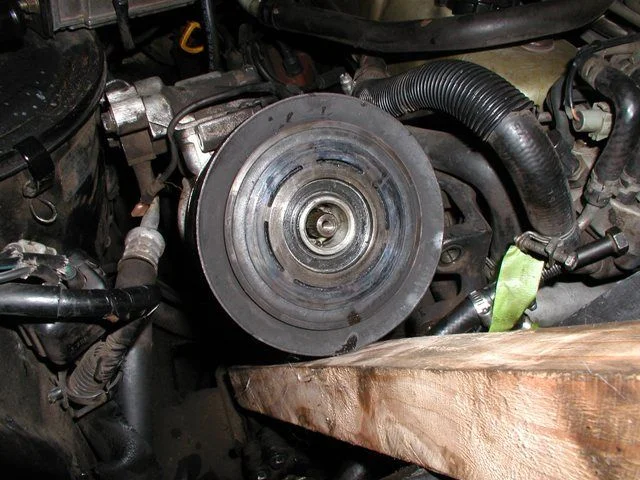

Has anyone performed this on a 91 or 92? My clutch looks different than the one posted earlier. I got the 10m bolt off, inner hub and compressor snout snap ring off. Now I'm stumped on how to get the pulley that's locked up off. I don't see any other snap rings. Do I use a puller? Ideas?

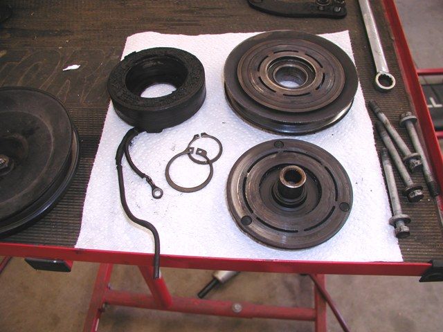

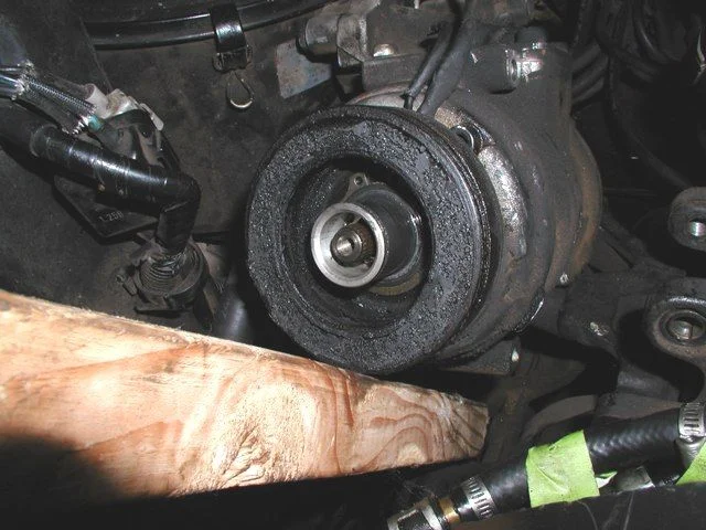

Update, Got the pulley off by using a couple pry bars on the back side. I kept working at it and it came off. Here's a few pics: The first one is of the pulley before coming off. The second one was the reason it was not coming off (Crispy). The last one is all three parts removed. Now it's time for a :beer:
The most common causes of the coil melting are 1) <13.5v at the coil, 2) high side pressure to high, from overcharge or inadequate airflow thru condenser or 3) low refrigerant causing rapid cycling.
Those melted coils can make it a real pain to get the pulley off-as you've now experienced. Well done! (both you and the coil)
From the looks of the compressor body, it seems as if the shaft seal is toast, causing additional problems. You need a new nose bearing, clutch and a front seal. Santech has all the parts you need. If not, try Sun Air. Neither may sell to you, but I can if you need the parts.

Update: Replaced the clutch from Cdan with new shim kit (3 very small washers). AC blows cold as it should. Conclusion; coil was fried to the pulley due to low voltage caused by the bad battery.

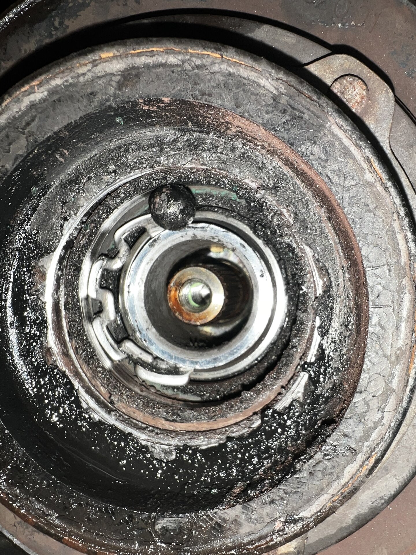

So I ordered replacement clutch on eBay for $89, and it was here in a day, and i installed in 2 hours taking my time. Pretty easy job, 1 🍌 no more.
And check out this old clutch. Wow. It sure was fried. The ring sure was easy to remove as it was cut in half already. And the rando ball bearing was neat.
