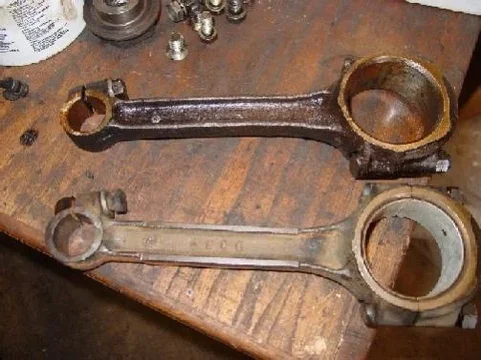

You don't need later Rods to run flat tops
Quantify "need", please.... Haha.
On the rods, newer is definitely better. As Mark mentioned, it's marginally lighter, but it's also much stronger because of the extra finishing on the I-beam.
In the photo, the lighter rod is the one that *appears* to have the i-beam machined. It is not machined, it has been "forged" along the i-beam. While the rod is still red-hot, the beam gets smacked in a press which compresses and aligns the grain on the edges of the I-beam. The flat areas are not machined away, but are made stronger. The rod picks up fatigue resistance by dint of the edges of the I-beam being much more crack resistant. The actual tensile strength of the rod beam is not significantly improved, but it is much stronger/durable in use because failures usually start as a crack at the outside edge of the beam.
more resistant to edge cracking = more resistant to ultimate failure
Thanks Steve for posting the pics
