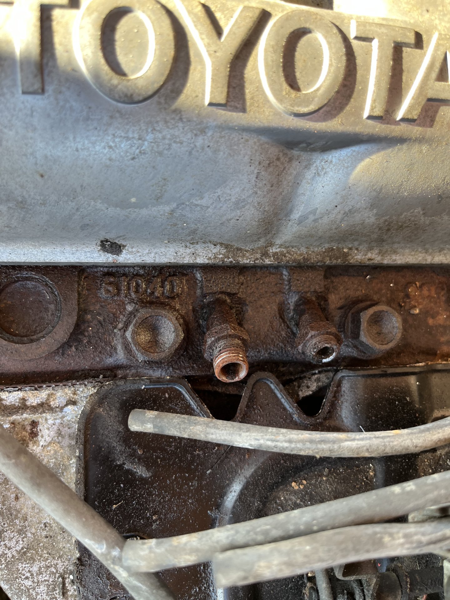

When removing smog things, the rust bit me in the butt. A few cracks and broken inserts on the air rail inlets. Maybe somebody smarter than me can tell me what needs to be done about this. Thinking just a small weld to seal it up. In good news, this is a 61040 head.....

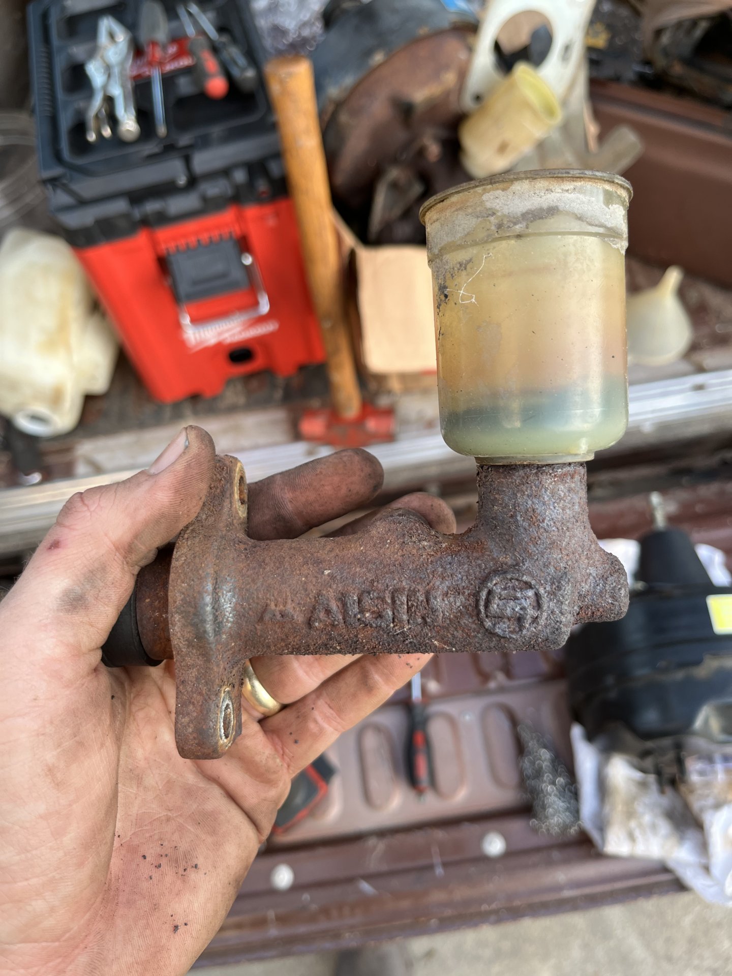

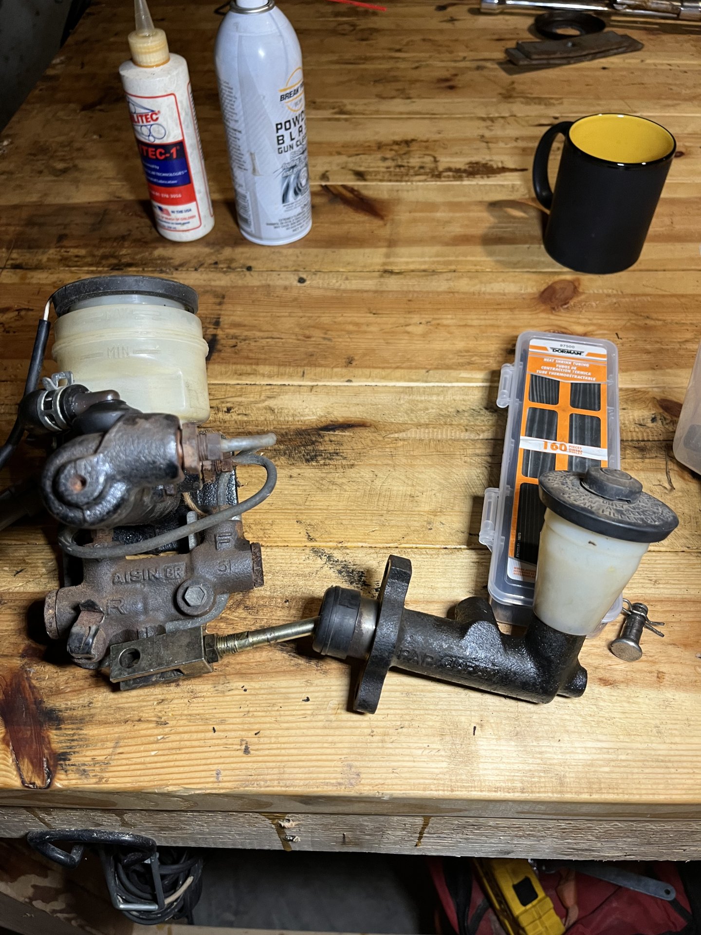

I went parts shopping in my basement and pulled an Aisin brake master cylinder and a "PAP" clutch master. This parts truck is paying dividends. Check out the old clutch master.

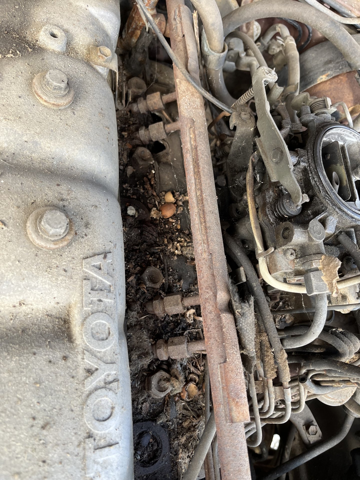

Well, I've run into a bit of a road block. 4 of the 6 air rail inlets are rusted so badly that they look to have become one with the head. I have yet to try extraction by heat, but one of the inlets sheared off with the rail itself. I removed the carb and manifolds to be able to inspect the extent of the rust in that area today and I'm not totally sure what to think.
If anyone has opinions on what to do, I'm all ears.

That looks tough getting the base of the air rail ports off. I guess I was lucky that a mix of pb blaster and heat allowed me to remove all of mine (destroyed the air rail tubing in the process). I did use a rubber mallet to bang against my socket wrench vs steady brute force.

My air nozzles looked like that too. A likely reason everything is so rusty up there is because there’s a good chance that one of the freeze plugs on the top of the head is weeping — keeping it wet up there which creates rust.
I got all my rusted nozzles off successfully using the following method:
1. Soak the area around the nozzles with Kroil or PB-Blaster penetrant. Let soak overnight.
2. Using a socket that fits the nozzles, place it over the nozzle and begin hammering it straight down with a regular framing hammer. Steel to steel. Keep up the constant tapping to set up a vibration to crack the rust bonds between the threads (microscopically).
3. Soak the area with penetrating oil snd let soak overnight.
4. Next day, soak, then repeat the hammer tapping on all nozzles.
When its time to try unscrewing one, use a 2ft long breaker bar with a pipe extension on it so it’s about 4 feet long.
Then give the bar a turn just the tiniest bit. Tug on it back & forth. You’re trying to break the initial rust bond.
When the nozzle finally budges the tiniest bit, apply more penetrating oil and rock the nozzle back & forth. Slightly loose and slightly tight. Back & forth.
The back & forth micro movement will break more rust free and allow the penetrant to weep in deeper.
If you stopped and soaked it and tried again the next day - they’d likely come out no problem, or if you’re impatient, continue on but always use tiny back & forth motions of the wrench in the beginning.

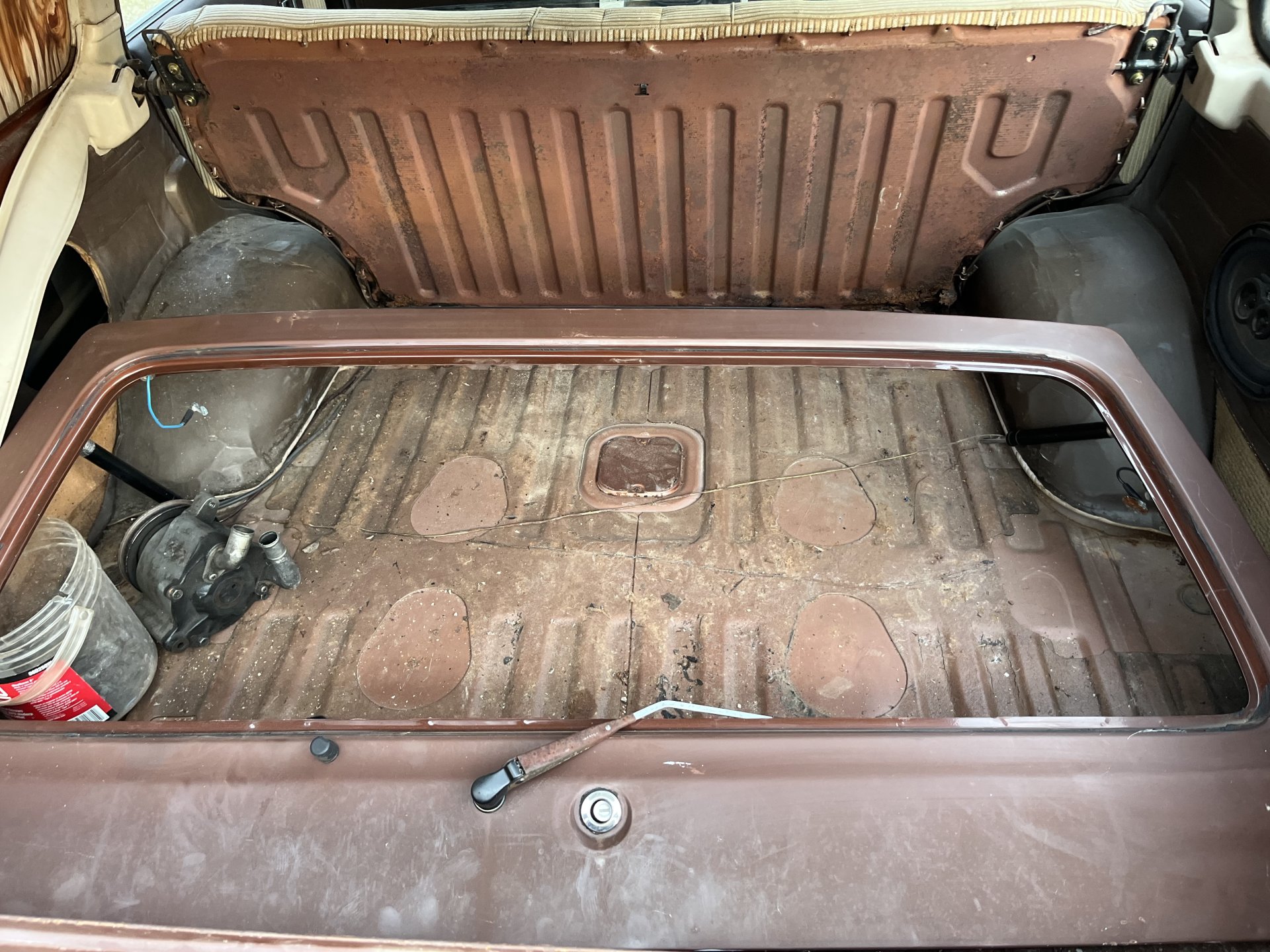

Pulled glass from the parts truck hatch and put it into the better hatch that the PO gave me. I'm glad to have this behind me after shattering rear glass option #1. This hatch is better, some crust on passenger side bottom and a hole up top drivers side. Obligatory pictures
