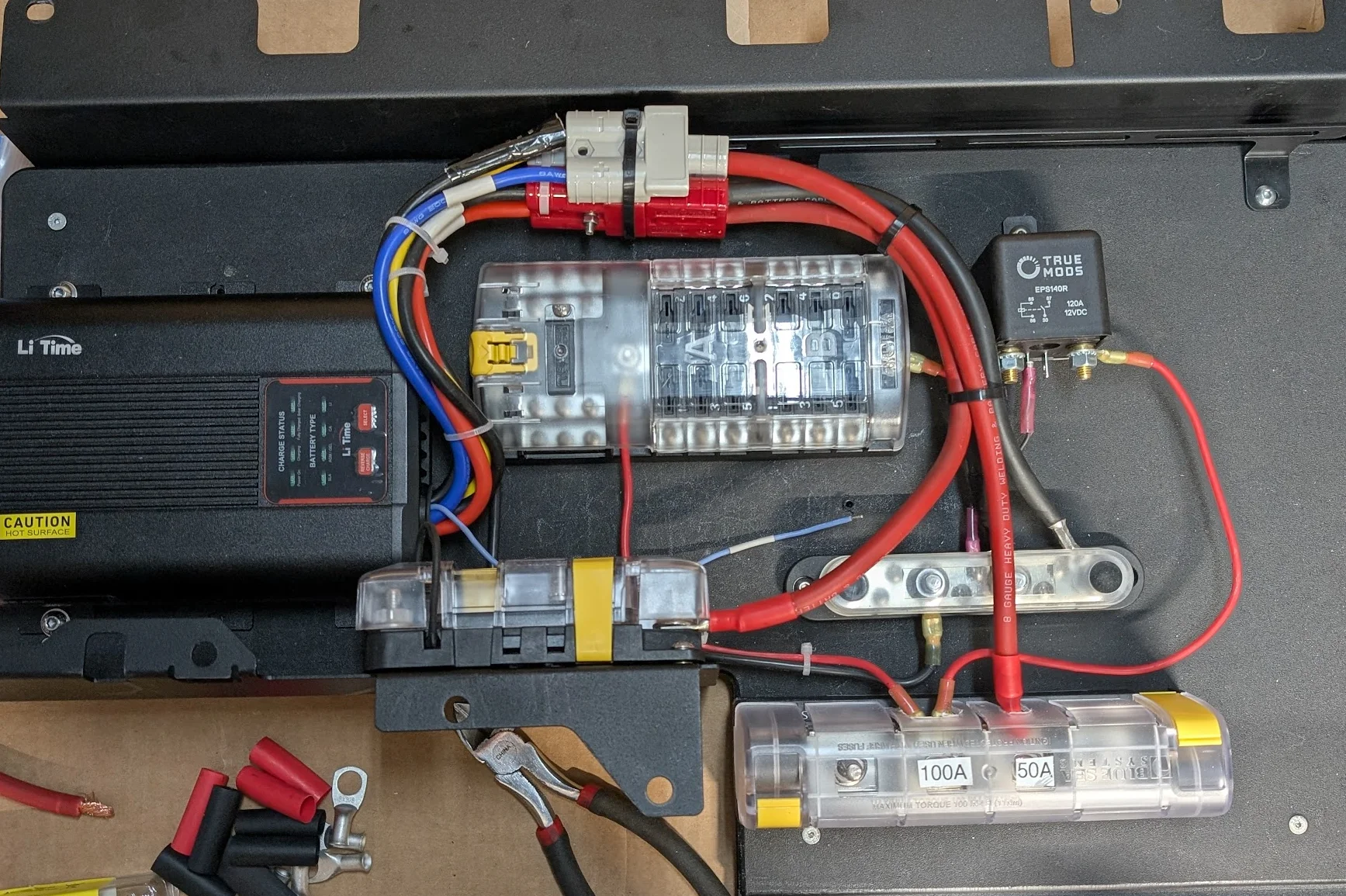

Wiring looks good. I’ll hire you to come down to Battle Ground and help me out in the coming months. My wife is Brazilian….. we can toss some meat on the smoker and talk automotive wiring technique.
That sounds like a good time!
I have a couple buddies from flight school that live in your neck of the woods!
Redarc got back to me and they gonna replace the DCDC charger for free. Quite the relief!
So I took it out the broken one and sent it back to them.
Yesterday I decided to just install the QPM without the charger, and Ill just put it back in once I get the new one
I cleaned up the wiring a bit today and put the trim piece back on
Not bad!
