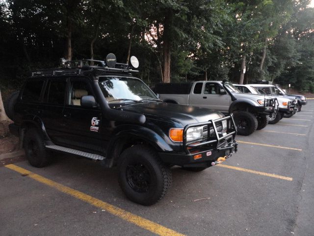

We're about to head out on the first serious test drive. It's about 130mi round trip to the Capital Land Cruiser Club meeting. Off we go...
We've got just under 200mi on the truck now. We did a lot of monitoring on the way up to the Capital Land Cruiser Club meeting, but didn't want to change any aspects of the tune on the first real outing.

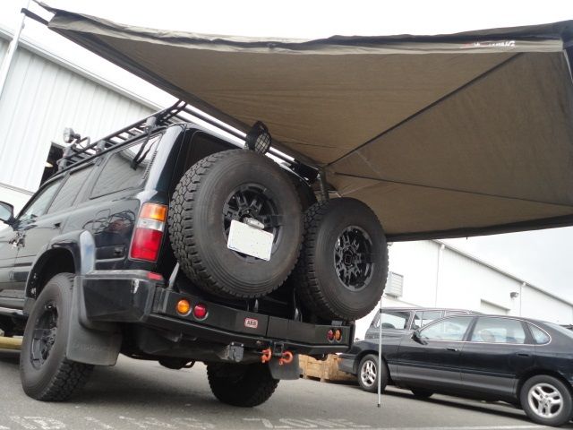

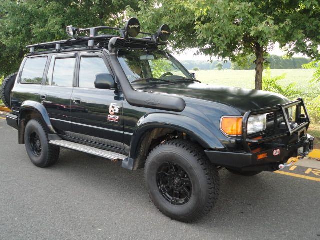

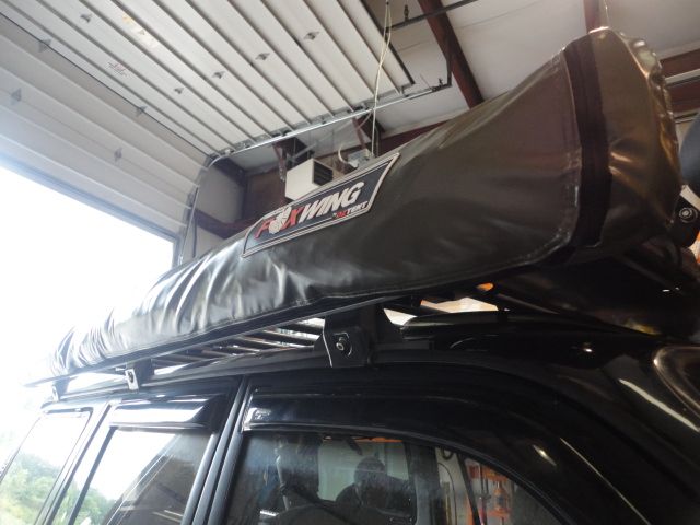

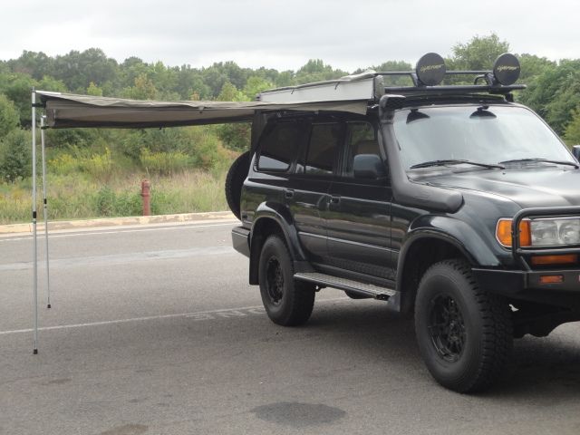

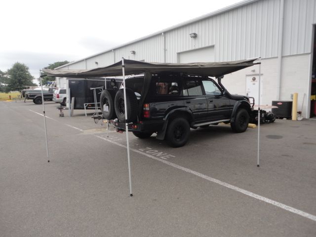

We are about 700mi into the test drive and this truck is rocking out. We also did some other bells and whistles on the truck and this one is too cool not to share. We picked up a Foxwing Awning from the guys at Southeast Overland.

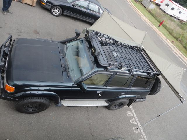

It deploys and packs up super easy...
...and it's HUGE.

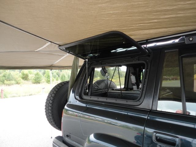

The Wagongear windows are super handy.
