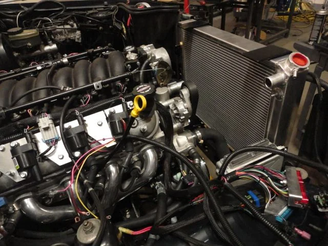

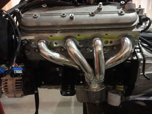

Would the stock manifolds work at all?
Maybe I missed it, which manifolds are you using?

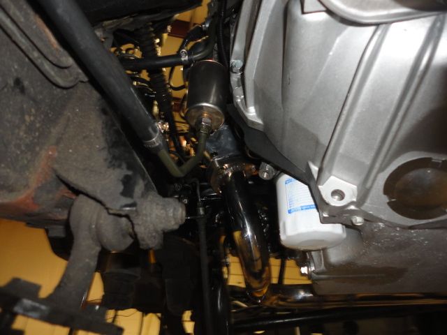

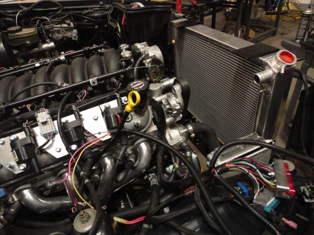

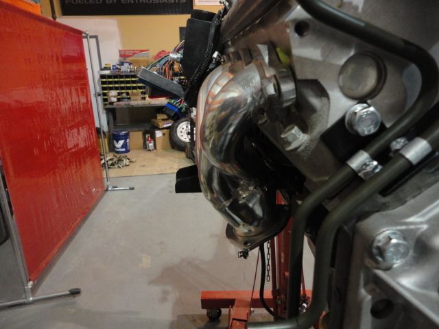

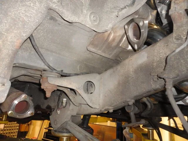

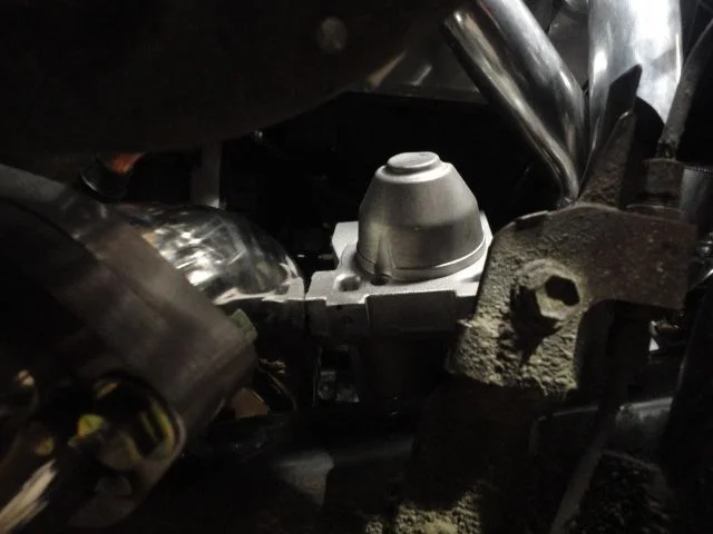

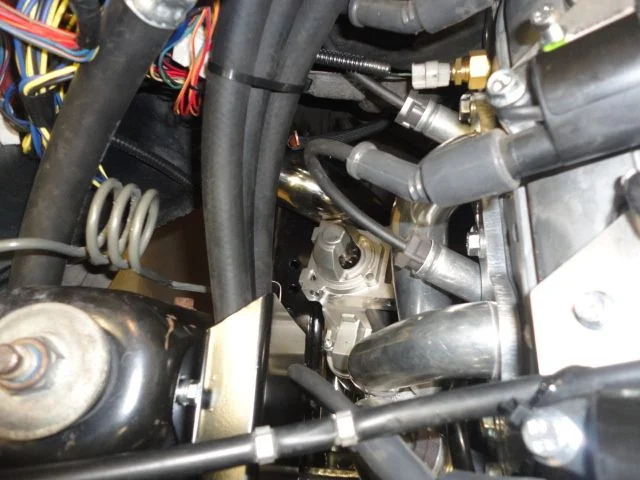

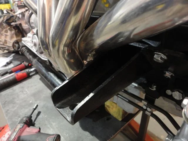

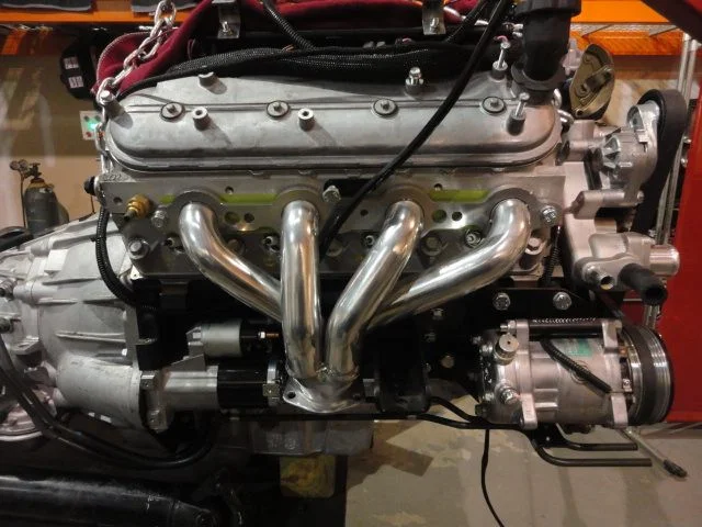

The answer to "What manifolds work," has a lot to do with what engine mounts are used and how you set them up. On this particular swap, we ended up using a set of headers from Hooker. They are a block hugger with a center-ish dump. Here are some shots to show how they fit with mounts.
There are probably several manifold setups that could be made to work, depending on how you set up your engine mounts and route everything.

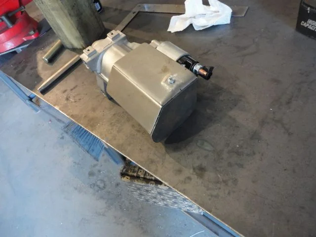

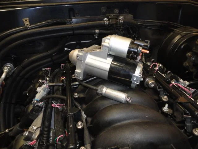

...AND the starter can still be changed out with the exhaust in place. It does require a little twisting and turning, but it comes out through the top and the only other thing you have to remove is to unplug one of the plug wires.

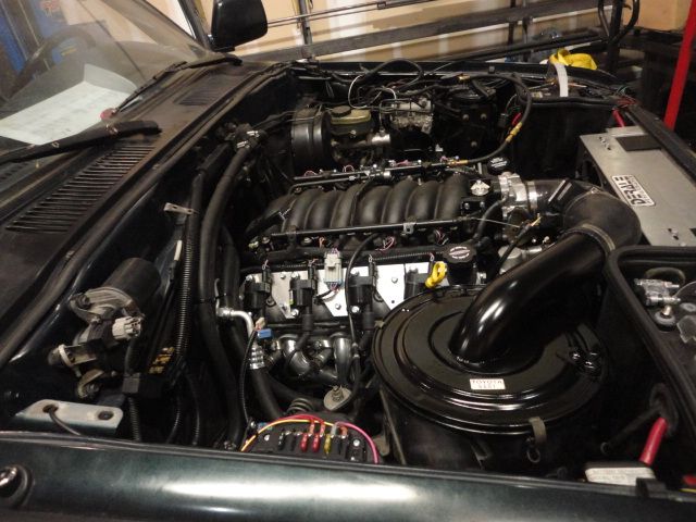

We're hoping to fire it up early next week, but we've got a lot of buttoning up to do on the truck(things that aren't necessarily related to the drivetrain swap).
