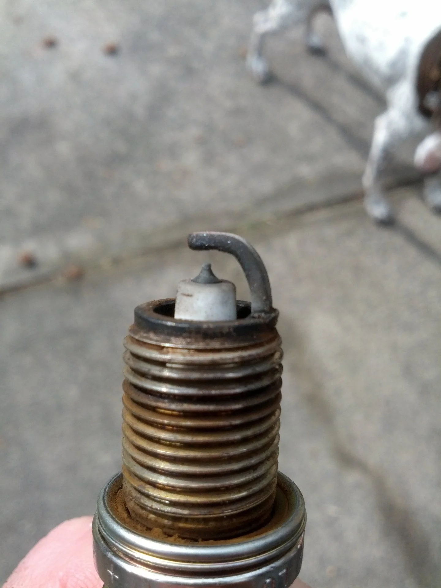

Started running rough and then CEL came on today, P0300, P0302 and P0305. Any chance this could play into my noises?
I'm thinking of trying the 8 coil packs for 80 on amazon, am I kidding myself thinking they may actually work?

Spark plugs looks pretty good, a little bit of carbon build-up. You may want to carefully clean carbon off, then check gap of each one just for your records. Gap can give indication of how each cylinders spark has been (clues).
