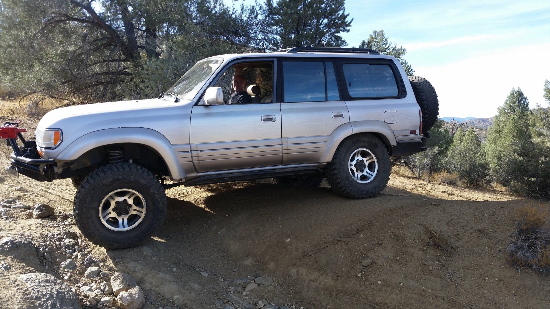

Some testing/poser shots...
I haven't been doing a good job of keeping up with this thread. Added a winch, lights, and changed the starter....

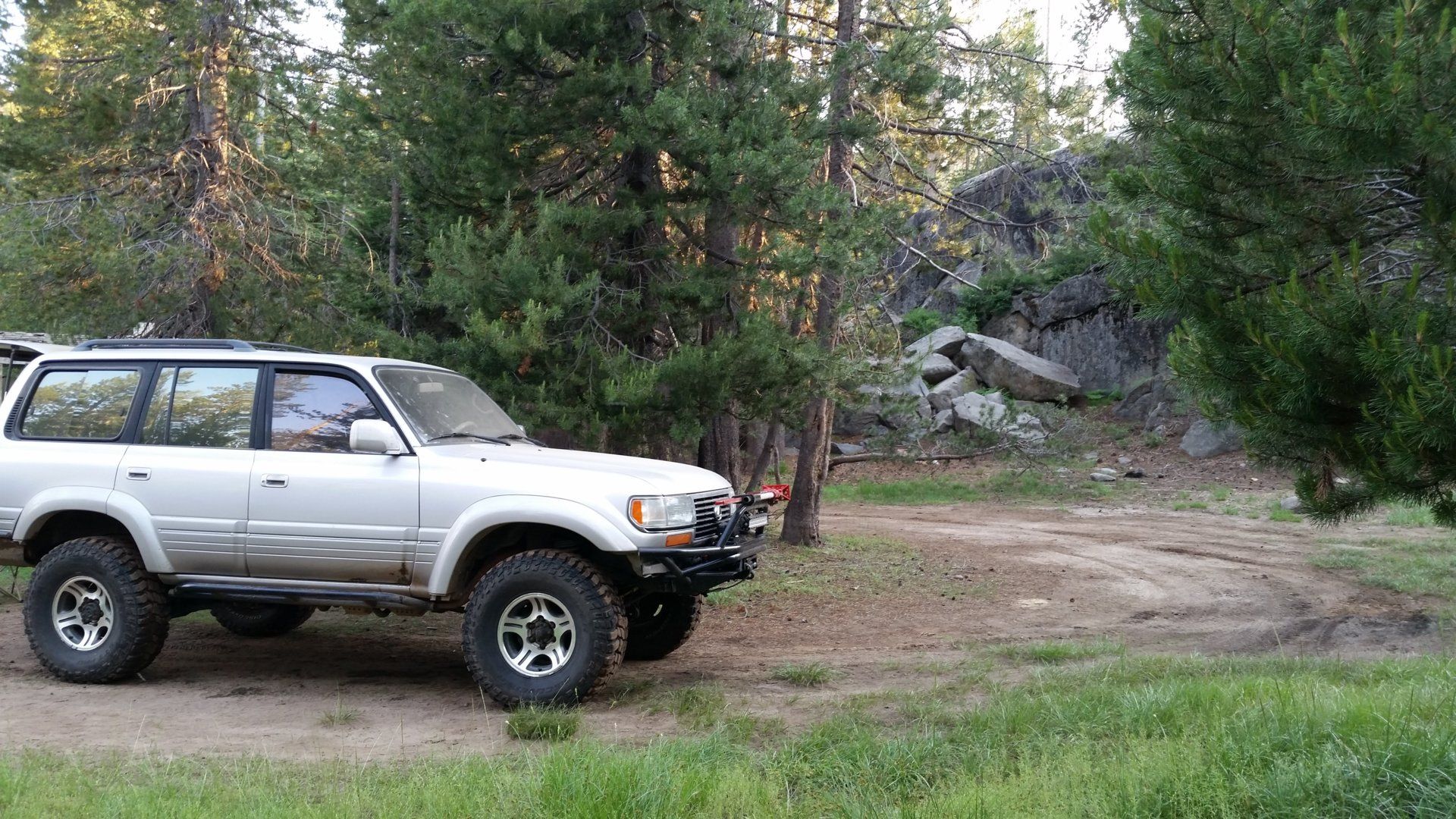

Great time at the Head for the Hills poker run with some cool people. No locker = no bueno, addressing it today

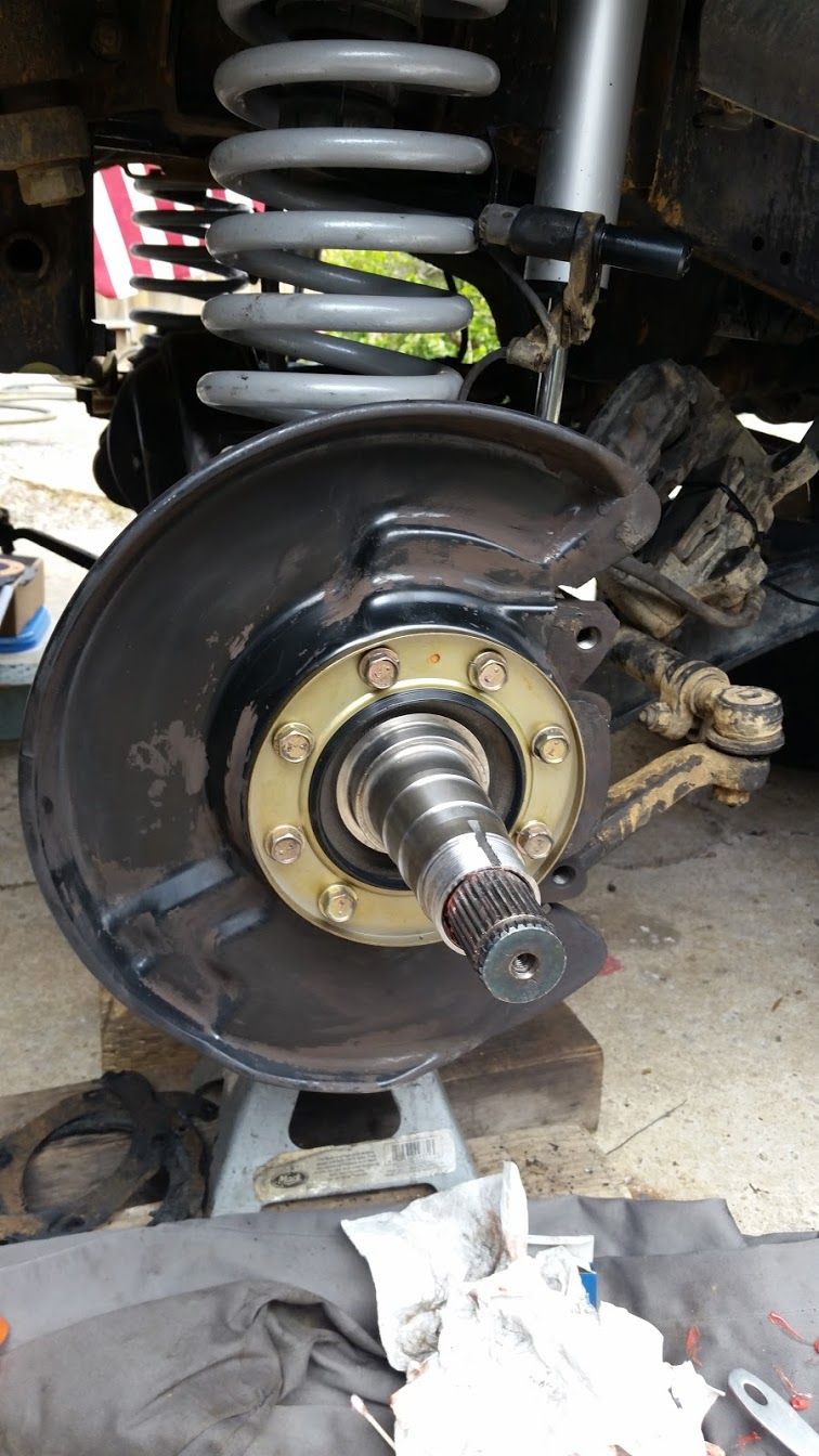

Well, I got the rear axle stuffed with an ARB and rebuilt. Got most of the front done too but broke a steering arm stud while reassembling so am waiting on parts...:( To be fair the front axle took longer than I needed to as I went super slow methodical was on it...:)
