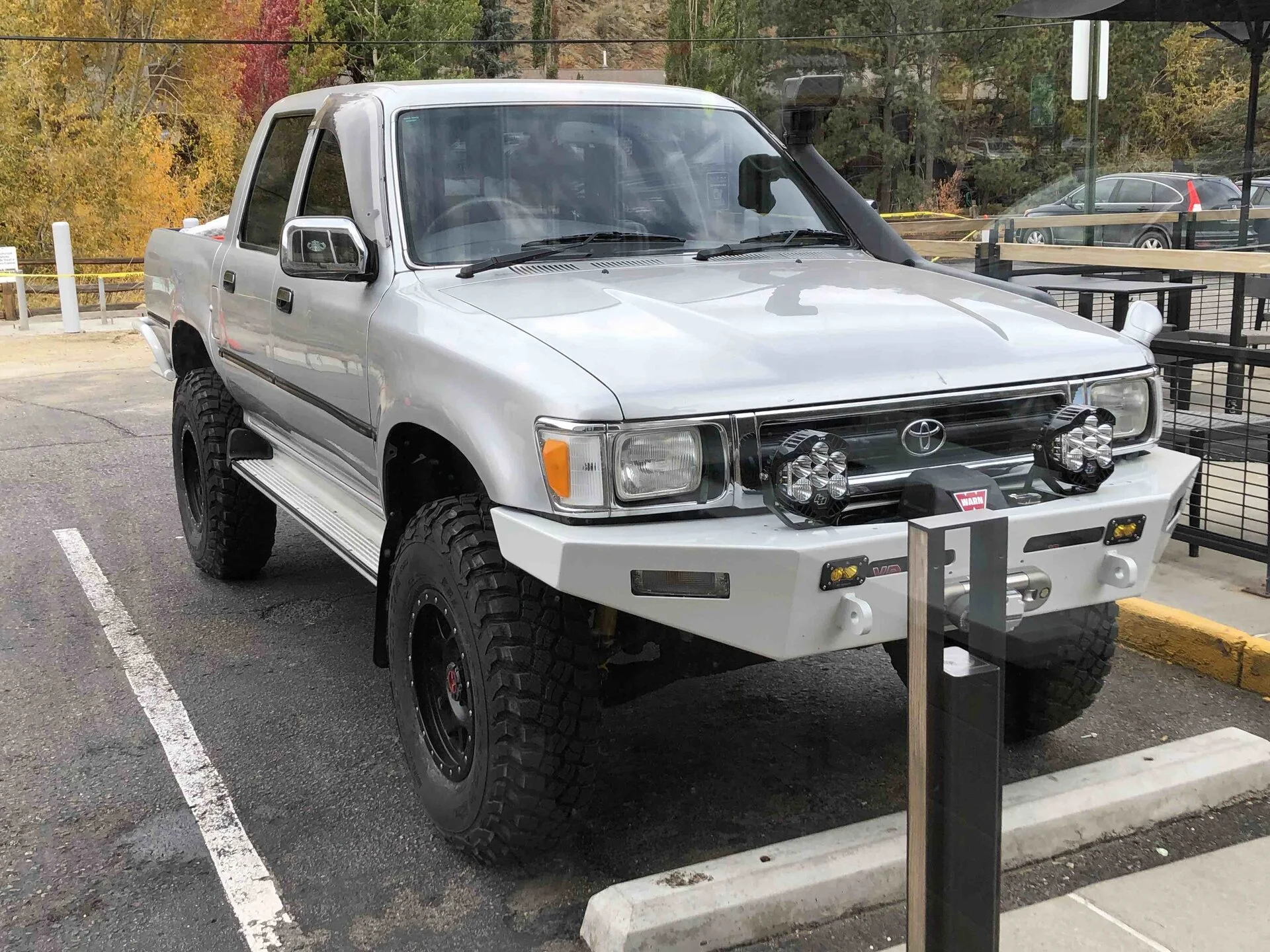

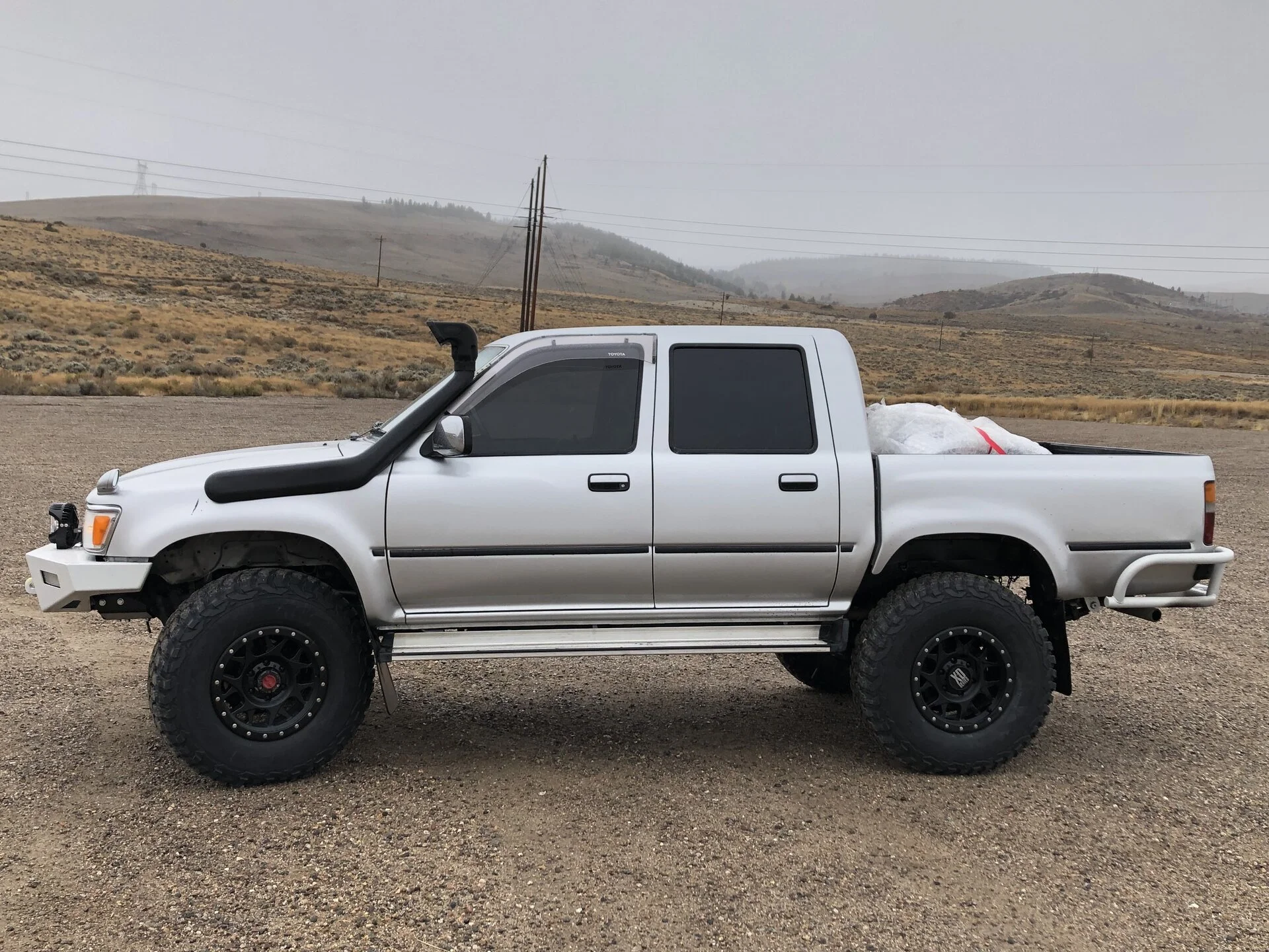

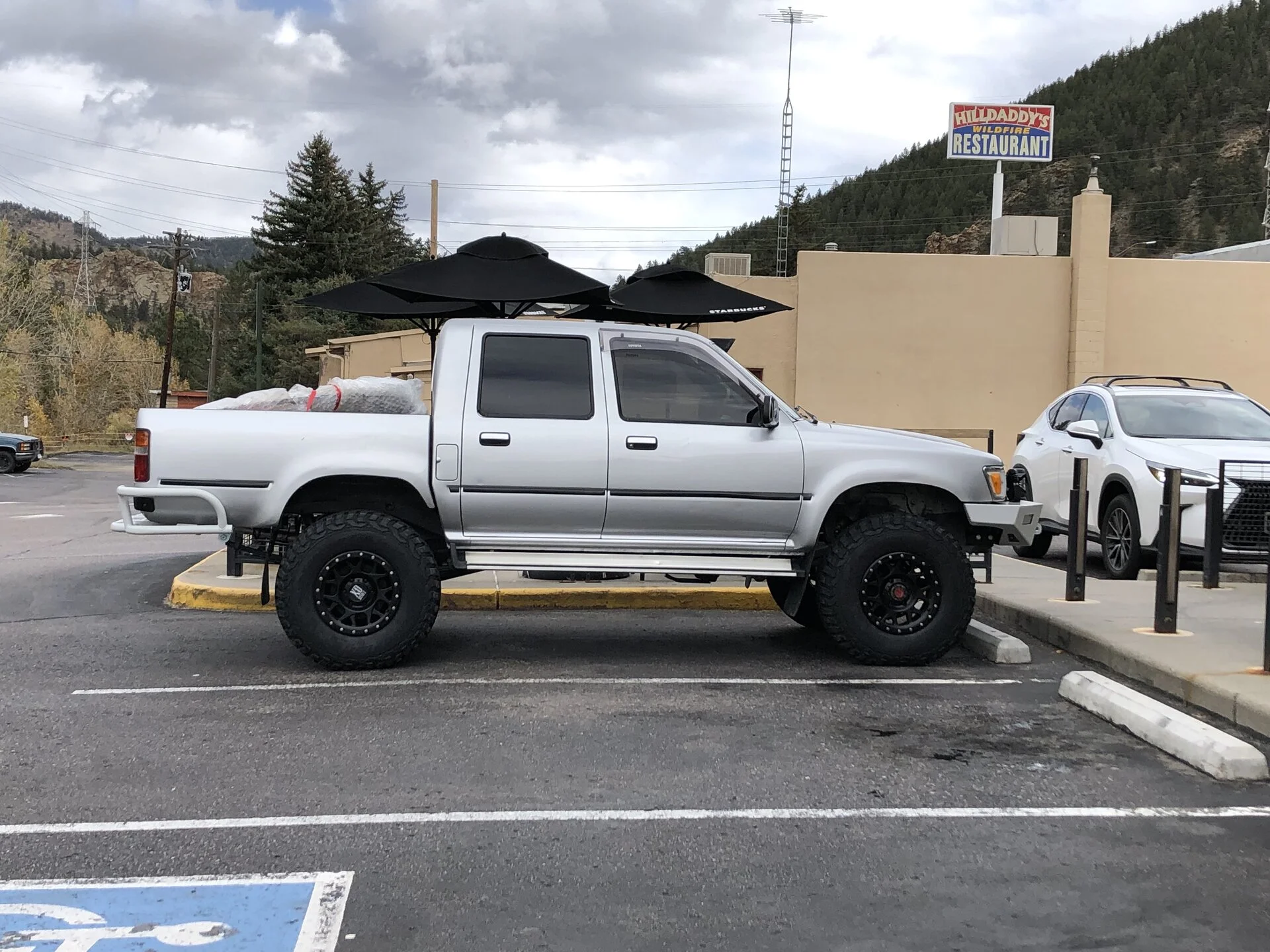

Went with ARB torsion bars and rear leafs on mine. quite happy with the way everything came out. easy to order here in the states.
What shocks did you use?
ARB. basically went with the full ARB kit, only had to change the rear shackles, to make everything work. i'll post pics and part #'s shortly.
