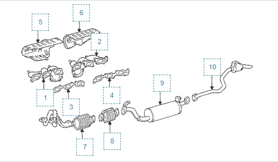

Here's a list of exhaust parts I compiled/purchased back when I was getting this done for my '97 (disclaimer: not accountable for any inaccuracies):
1740166090exhaust front
1845066120cat
1740366041exhaust center
1740566010exhaust tail
9091706065 (9008043036)exhaust gasket (2)
9017910070 (9008017187)nut (4)
9010510388bolt washer (2)
9091706076gasket rear (2)
9091706043 (1745152060)gasket front
9418041000nut (4)
1849576010retainer exhaust pipe
9151161035 (9008010204)bolt flange (8)
9165160830 (90119A0043)bolt (2)
1758170080damper exhaust pipe
9162160835 (91651B0835)bolt
9165141020washer (2)
1757161211bracket
9017906007nut (8)
1756717010cushion exhaust tail pipe, center, rear (3)
9011908701bolt (16)
9011908862bolt (2)
1757266050exhaust support bracket
1757361060support bracket
1757461080bracket rear
1714166020manifold exhaust
1714266010manifold exhaust II
9012610006 (9008012007)BOLT, STUD(FOR MANIFOLD TO EXHAUST PIPE) (8)
1717366020GASKET, EXHAUST MANIFOLD TO HEAD
1719866010GASKET, EXHAUST MANIFOLD, NO.2
9011610169BOLT, STUD(FOR MANIFOLD TO CYLINDER HEAD) (13)
9012608008BOLT, STUD(FOR MANIFOLD TO CYLINDER HEAD) (2)
