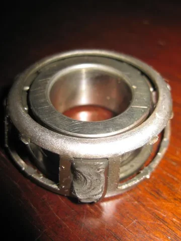

Rebuild both front knuckles including 4 new nuckle bearings (trunnion bearings) the bottom DS Trunnion was destroyed, the PS had some wear. Replaced DS wheel bearings (Spindle Bearings).

Damaged Bearing

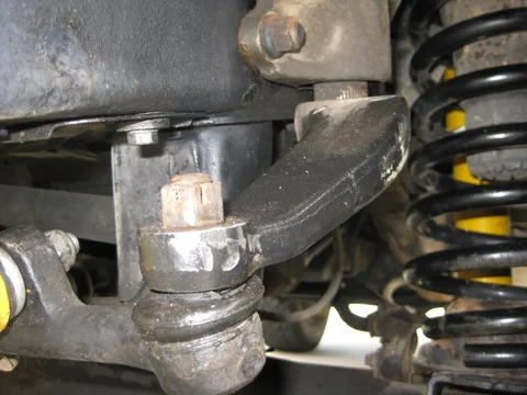

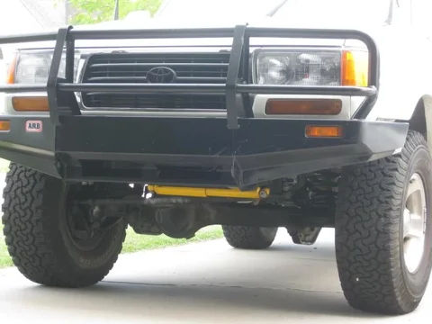

The ARB was bent a little with the DS wing pushed up about 1/4 inch or so but is not noticeable unless you really looked hard and close. I was able to pound the small dent at the bottom out with a 10lb sledge hammer and then shot it with some black rattle can.
Just looks like you actually wheel it. :cheers:

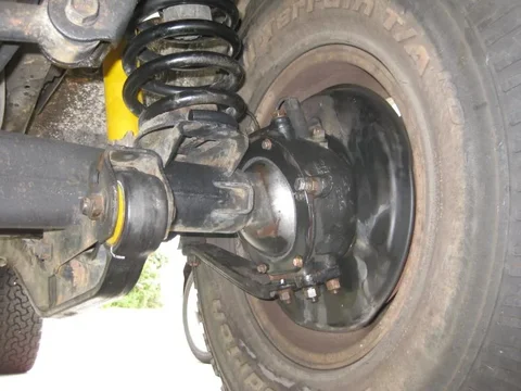

I would check the axle housing. In the type of collision you had they bend very easily. Was the wheel pushed (turned) over all the way. Check the back steering stop on the housing. If the steering stop is bent in by the bolt, I can tell you that you have a very good chance of having a bent housing. Seen that a lot in wrecked trucks we buy. The wheel acts as a lever and bends the housing right where the knuckle ball connects to the housing.
Also check your sector shaft for twisting.
Christo do you ever see a lot of rear axles bending like this??
I have seen a couple bent rear housings, both from collisions.
