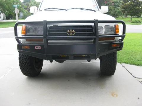

I was in the right lane (lane 2) heading North, she was in the center heading south and turning East across traffic. A car had stopped in the Northbound lane 1 to allow her to cross. I didnt see her until she was in my lane.
The collision caused her car to rest facing North in the Northbound lane 1 with my car next to hers in lane 2.

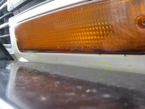

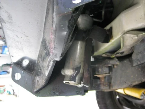

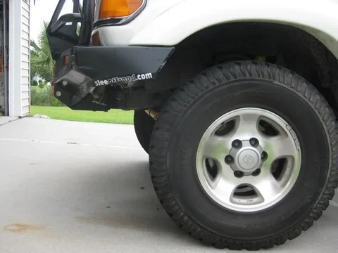

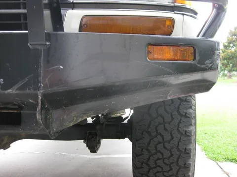

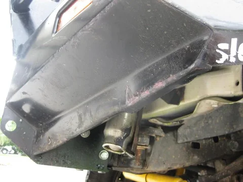

Bumper damage, its tweaked up and it did bend back a bit but you almost cant tell.

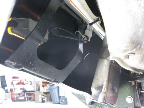

Not a big surprise. They'll probably say that the body panels got tweaked by the bumper and need to be fixed (big $$$), and of course all the steering parts aren't cheap.

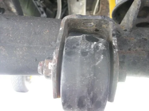

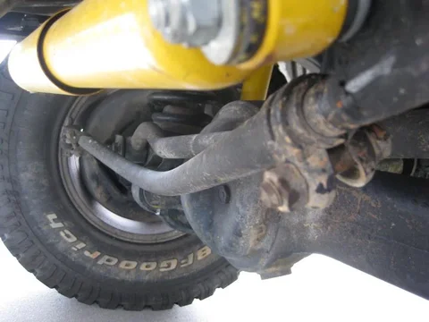

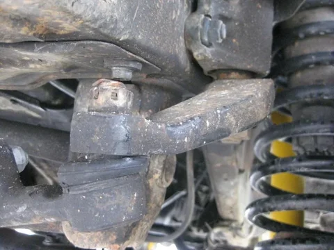

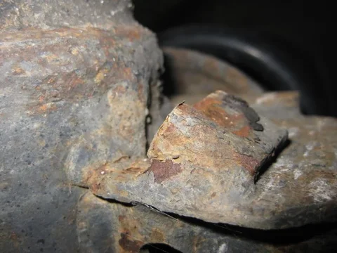

IIRC you can upgrade the sector rod to the 100 version, which is beefier (it isn't super cheap, but good time to do it). I'd just bend the rods back in place and either sleeve them or weld on half tubing (or angle iron). Cheap fix and you'll be better protected for playing in the rocks (or your next head on collision :lol: ).

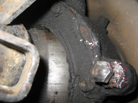

Ok, Just got off the phone with the insurance company. They are giving me the cruiser plus 7k cash for the damage. Bad part is the title will be salvaged :(. The main reason for this is the quote for a new steering box is $2800 for a new part. Total mechanical parts quote is $4975 and $2500 for new bumper and repairs to the fender. If repairs are 75% of the value they must salvage the title or total the car. Looks like this one goes straight to the crusher for a $250 used part ;) But hey its the American way!

Looks like your cruiser took it like a champ, I assume you drove home after that wreck? That ARB bumper saved lots of potential body damage it looks like.
