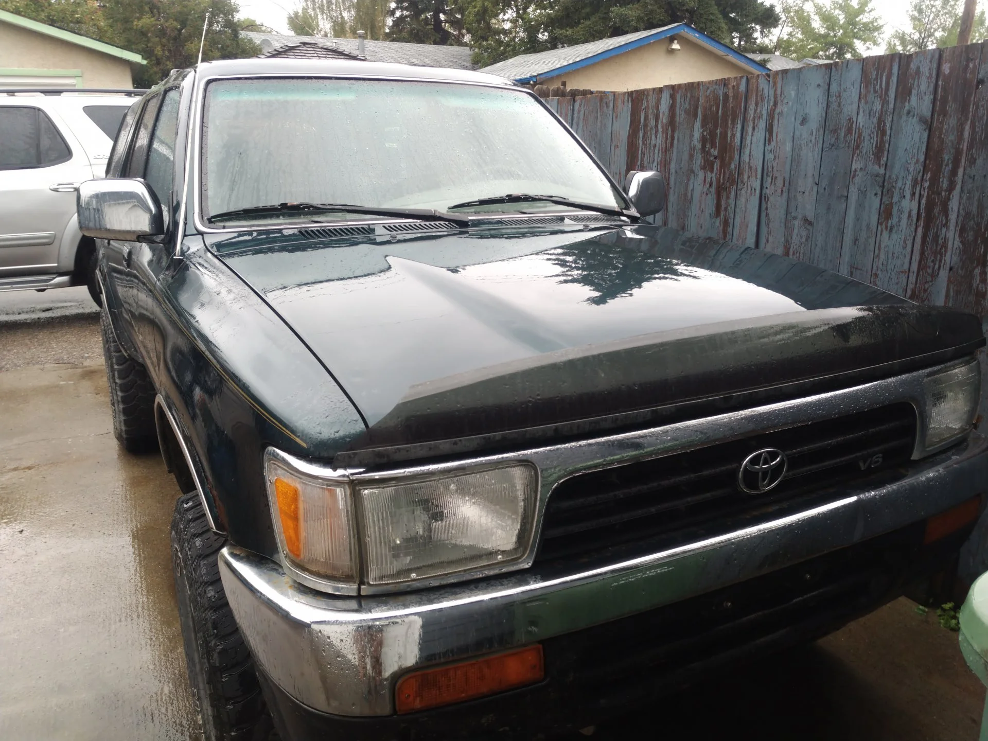

I've got this new to me 95 4 runner and the tail gate window is suppose to go up and down. Thinking this is how you drop the tail gate by lowering the window ?
So now the window neither goes up or down and I'm unable to drop the tail gate.
I'm hoping someone or more can chime in and reply on how to fix this issue !!!
Does it not work from either the interior switch or by being activated by the key in tailgate lock? There's a relay module inside tailgate that frequently goes bad on these. Also, rear wiper needs to be properly returned to its "holster" for the window to work.
I'm going to look today. I'll return the wiper to the holster and try with key and the panel switch. Hopefully thats it ! Then I'll look at hot wiring the switch to find out if the relay is gone. Thanks
