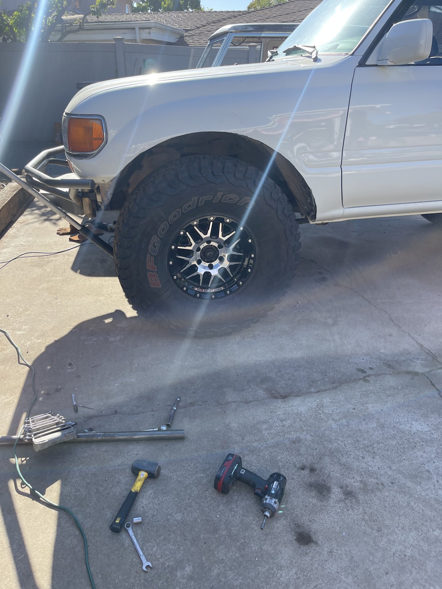

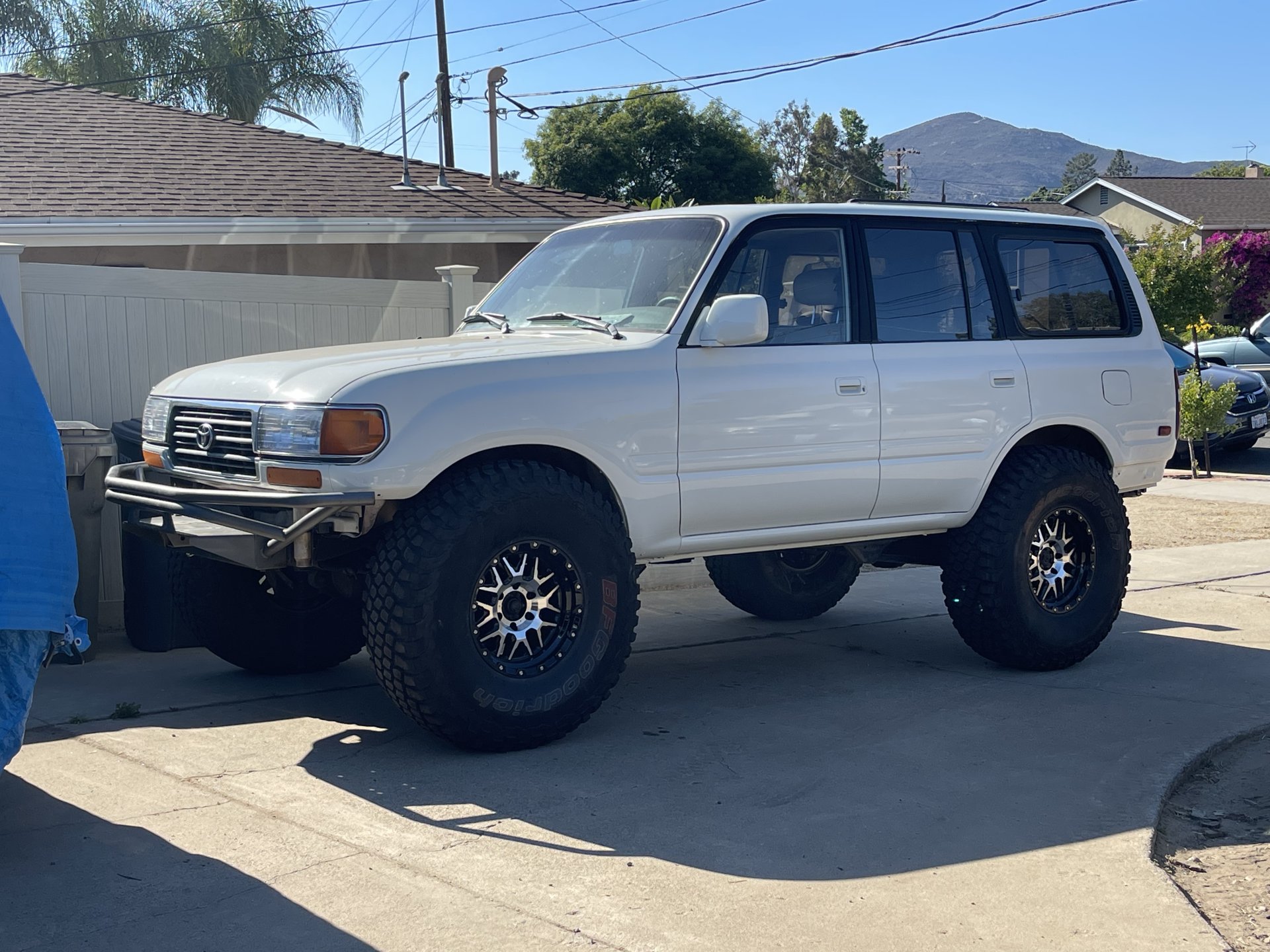

Currently building a 95 with 40s and a 2.5” lift
40x12.5x17.5” Bfg Baja

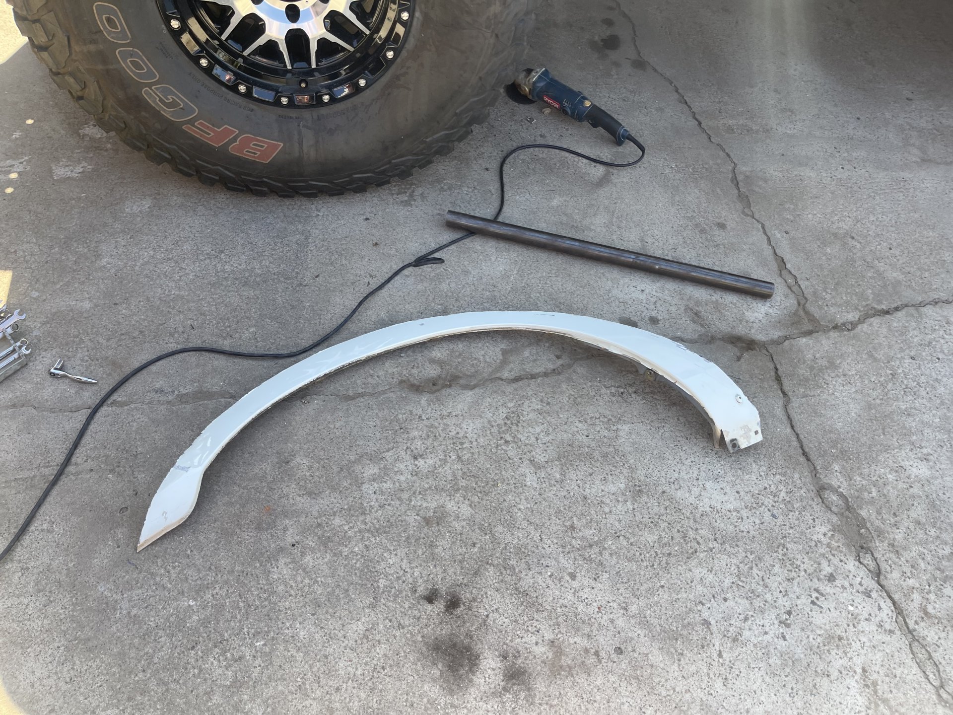

Cut the front fenders still need to trim the rears

40's look sick. Makes me almost want to go with 40's the next time around.
Can you share pictures/details on how much you cut from the front and the rear?
What are you doing about bump stops extensions?

Strait to the sawsall in the 1st post.
40x12.5s KR3s... please post up specs on those for sure.(tread width) They look just as wide as the 39x13.5 KM3s.

Just noticed no fender holes... looks like a clean ride.
Have you seen threads about fitting 40s on a 80 & how much cutting, moving forward & bump stopping you have ahead of you?
Check out @ Broski 's adventure rig build thread. Also Clifford the tubbed red 80 w/40s/no lift.
With the amount of cutting and fine tuning you'll be doing, pick up a nibbler. Cutting and tuning fenders with a cut off wheel or Sawzall is painful and it will be cheap investment in comparison to what else you have going on. Of course, I'm telling you after the big cuts are done :rolleyes:

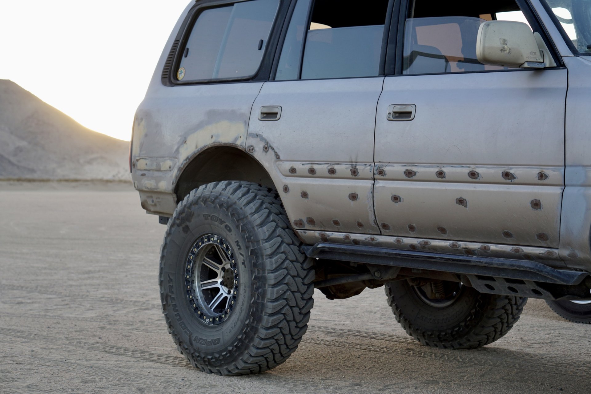

I am so envious that you don't have many holes to weld up. On my LX450 I am looking at over a 100 after removing flares and the rest of the plastic.
I'd foil tape the holes and bedliner the bottom of the panels where the cladding used to sit. You're never going to get paint on the back of all of those fresh welds which sounds like a rust problem waiting to happen.
And yeah, I'm jealous too. I left my cladding on (which I hate) to avoid the problem.

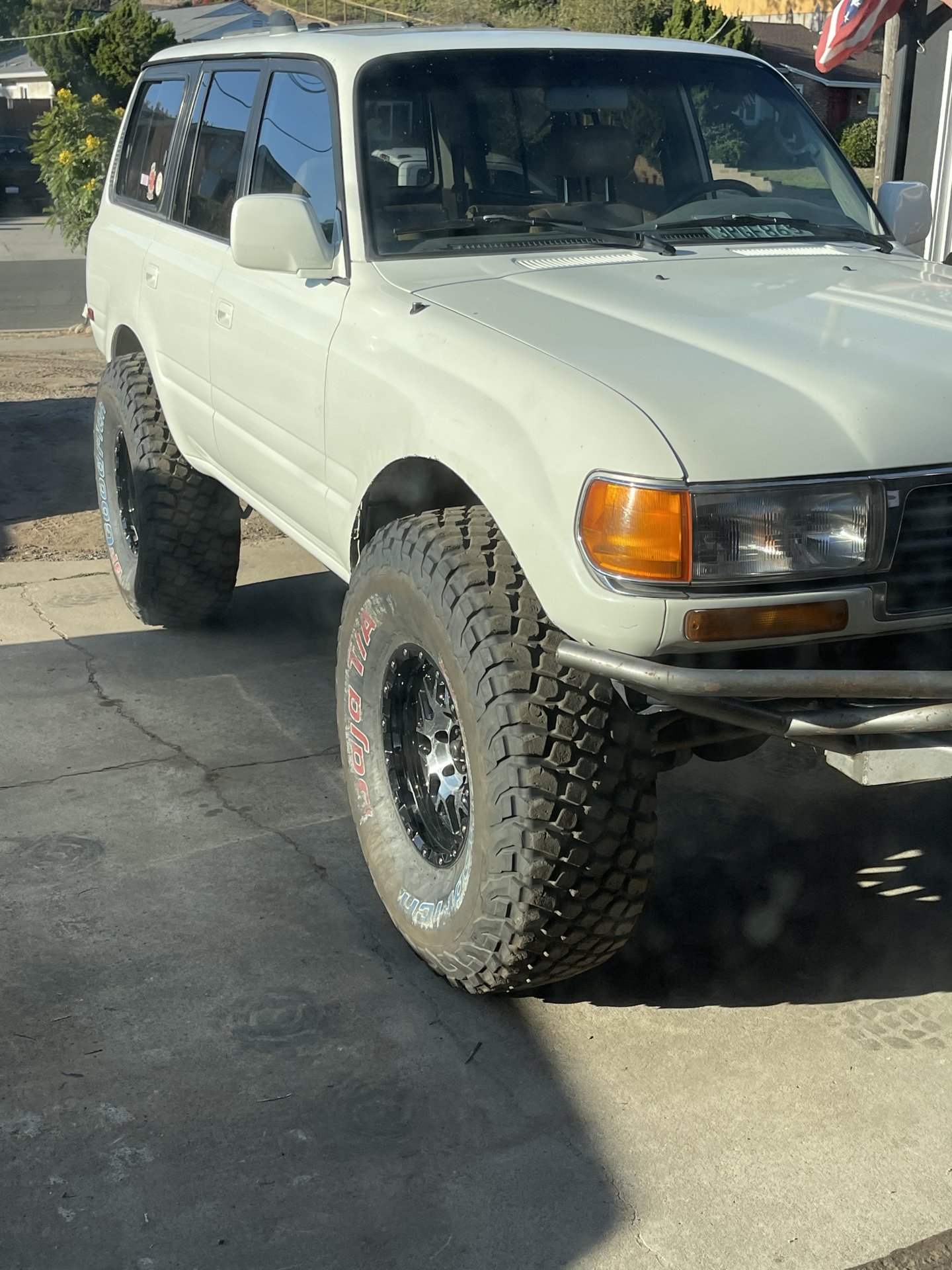

It's hard to explain, but the asthetics of 40's or 42's on a cruiser is just about perfect IMO.
I remember going to 38's and then about 6 months later thinking they didn't quite match the thing. My 42's and 40's are pretty close in size, but the 40's I'm running (patriot 40x15.5R20) are a bit wider than most and just seem right for it. With the ram assist the steering is nimble enough, actually a bit touchy.
Having said that, 33x12.5 tires on a stock height FJ80 look pretty good too for some reason.
