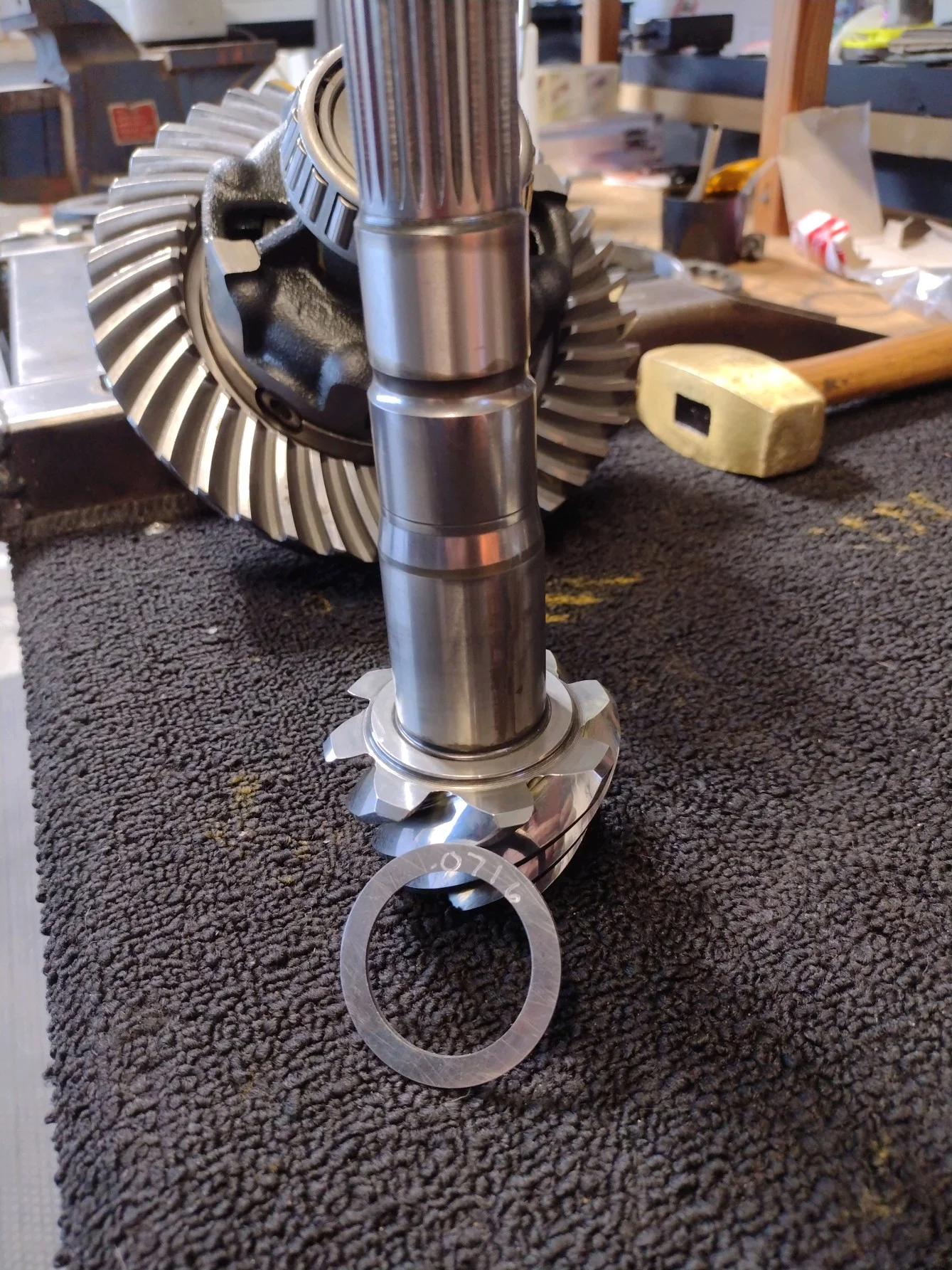

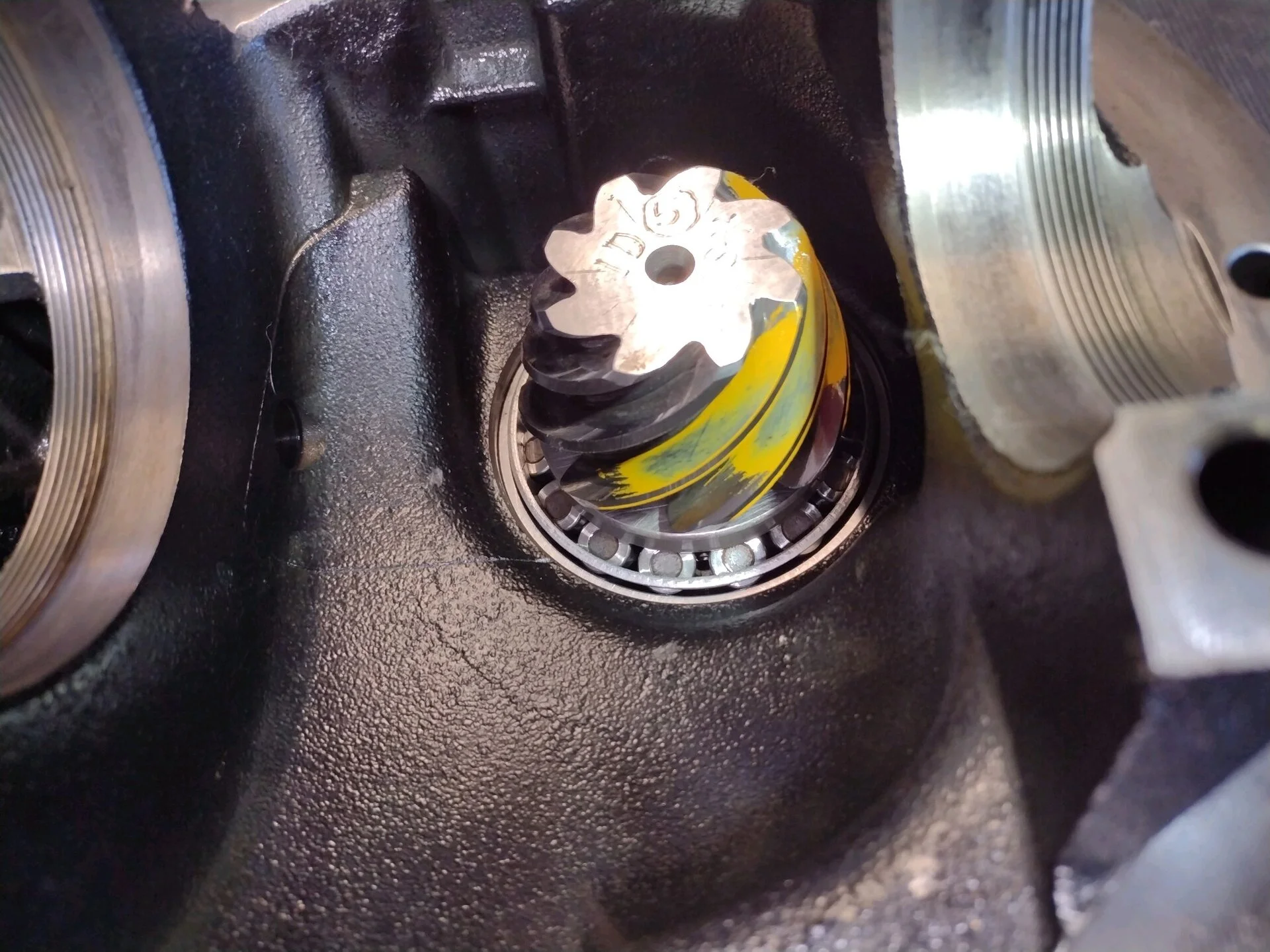

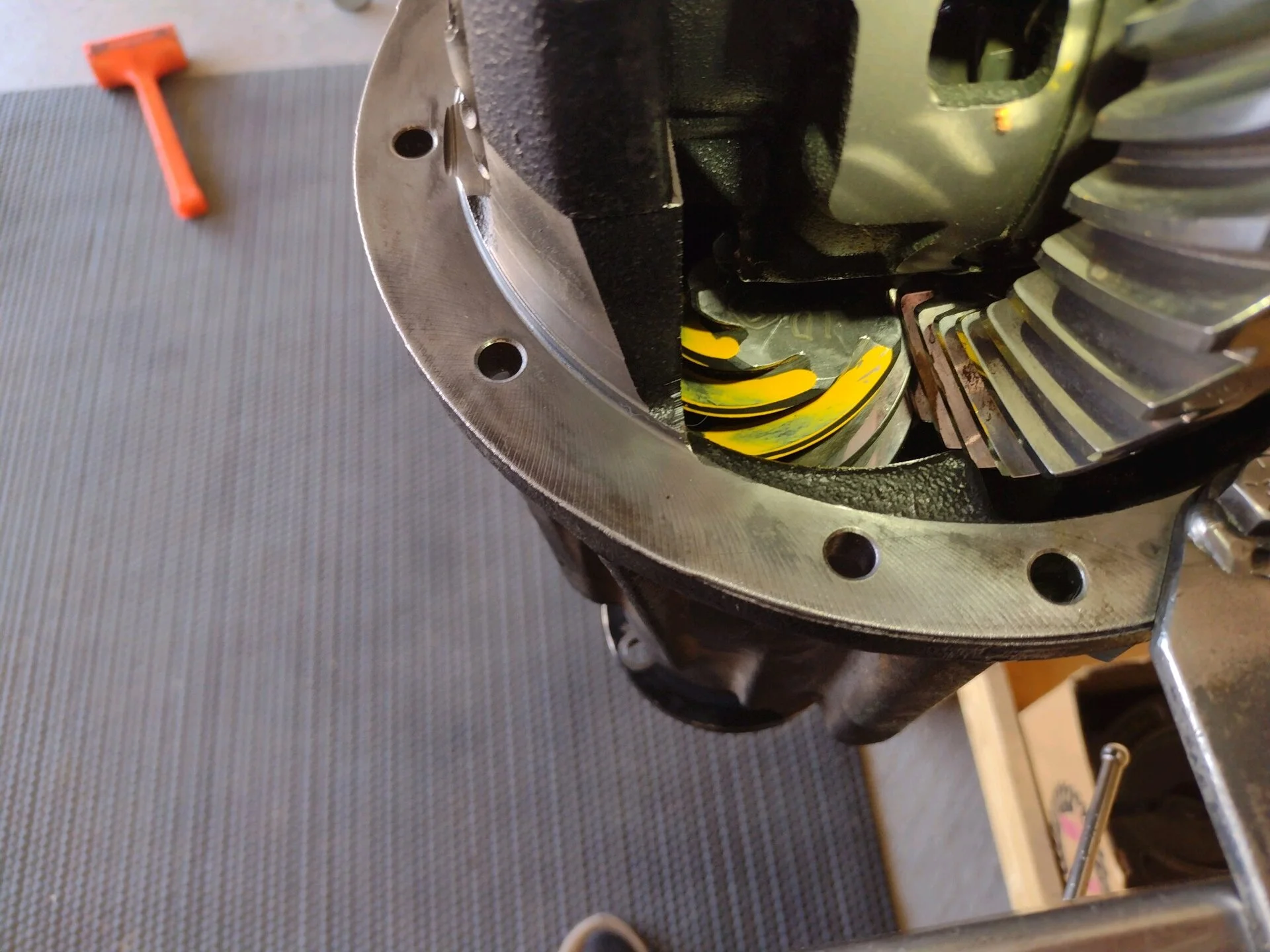

Everything is the opposite when you're talking about the pinion tooth so instead of being too deep on the pinion you will see that now we are too far to the outside of the tooth
Basically you're looking for the loading from top of tooth to the root of the tooth and putting everything in the center

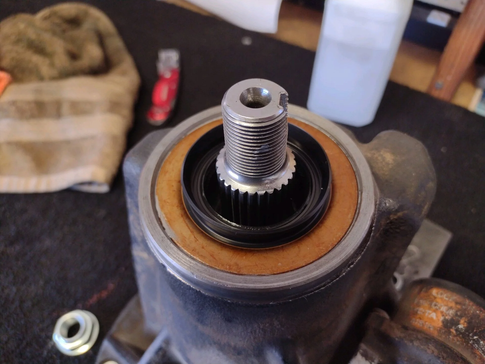

Factory 38047 seal is recessed 2 mm

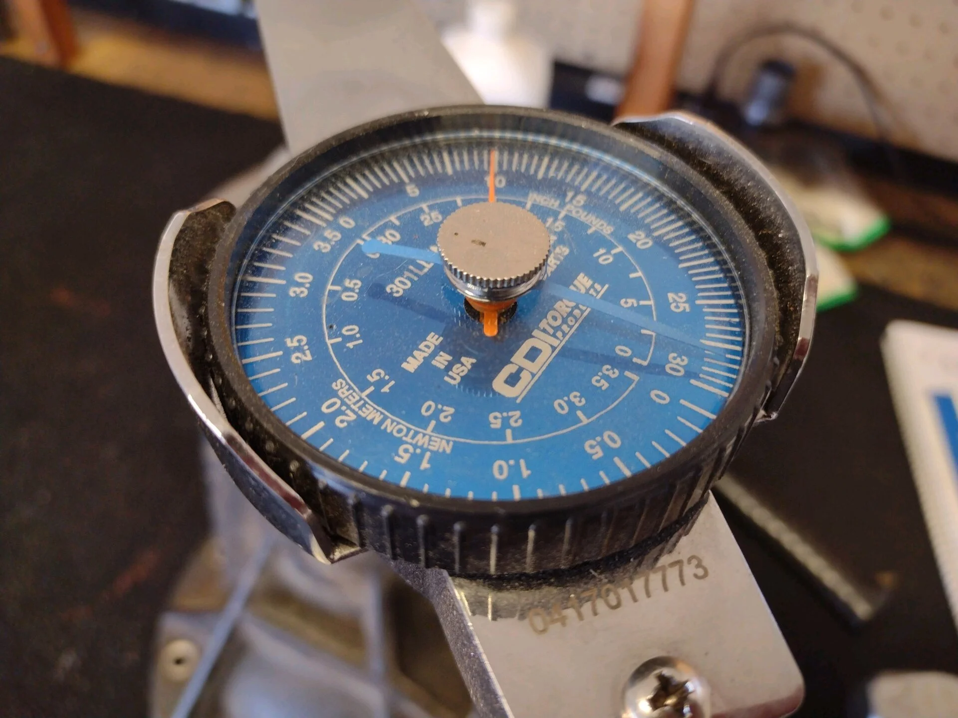

A smooth 10 in pounds here

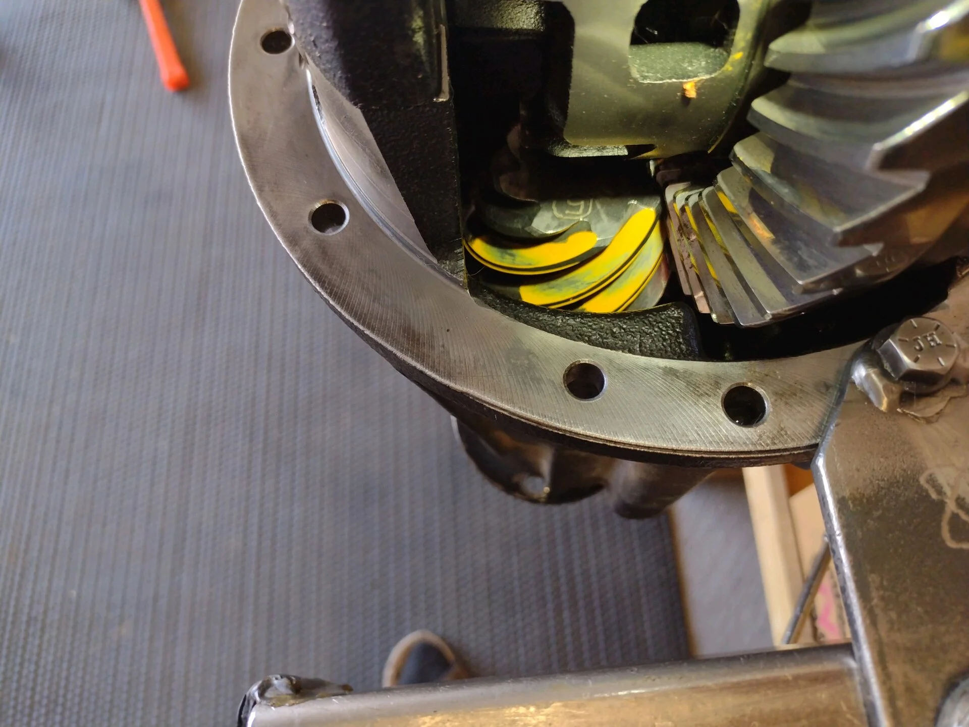

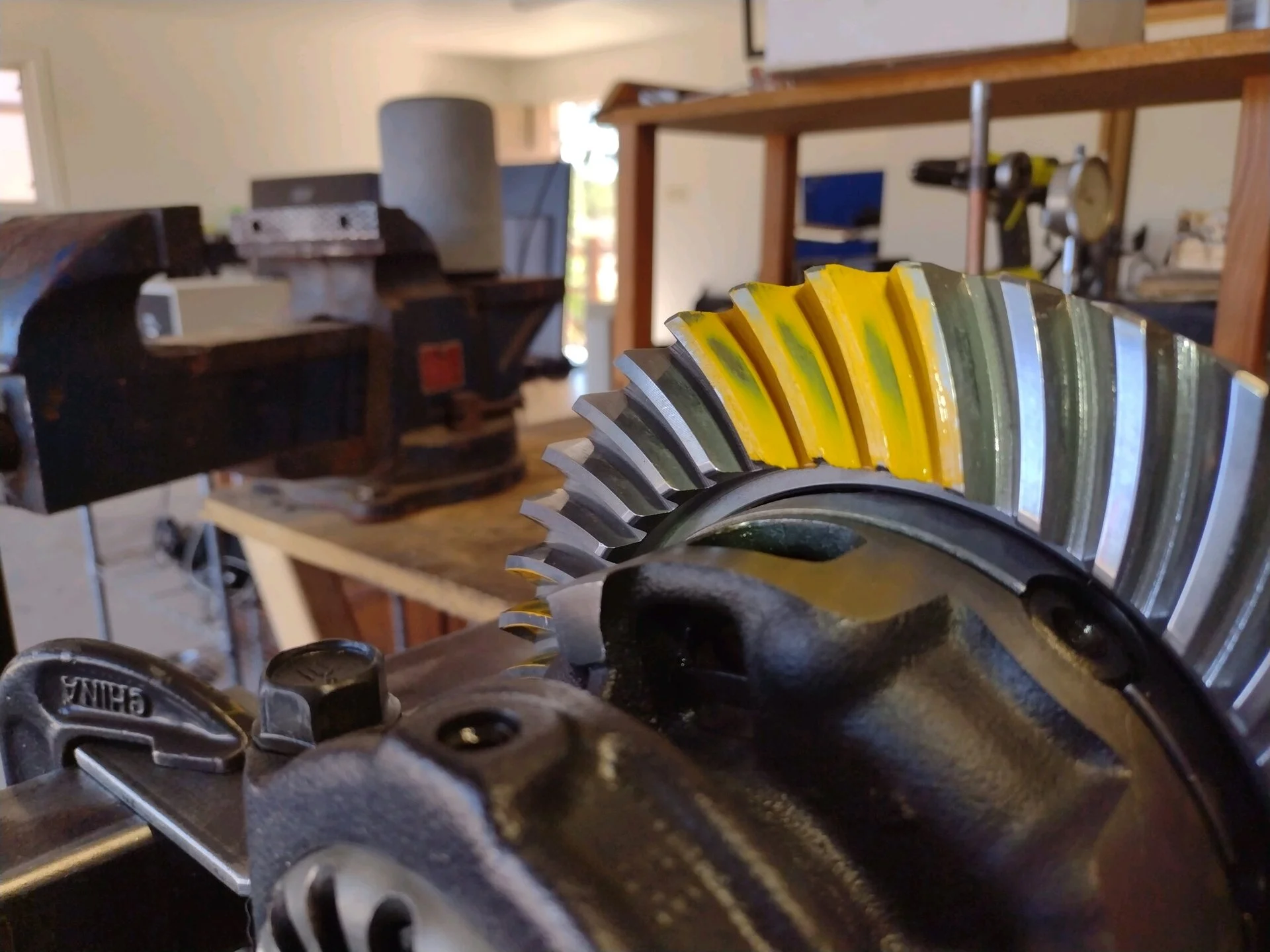

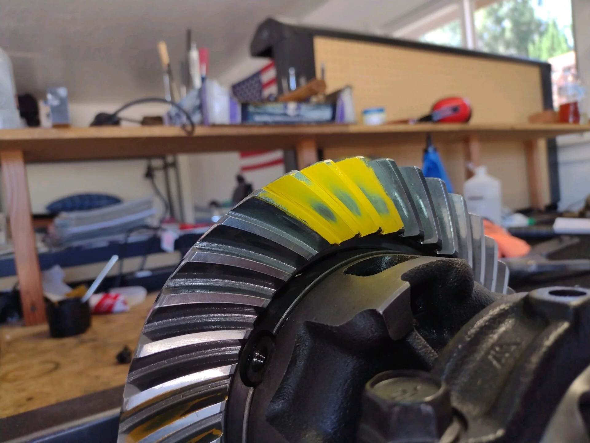

Drive side... The . 001 less shim is quite noticeable, better balance from the root of the tooth to the top of the tooth
Coastside wow the improvement is so much better... two of the three teeth look perfect

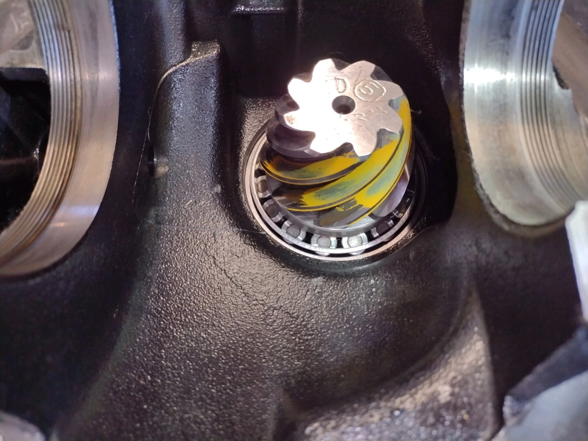

Pinion tooth..... Look at the difference between the length of the line on the root of the tooth in the length of the line on the outside edge they are well balanced, the load-bearing is in the center that's the final approval of a very nice pattern

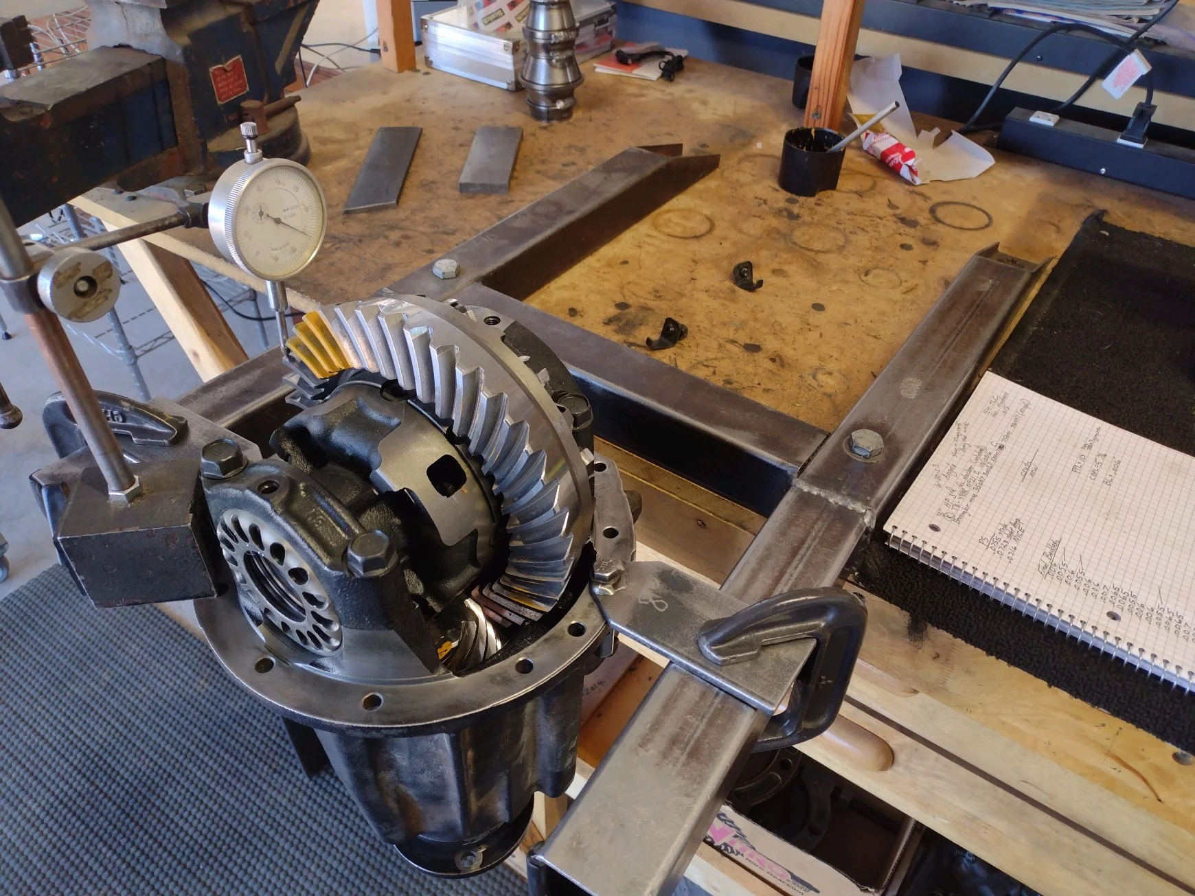

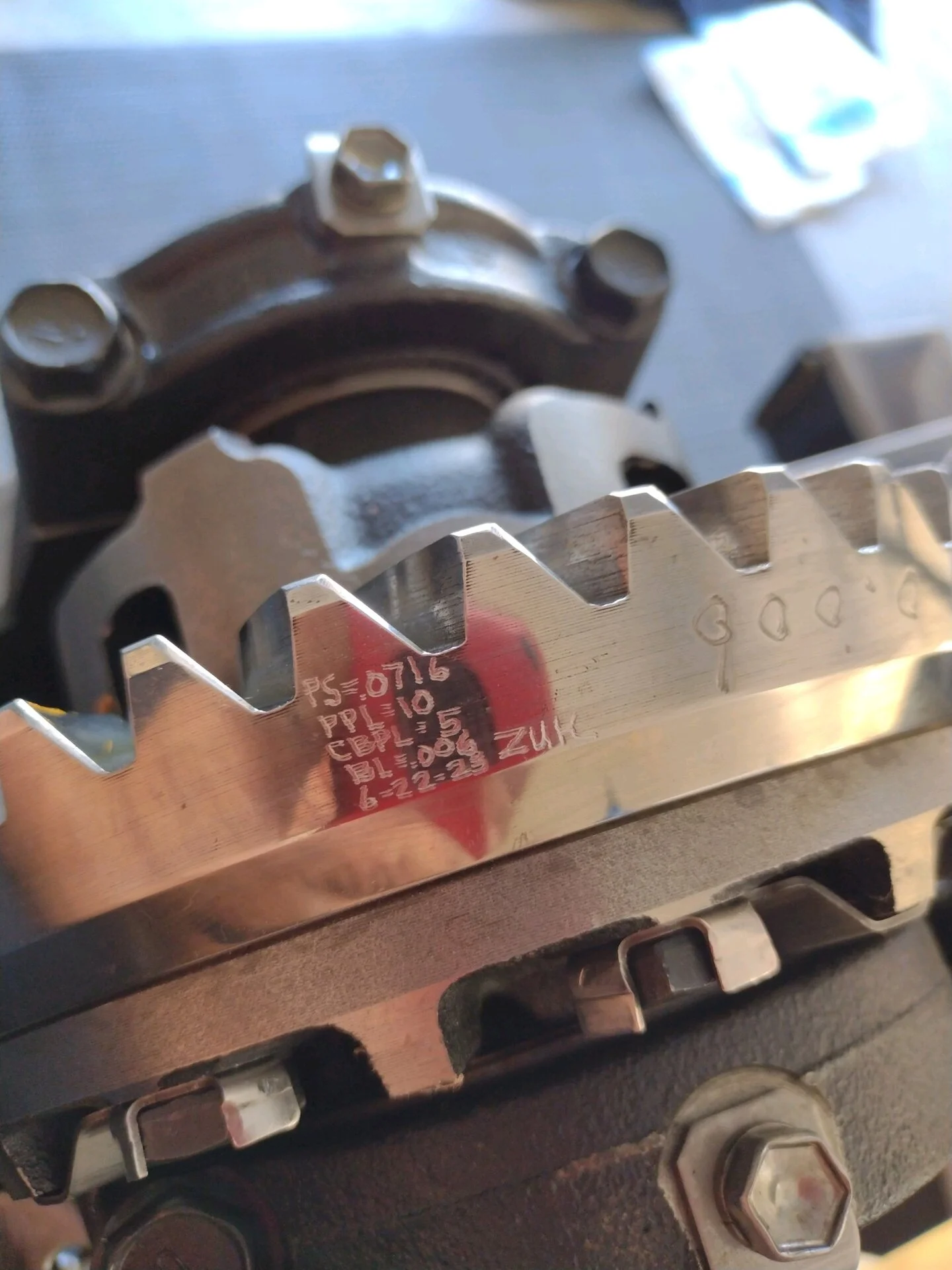

20 backlash recordings complete and all looks great.. bearing preloads are nice and firm as they should be
