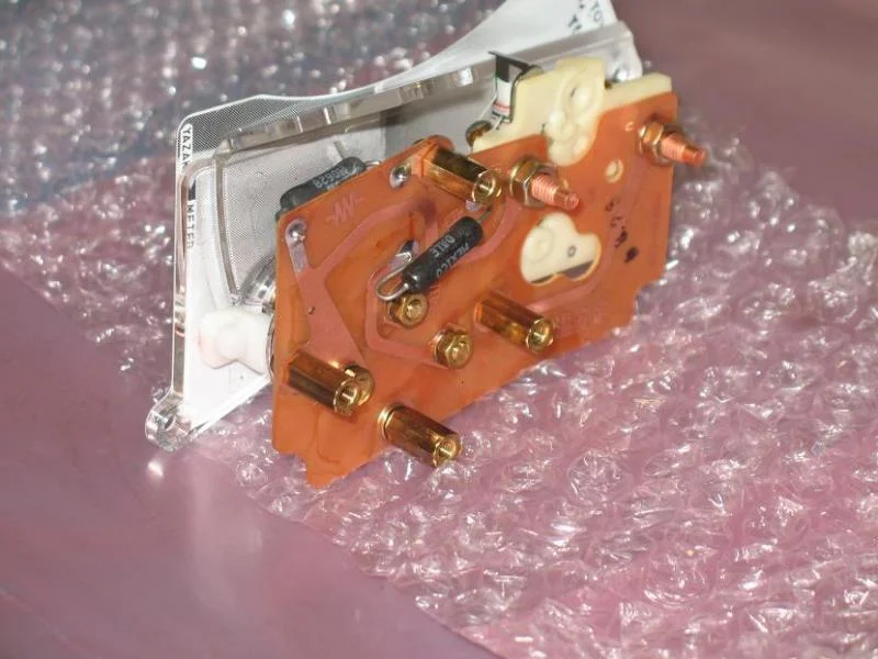

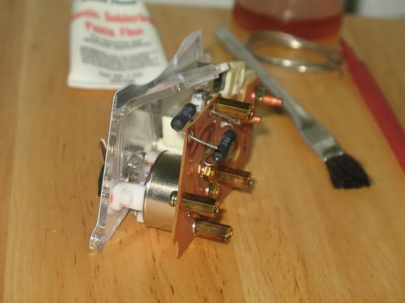

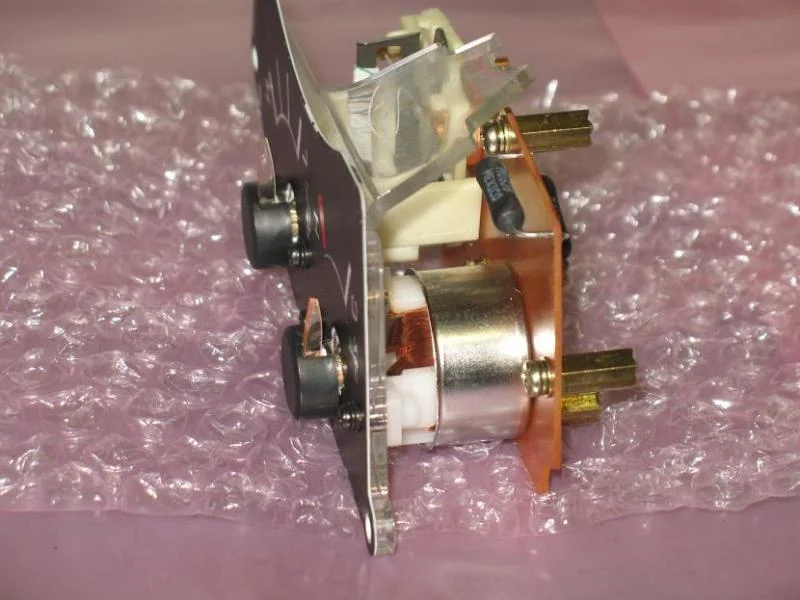

I took the instrument cluster back out for the second time and put in more solder/flux at the joints to make sure the connection is good. Then installed it back for test drive. After about 7 or 8 miles the temp guage needle just stayed at the cold mark and never even got to the middle part where it is usually stay with the OEM resistor/diode.
Mike (thanks mikedamageinc:beer:) came by and gave me a couple more resistors (110 and 50 ohms). I removed the instrument cluster for the third time (I'm getting good at it now) to take the temp guage out. This time I decided to take it to work and let the Navy aviation electronic technicians who work on Micro-Miniature (2M) to do the soldering for me since their workshop has a controlled temperature and they got some hi-tech soldering equipment with electro-static discharge wristband. The technician did an outstanding job in desoldering, cleaning, and re-soldering the resistors to the board. Using a Fluke meter, we checked the same resistors that was previously installed and they were good showing a 110 ohms and 50 ohms reading in the digital fluke meter. So I decided to use the same resistors.
Went back home, installed the temp guage back to the cluster and then installed it to the truck. Crank it back up and went for a test drive. Lo and behold, the needle started to rise just above the cold mark and after about 8 miles or so, the needle stayed below the middle part. After driving for about 16 miles the needle goes slightly above the middle part, and this happen when I was on a stoplight with an outside temperature of 48*F. So everything went well and the temp gauge is now working great!
We will see what it does in summer. Lessons learned on my issues were:
1. Soldering iron is not hot enough.
2. Garage room temperature is 55* where the solder quickly gets cold.
3. Too much paste flux is not good.
4. Always disconnect the negative battery cable when working on electrical/electronic equipment.
Thanks to Raventai for an outstanding R&D temp guage mod:cheers::beer:. an Thanks mucho to Mike for the resistors:beer:

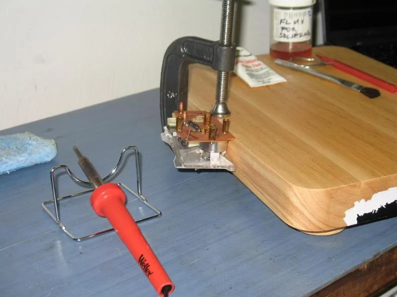

Post is useless without pictures, right? So here they are in numerical order.
1. resistors connection
2. soldering gear with :princess: new chopping board as clamping station

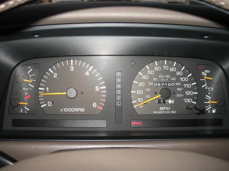

3. temp guage in cold mark after 8 miles of driving
4. 110 and 50 ohms resistors
5. smooth and shiny solders

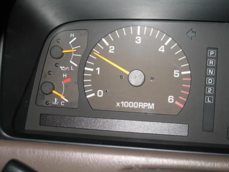

6. temp guage at just below the middle part

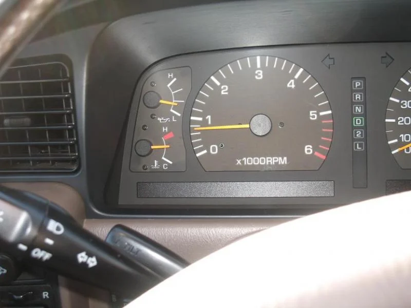

7. temp gauge needle at stoplight
next pictures on the list.
last pictures on the list. This picture taken while on the stoplight. Thanks RT.
Happy New Year to all!
