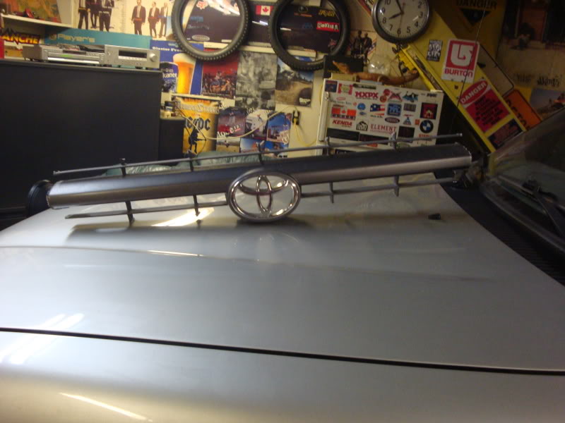

Gave the tacoma some lovin and did a stupid little grille mod Ive been thinking about. I had most of the parts and picked up some mesh the other day so I had no excuses. Turned out okay I guess, could have sanded a little more but meh.
D
D,
So you had the sombrero emblem in the grille as a previous repair and put the mesh with Toyota in instead of it?
That mesh looks good and probably holds up better to pushing brush.
The sombrero came on the stock grille from the factory (98-2000 4x4 tacoma), you can see it in the first post of this thread. I cut out the big middle bar and the two smaller bars above and below it and bent up the mesh to fit in from behind. After cutting I was left with 3 big holes that looked like ass (one on each side and one where the sombrero was) so I used the plasma to cut out some steel pcs., bent them up and tacked studs to the back side. They cover the holes and help hold the grille insert in place. Its the lazy mans "satoshi" grille mod since I didnt feel like fing around with fiberglass. The emblem is from a 60 series that I repainted, the Toyota is silver to match the tacoma body.
D (shhhhhhhh, secretly testing on the tac before cutting the 80 grille lol)
OK, now I understand. As usual, you've got things whipped together and looking good faster than I can pay attention:lol:
