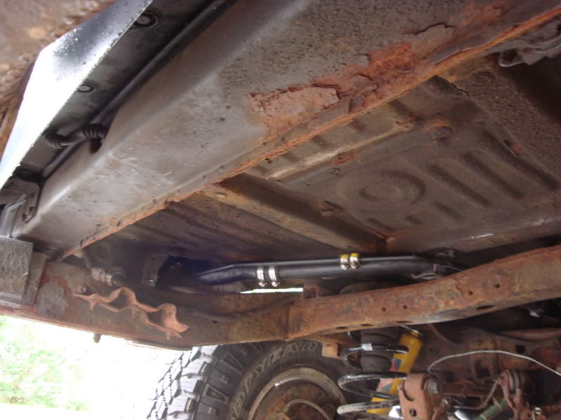

The new tank/filler.
In the pic above you can see the cuts that had to be made to the filler/vent pipes.

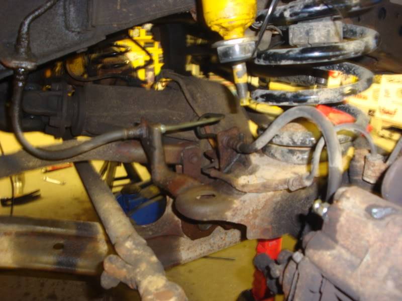

I finally bit the bullet and did the hard brake lines.
Drivers side hard line on the r axle was done this summer so we just routed it a little better. We put in a new line on the ps, a new lspv/bracket, new hard line from lspv to flex line, and a new flex line. Changed both hard lines on the ds frame rail from the lspv to the abs "junction" under the battery tray.
In the front we changed the hard line from the abs deal to the ds flex line, the flex line, and the hard line on the axle. On the ps we did the hard line on the axle. Both of the lines on the axle were beyond rusted.
All four flex lines at the calipers looked good so we left them.
The lspv was a pain in the ass and in the end I cut it out leaving half the bracket in place, cut the new bracket to fit , and bolted what was left of the old bracket to the new one. Better than messing w the rusted to all hell bolts beside the gas tank. Not sure if we set it up right but the brakes work good....
Also managed to break a bleeder on the ps caliper. Instead of drilling and whatnot we called the parts place and by some miracle they had an 80 ps caliper in stock!!
D
Some pics of the brake job.
New LSPV
Old hunk of rust
The mess

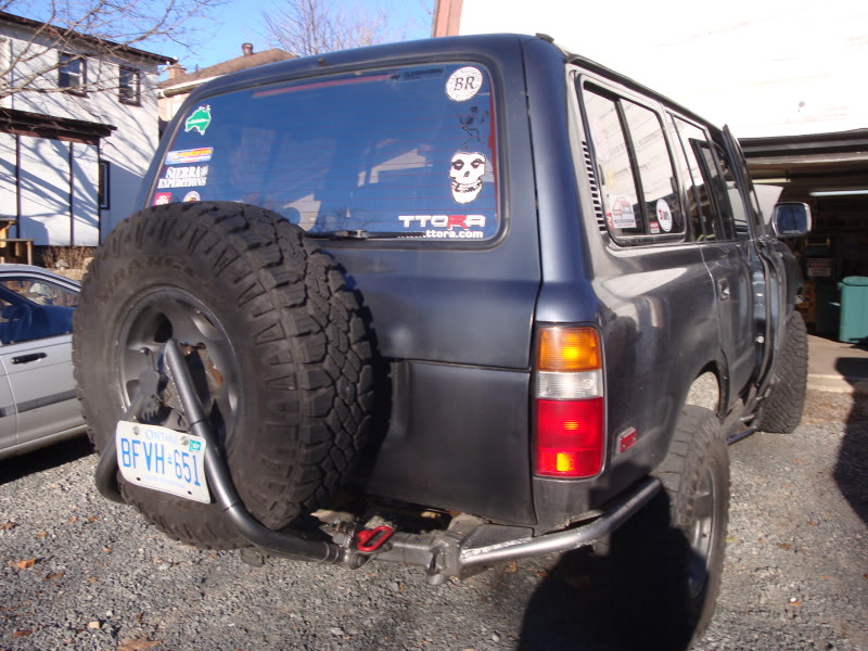

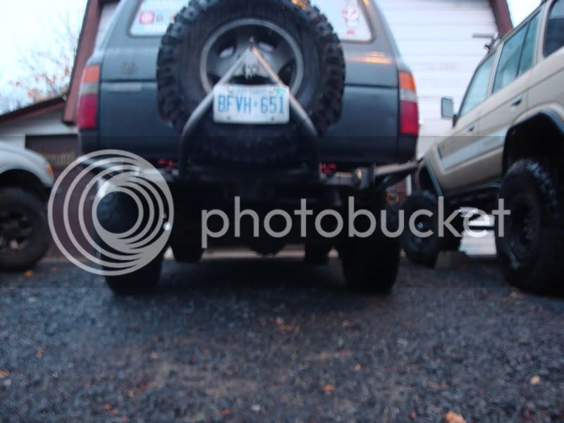

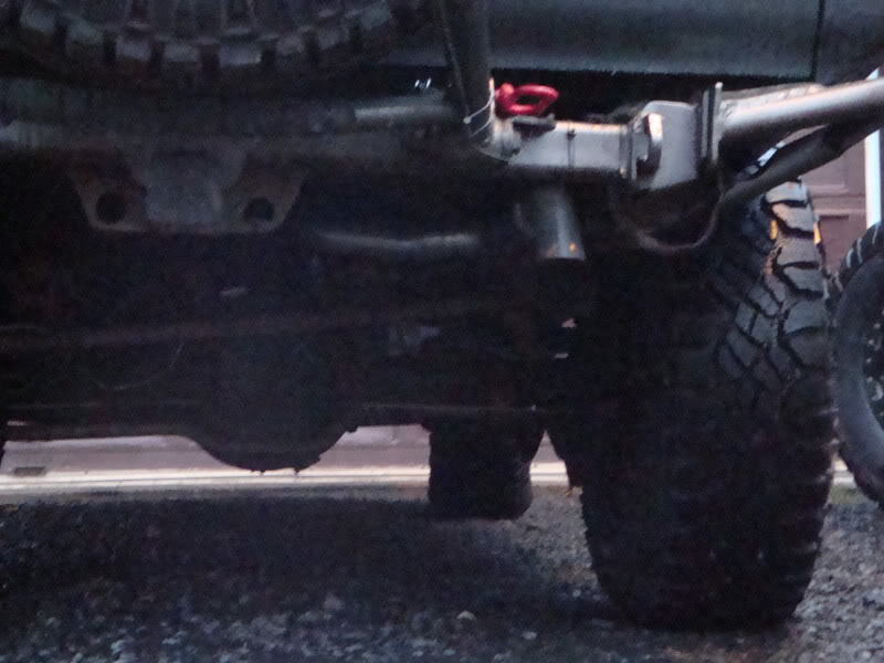

The beater got a new welfare exhaust this past week. Nothing special just a y pipe where the cats are supposed to be, new no name muffler, and a re routed tail pipe (along the ps inner frame rail dumping at the r bumper). 2 1/4 inch tubing throughout.
Sounds ok at best but at least theres no more rattles so thats kind of cool. Ive also convinced myself the van has more nuts now but its probably not true. Looks good without the cut down oe tail pipe sticking down below the frame. Id post pics but its slushing outside right now.
D
I might cut the tip up a little higher at some point...
Sorry for the crappy rain pics.

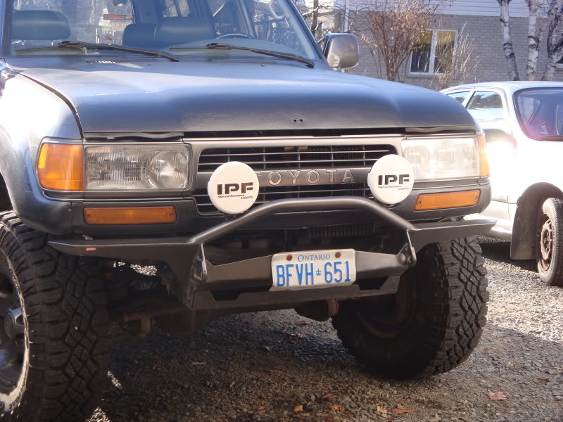

Well, gave er s*** and managed to get a couple things done.
New windshield.
Matching spare,
De chromed the grille a little more.

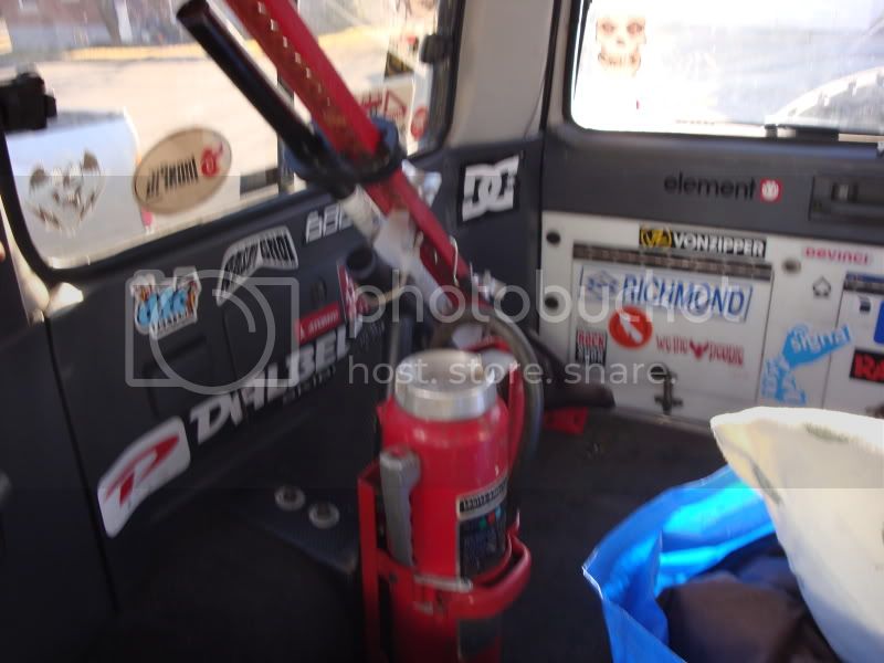

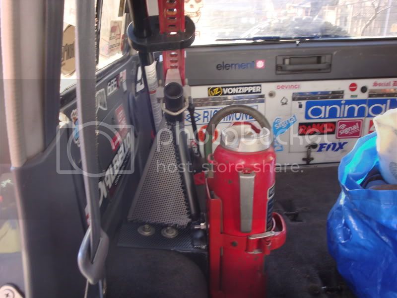

Got tired of the fire extinguisher rolling around in the back so I bitched up a little holder that also fits the hilift from the put away for the winter 60.
I also touched up the hood, rear fender, and pass side rocker.

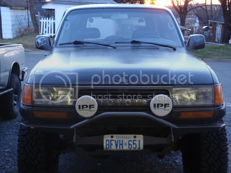

Sprayed the hood today then threw on a coat of clear.
Turned out ok.
