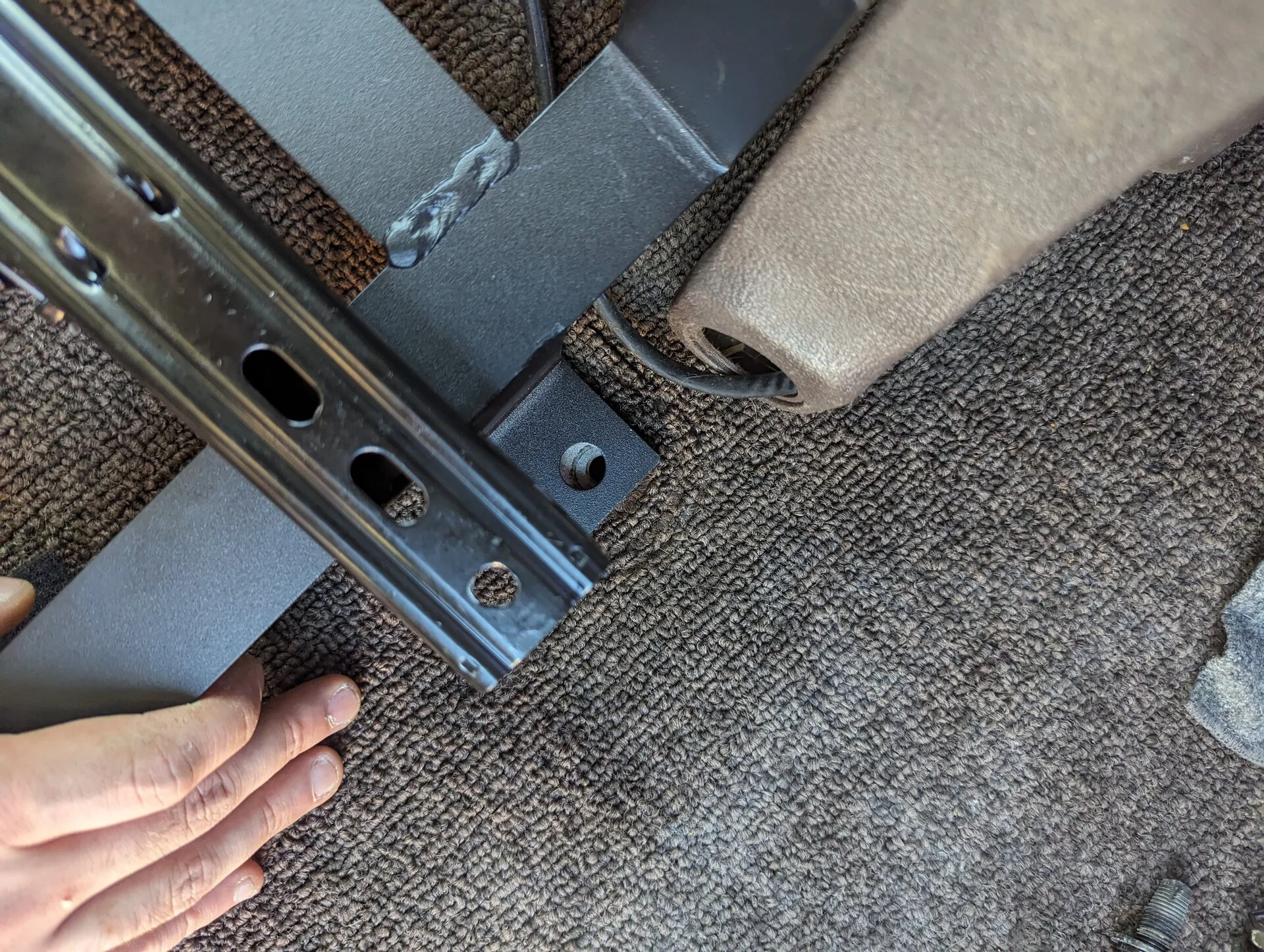

#1 The Brackets they provided are not quite 100% drop in fit and needed some encouragement with a pry bar on the driver side to line up enough to get the bolts started.
Also I noticed that trimming away the carpet for the front feet helped quite a bit.

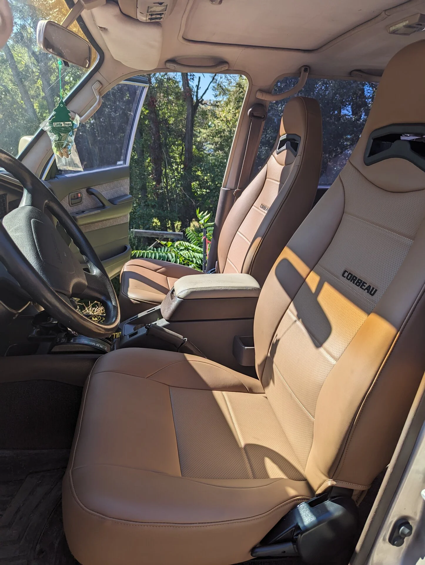

#5 Corbeaus Tan is the closest color match to the Toyota Brown/Sable. They look almost coffee/caramel. Imo they look pretty good.

Example of the tolerances I was dealing with.

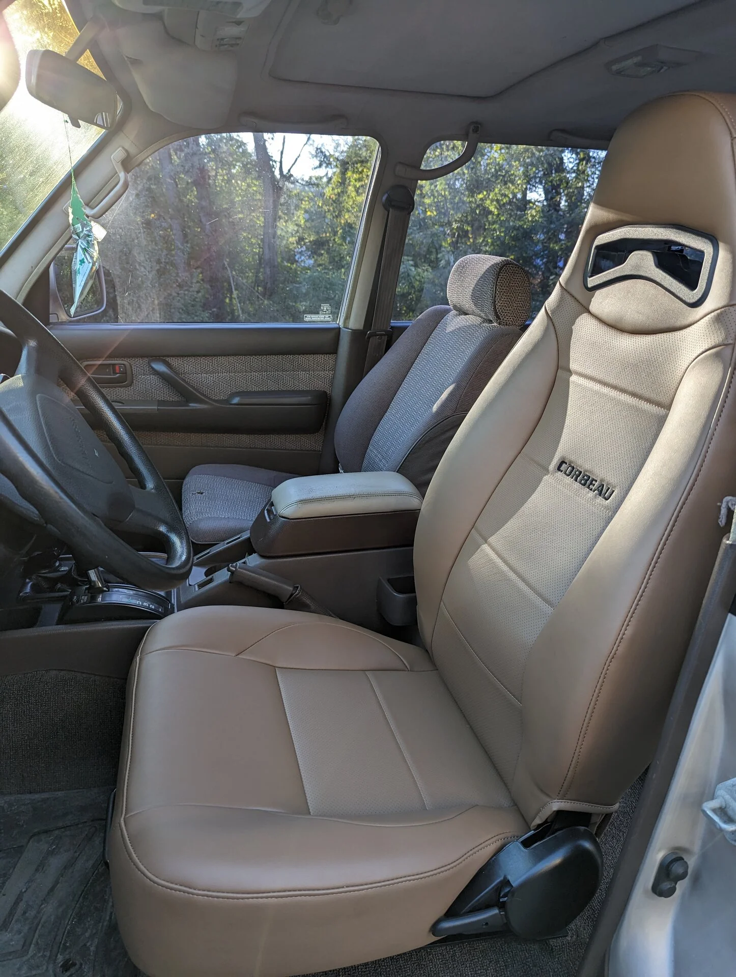

Compare and contrast.
This picture imo shows off the In person color a bit better than my previous photo.
Nice work and thanks for the pics
One question - it looks like the seats sit quite a bit higher - is this correct? And do you feel a difference when driving?
Honestly the bottom cushion feels pretty darn close to same basic position as the stock seats. Maybe a teeny bit higher? On second look at my pic it may just be the bolstering that sits a little proud. But the Corbeau's bottoms seem a teeny bit larger.
By far the biggest difference is the back support as the Moabs are MUCH taller. The seat sliders also seem to go backwards further for more legroom. I'm pretty short so not a big deal for me but I'd imagine it would be nice for taller guys. My dad is taller and said it was a big improvement especially with the Lumbar bladder in the Driver side.
Regarding the ride feel. I haven't had a chance to take it on any longer drives, but they do feel different. My stock cloth seats had a bit of bounce to them, whereas the Corbeaus are stiffer. I imagine they'll loosen up with time though. Honestly I'm just glad my butt no longer favors/leans towards the door anymore due to the blown out cushion of my old seat.

Sure glad to help out! While labeled tan, they are really more of a caramel. The spice color is much closer to a lighter tan color from the pics I've seen and is a closer match to the stock leather. My interior was the darker brown (sable) color so my seats actually work pretty well. After driving with them for a bit, totally worth it.

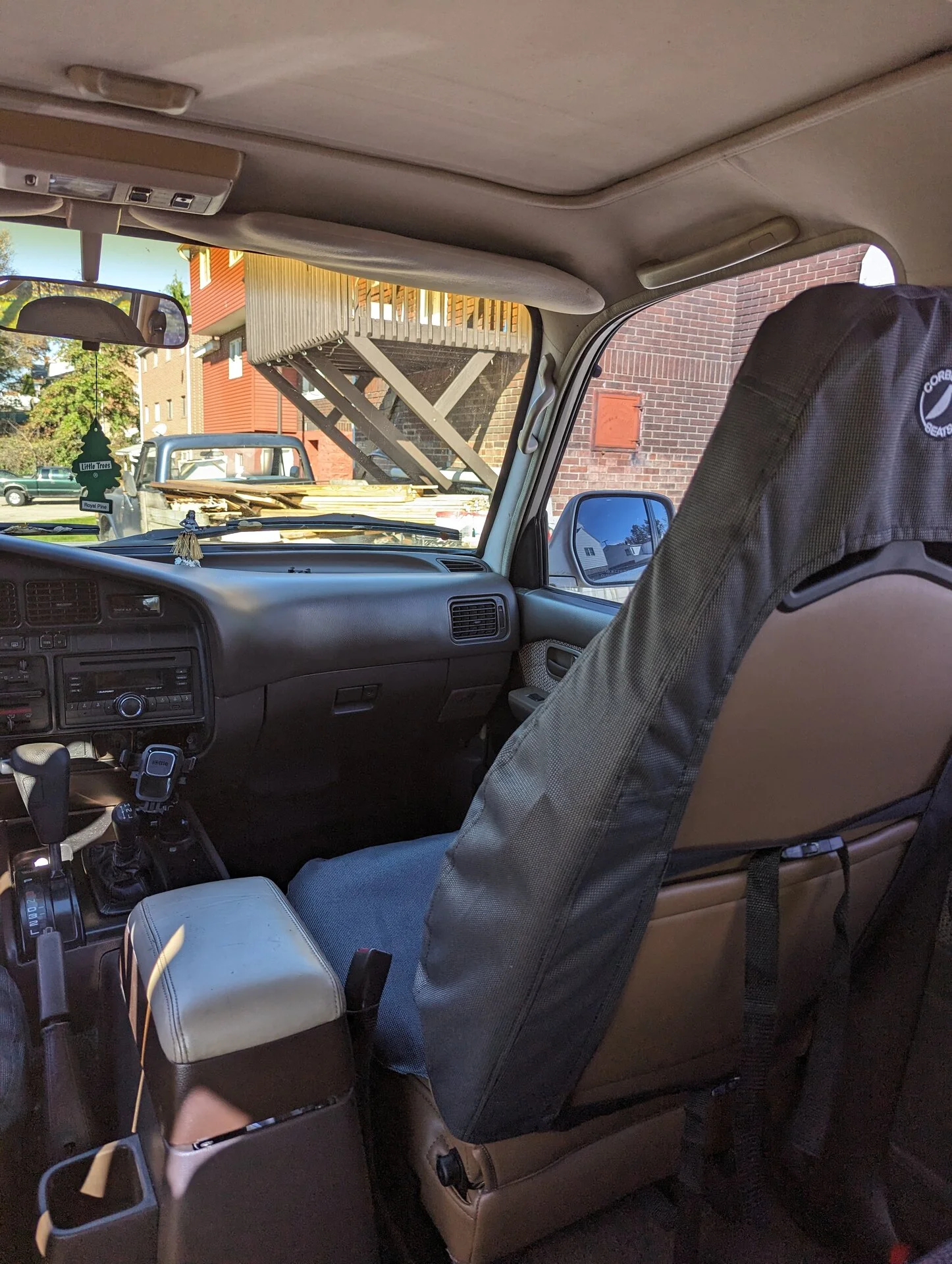

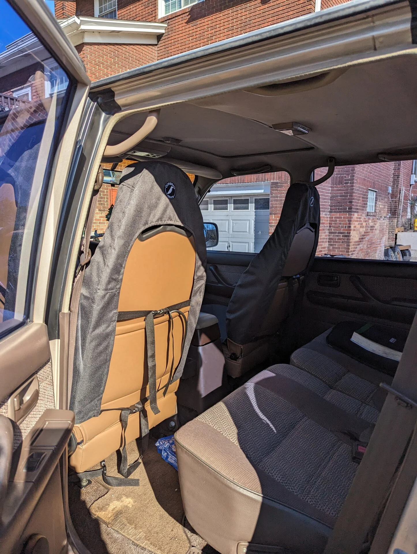

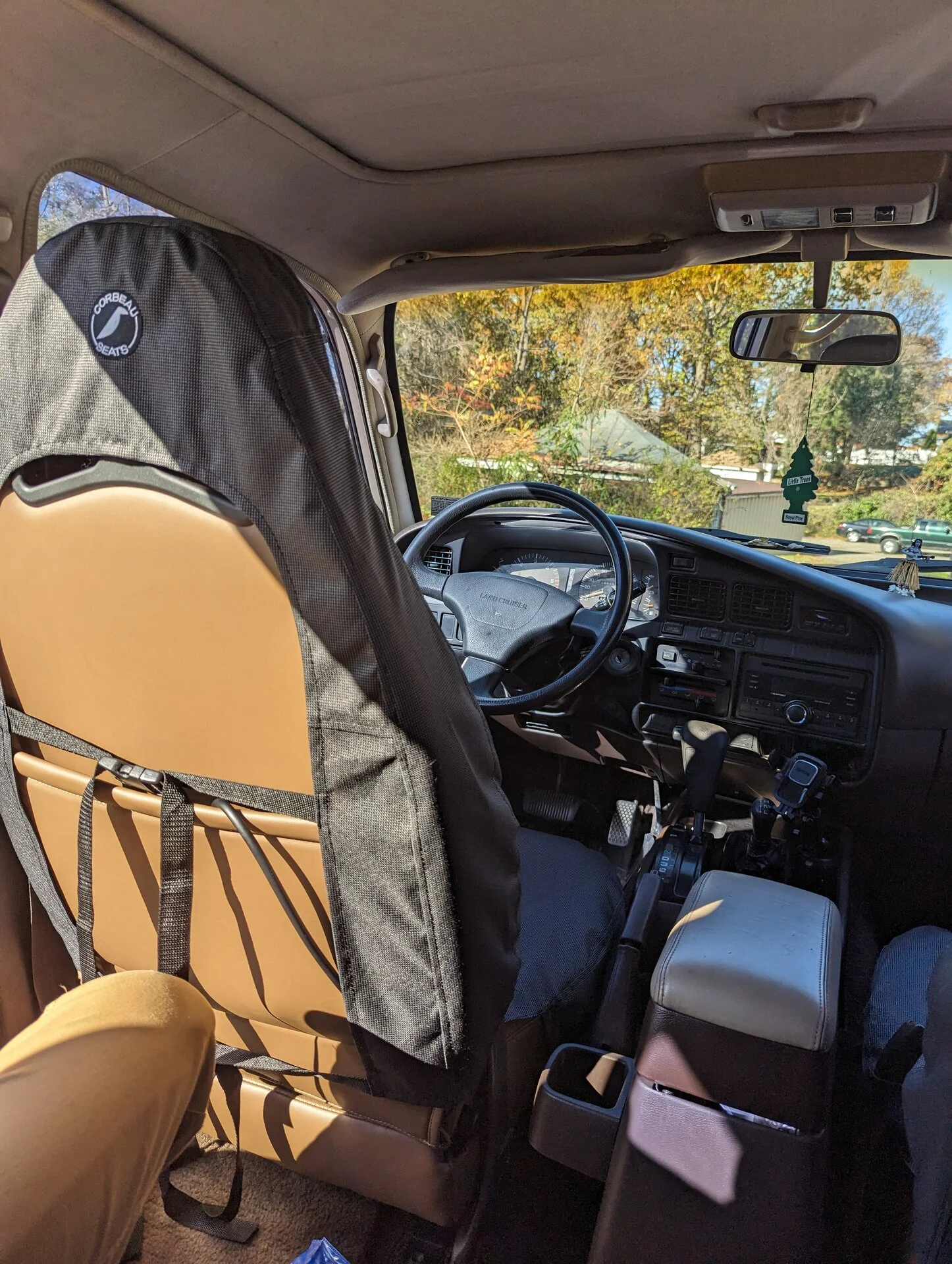

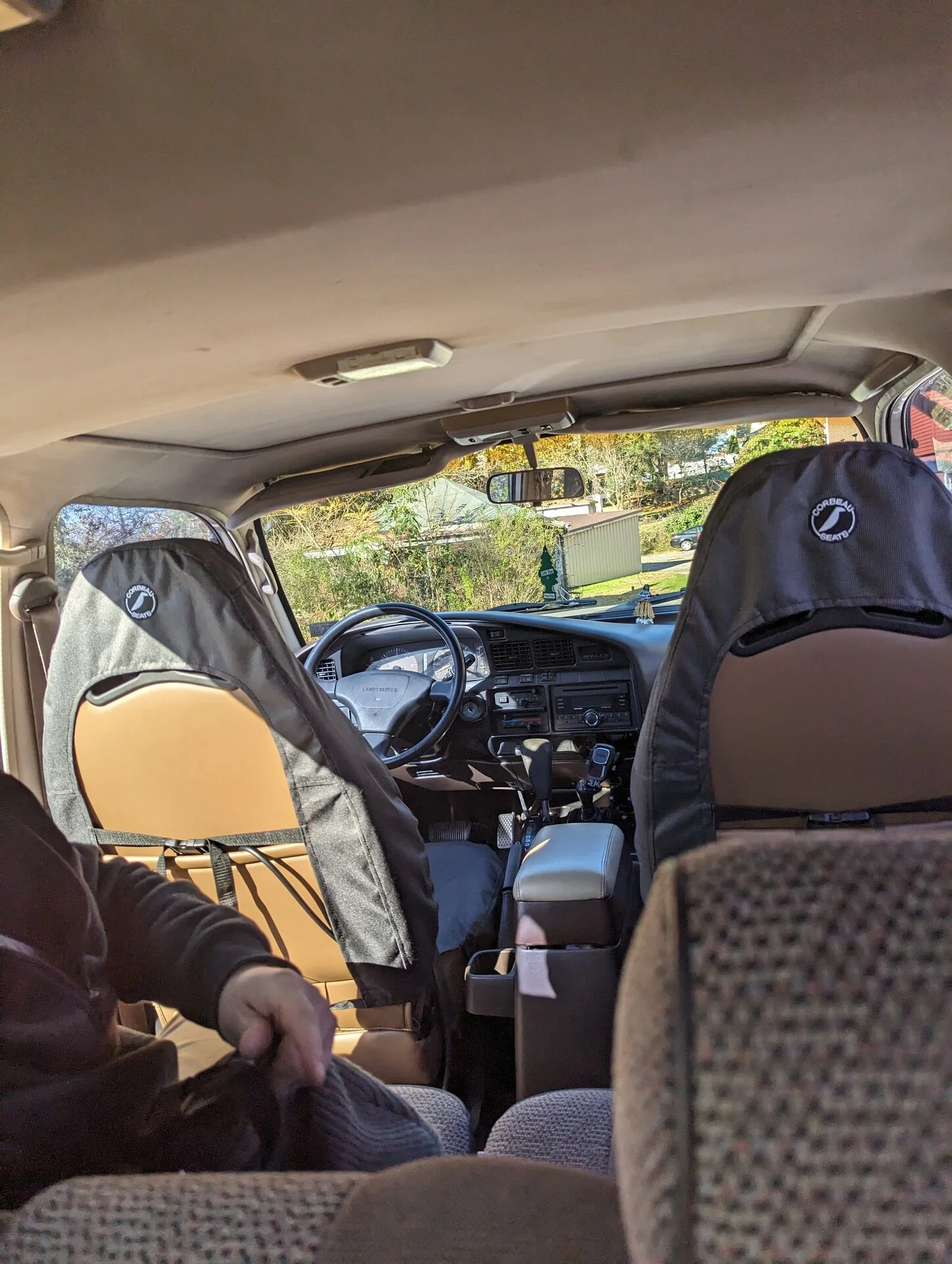

How do they look from the backseat or even from the back window/behind the truck? They look great, just a bit tall.
I will get you a picture next opportunity. They are indeed much taller than the stock seats.
