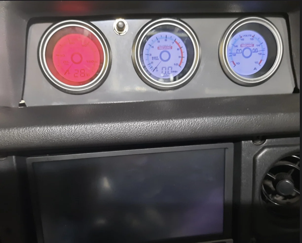

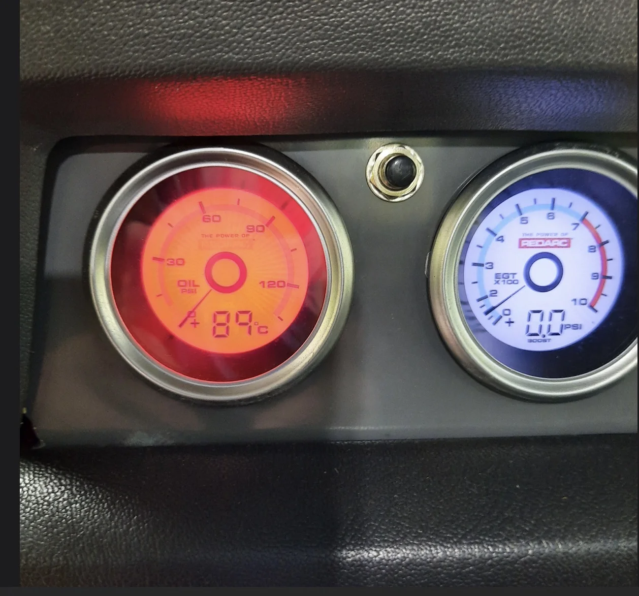

They are a tad pricey but Red Arc offers “multi-functional” gauges. I run an oil pressure / water temp combination.
The gauges also have programmable “alert features”. In this case the gauge turns red when it senses low pressure or high water temp.

Sorry, I didn’t see your question until today. As you can see the gauges don’t photograph worth a darn due to glare.
All gauges are mounted in a dash top pod. (Oil pressure & water temp / boost and EGT / dual battery indication).
I’ve got the adapter to add amperage to the dual battery gauge but haven’t gotten around to installing it yet.

All gauges are mounted in a dash top pod. (Oil pressure & water temp / boost and EGT / dual battery indication). View attachment 3096710

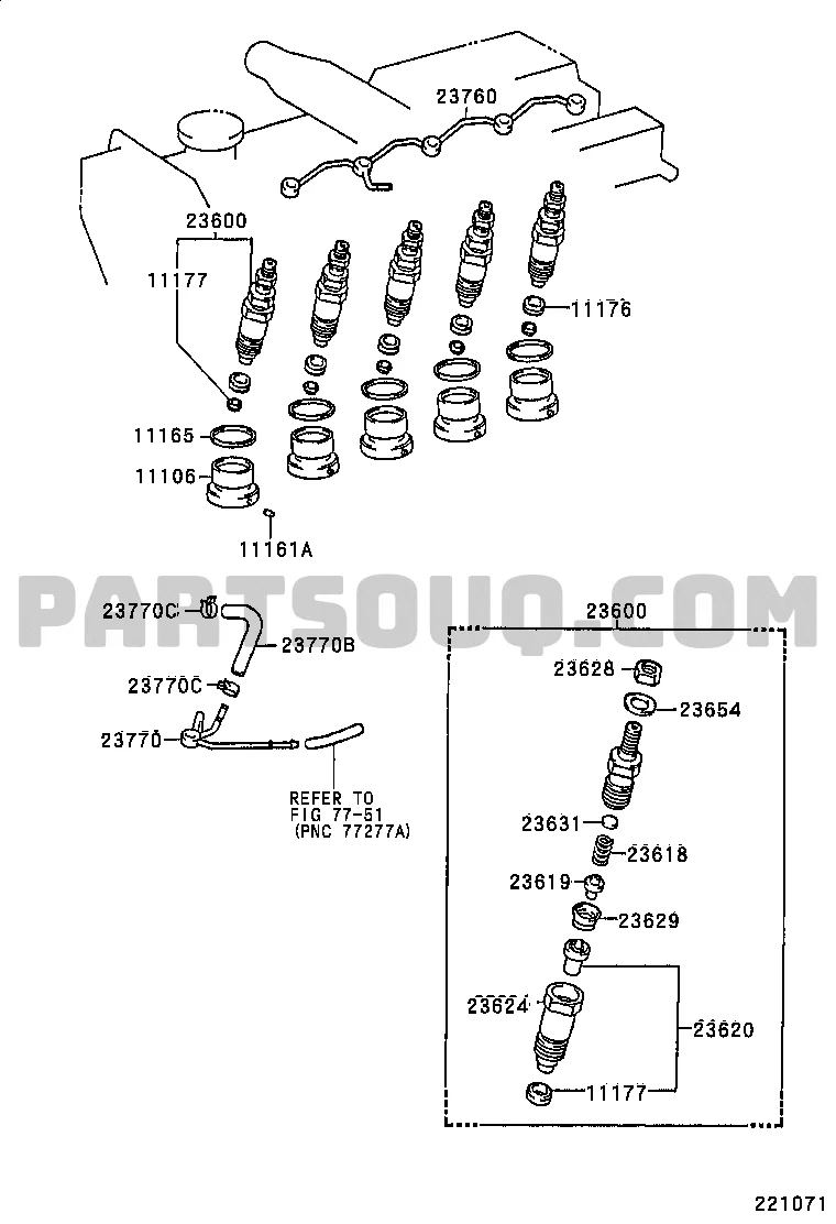

I replaced my fuel injectors yesterday. I ended up buying some rebuilt ones from Australia instead of sending mine off to be rebuilt. Cost just over $200 and a few hours of time. This was probably my most ambitious DIY car project so far, and I've got to say it was a giant relief when everything fired up perfectly!
For reference, I replaced my old 1PZ injectors with part number 23600-64050 even though my manual calls for 23600-19015. I looked at all the information I could on different injector part numbers and couldn't find any meaningful difference between 23600-19015 and 23600-64050. I did find out that not all 1HZ injectors are good replacements for 1PZ injectors. Some 1HZ injectors use different denso nozzles with different opening pressures. Based on my experience with this swap, I believe any 1HZ injector that uses DN20PD32 nozzles should be plug and play. I found this website to be a useful reference:

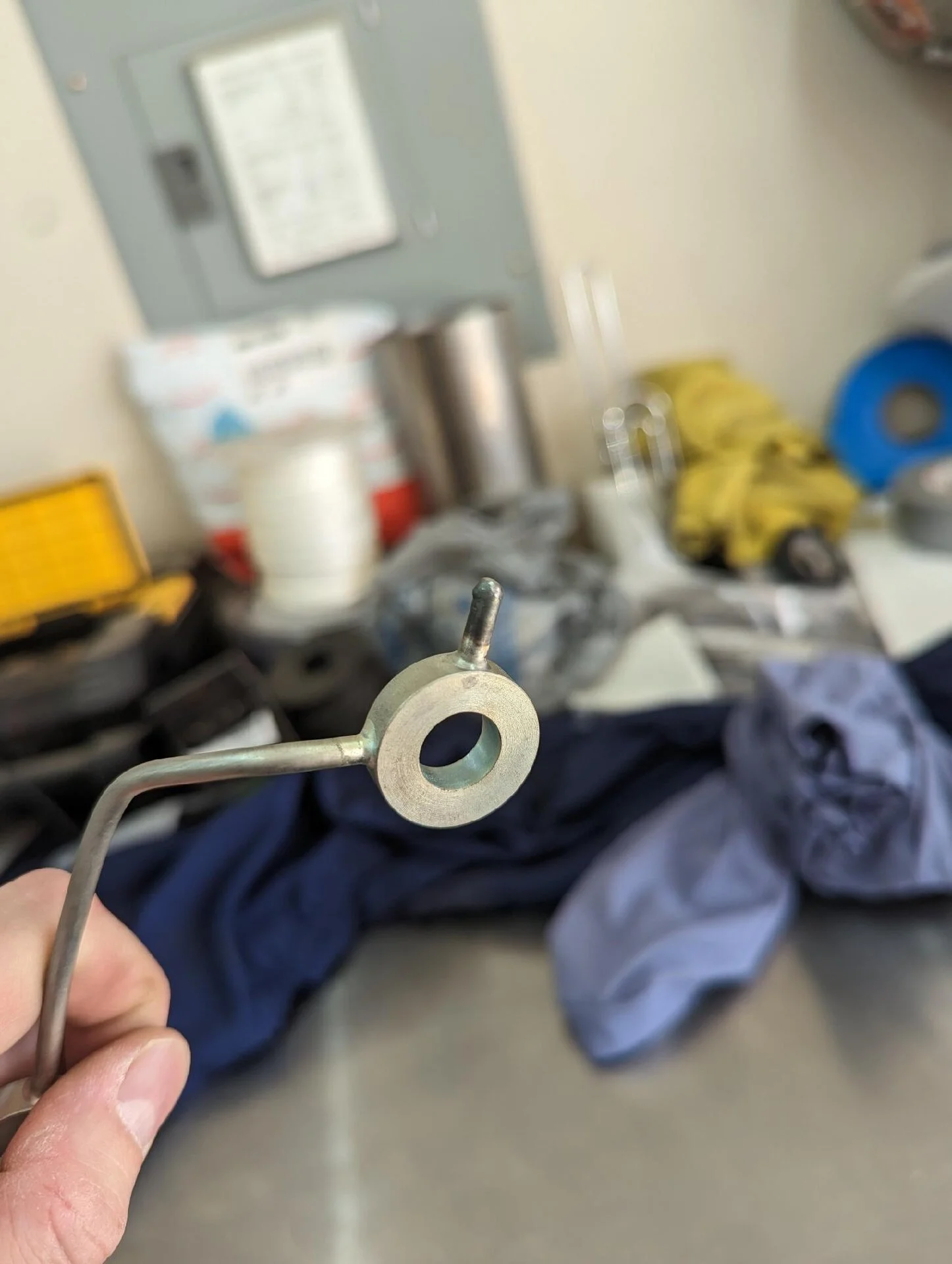

Well, I've seriosly screwed up. After installing the new injectors I kept getting air into my fuel lines, so I popped the hood. One of the injectors was not tight enough into the block and was leaking fuel (and I guess letting air in). I pulled the fuel line out and torqued on the nut holding the fuel return rail against the injector but since the injector was loose in the block, it just spun the whole assembly and snapped my fuel return rail...
They no longer manufacture 1PZ fuel return rails... I'm so frustrated right now, and I'm at a bit of a loss. Could I potentially order a 1hz rail, cut the last 1/6th of it off, solder it shut and be fine? Is there a way to DIY a return rail? Can I take it to a manufacturing shop and have them re-attach the rail to the sheared-off connection? Do I get in touch with one of the parts gurus in Japan?

Well, I replaced the fuel return rail of the 1PZ. I ended up ordering a fuel return rail for a 1HZ, chopping the last 1/6th off, and having my friend weld a bead to the end to keep it all nice and leak free.
This part of the operation worked. For future reference, if anyone needs a new fuel return rail for a 1PZ, just do what I did and chop the last bit off.
