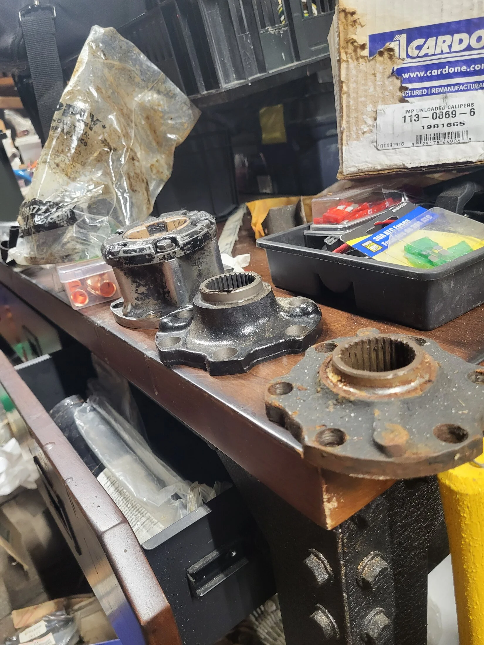

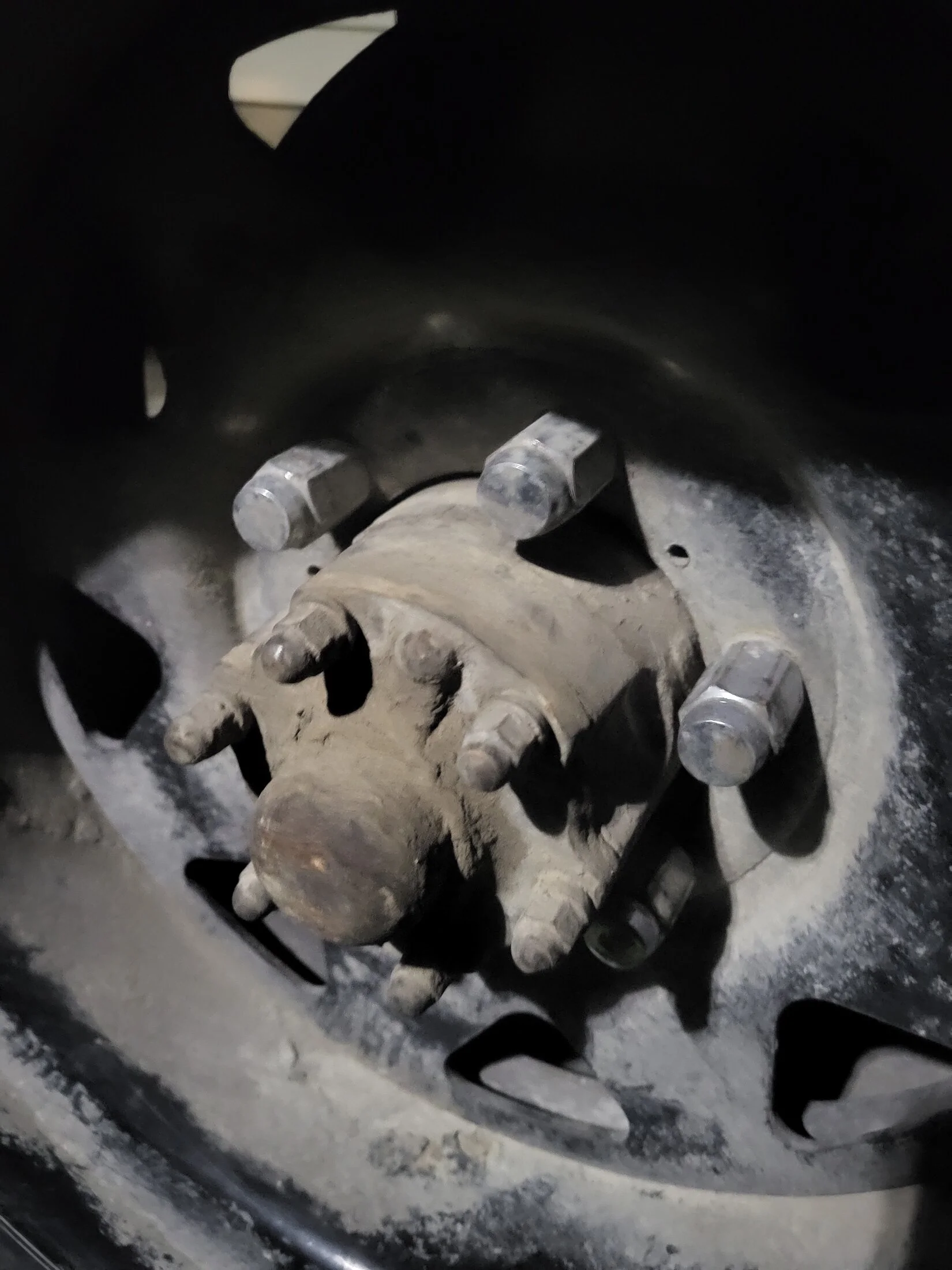

Stripped drive flanges up front maybe? I’m assuming you have the front driveshaft because you said no movement on either driveshaft.
Pull the caps, then observe as someone put her in high and gear, your CV is probably spinning because one of the two sides are stripped.
Note; The thickness of driveplates and length of CV...these should match and are interchangeable.
