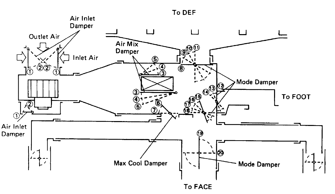

This is what the circuit looks like:
There are discharges to the front seat area. You'd have to loose some front passenger seat footroom in order to run a new duct to the rear. There's no room in the console, although there's a vent in the lower rear end, connected to the rear hear blower. However, as I said, there's no room to connect that duct to a duct in the front area, unless it was about 1/2-inch wide and and inch tall. And then you'd only feel it if you were on the floor, behind the console.

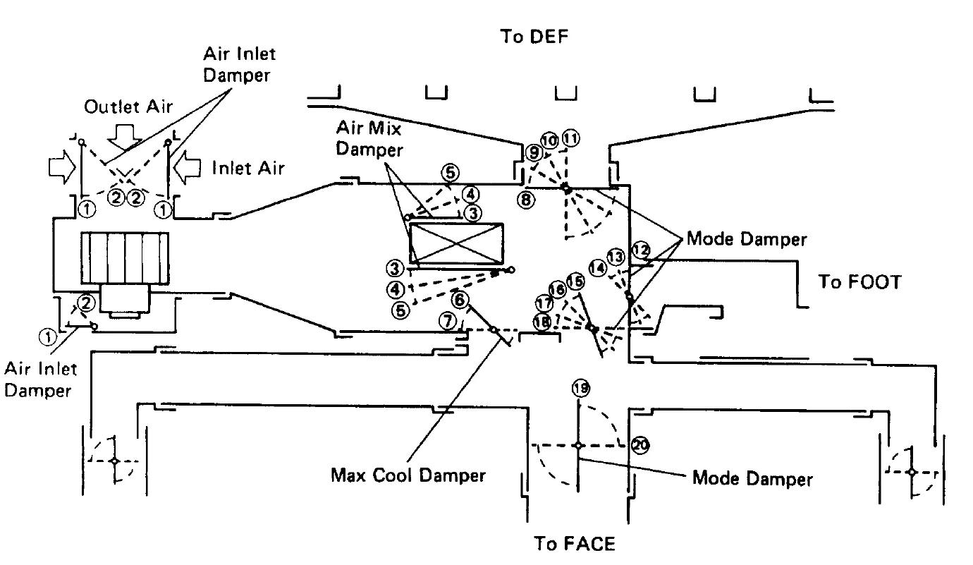

Thank you, man. I have the Delta console so maybe a little more room but I see your point.

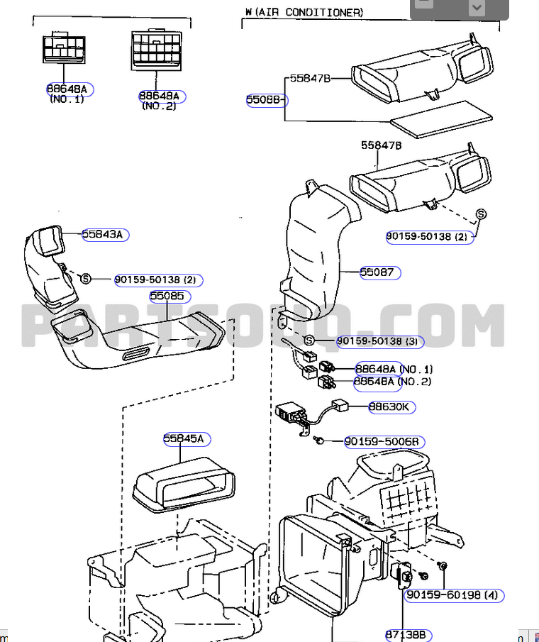

It could be done, there are a few ducts under the lower dash area...
Maybe you could open a new hole in the rear face of 55087...it's on the corner at the passenger side, near the console.
