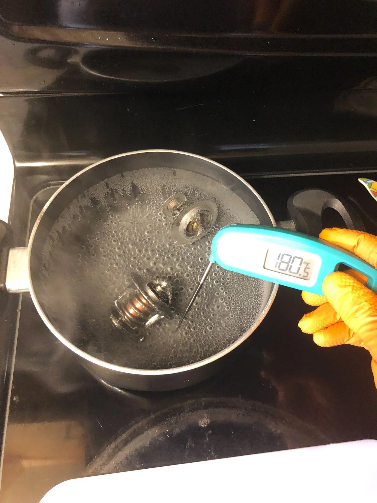

  • 3rzfe 82 deg tstat, ground to fit

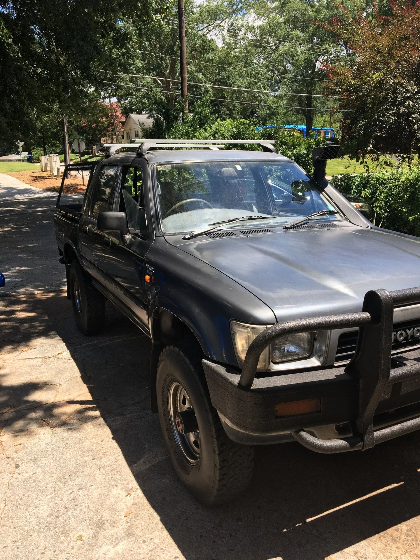

Some pics from the truck when I got it in Atlanta, and on the drive back with some cruiser folks in new mexico.

here you can see the tridon diameter is quite a bit larger than OEM
opens faster too

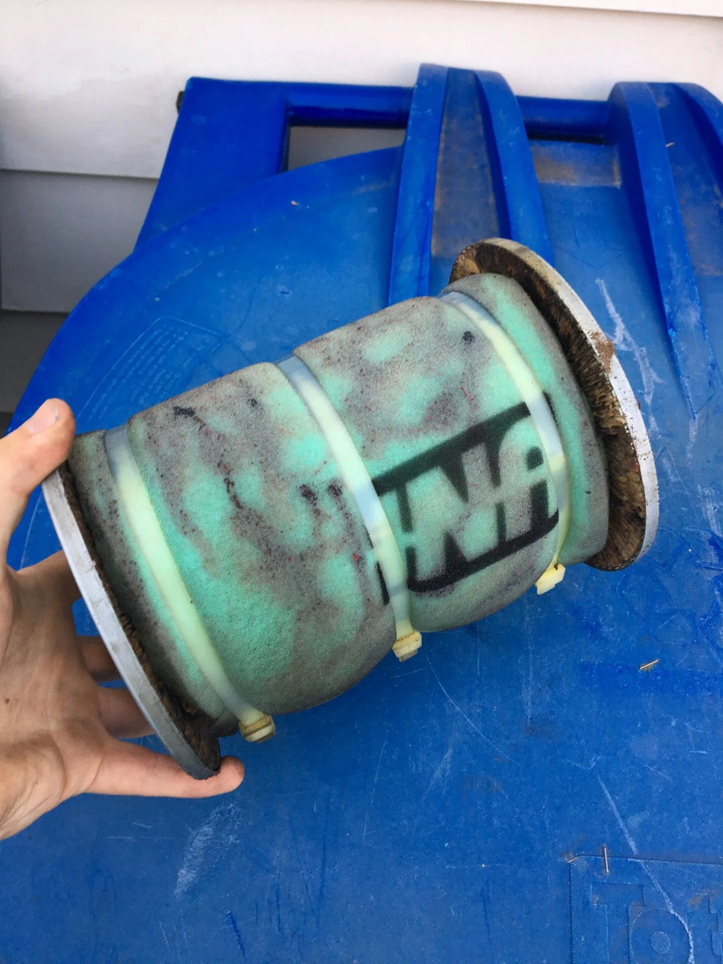

Not sure if this air filter made any difference but I switched it out for OEM.

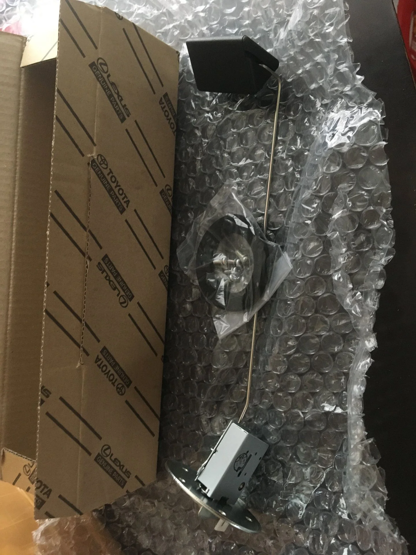

3 of the 4 auxiliary gauges didn't work reliably on the initial drive home - initially I went out and found all new dash components from a junked SR5 truck. This fixed the water temp, fixed the oil pressure only briefly, and did nothing for the fuel. I ended up ordering new OEM senders for oil, fuel, and water temp.

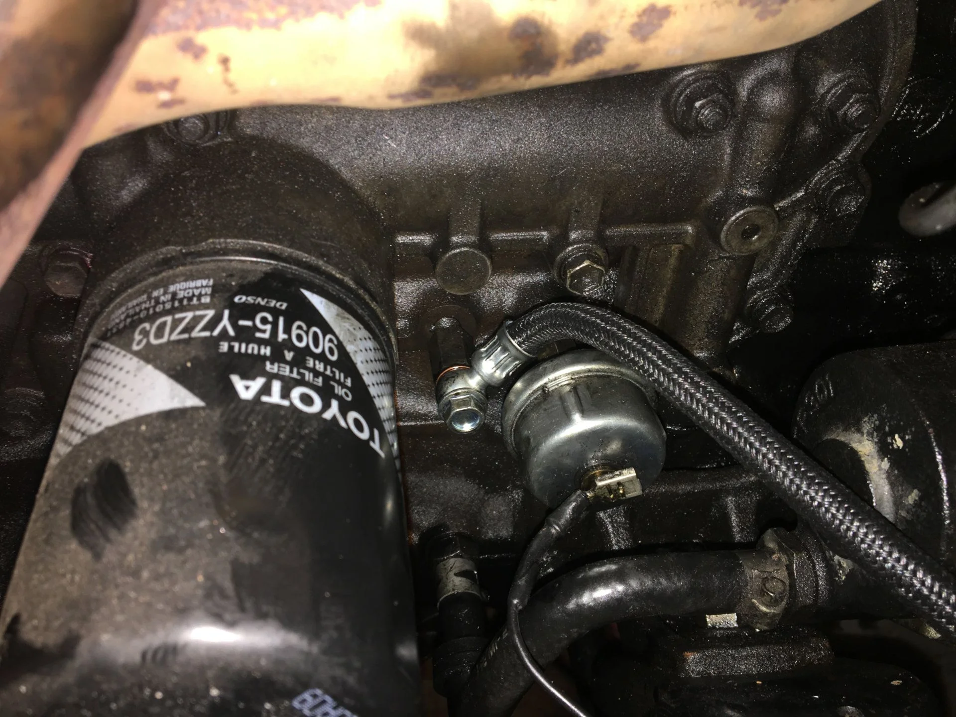

New sender, plus alternator oil feed hose and banjo fitting as well to address one of the many oil leaks (more on that later)

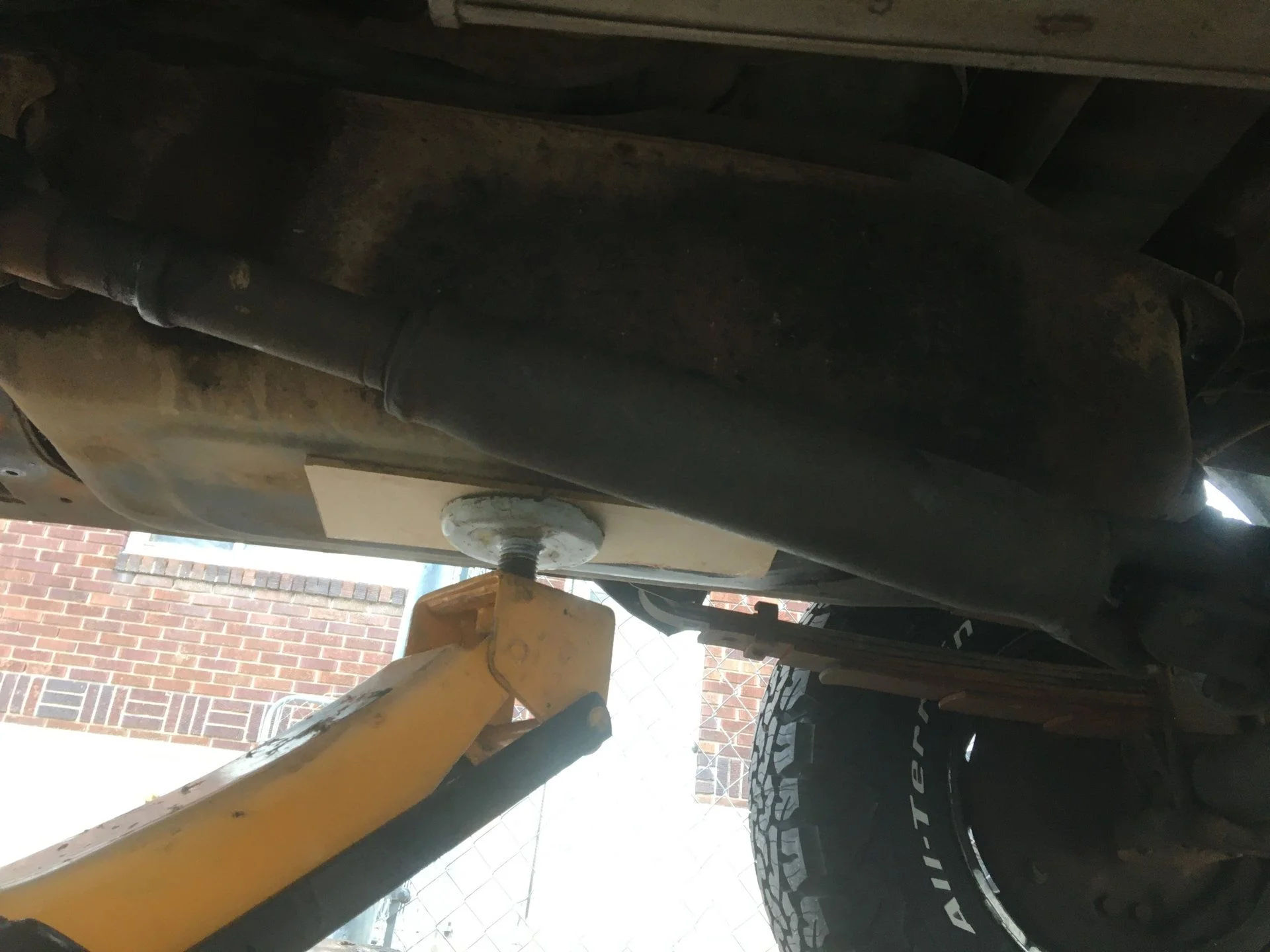

You can't pull the bed on the double cab trucks to get to the fuel tank like on the ext cabs, but good news is you hardly have to drop the tank to get at the screws:
This is as low as it needs to be, provided you can worm your way up in there:

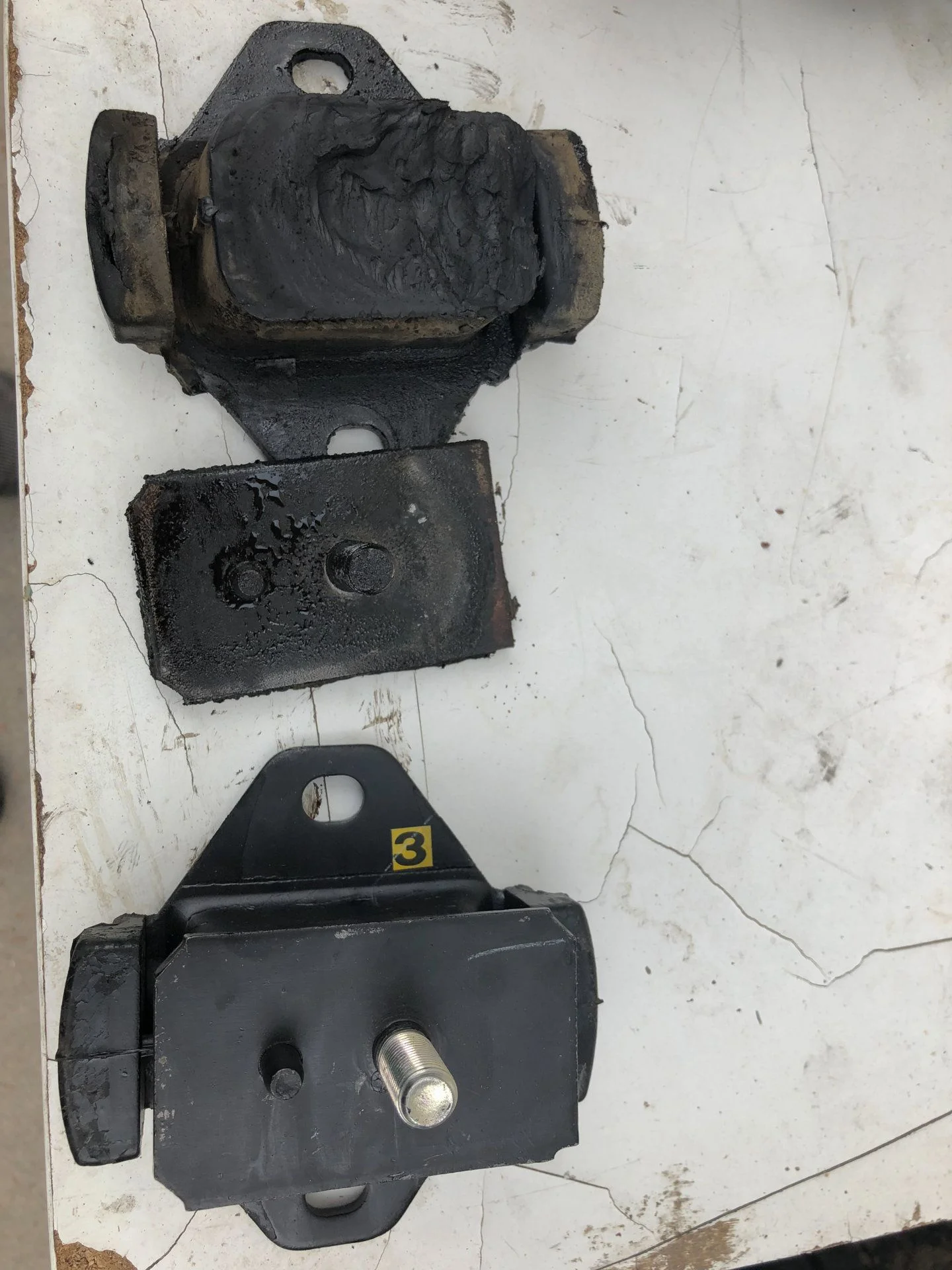

Knocking out a few small things. Engine mounts aren't too bad on this truck:

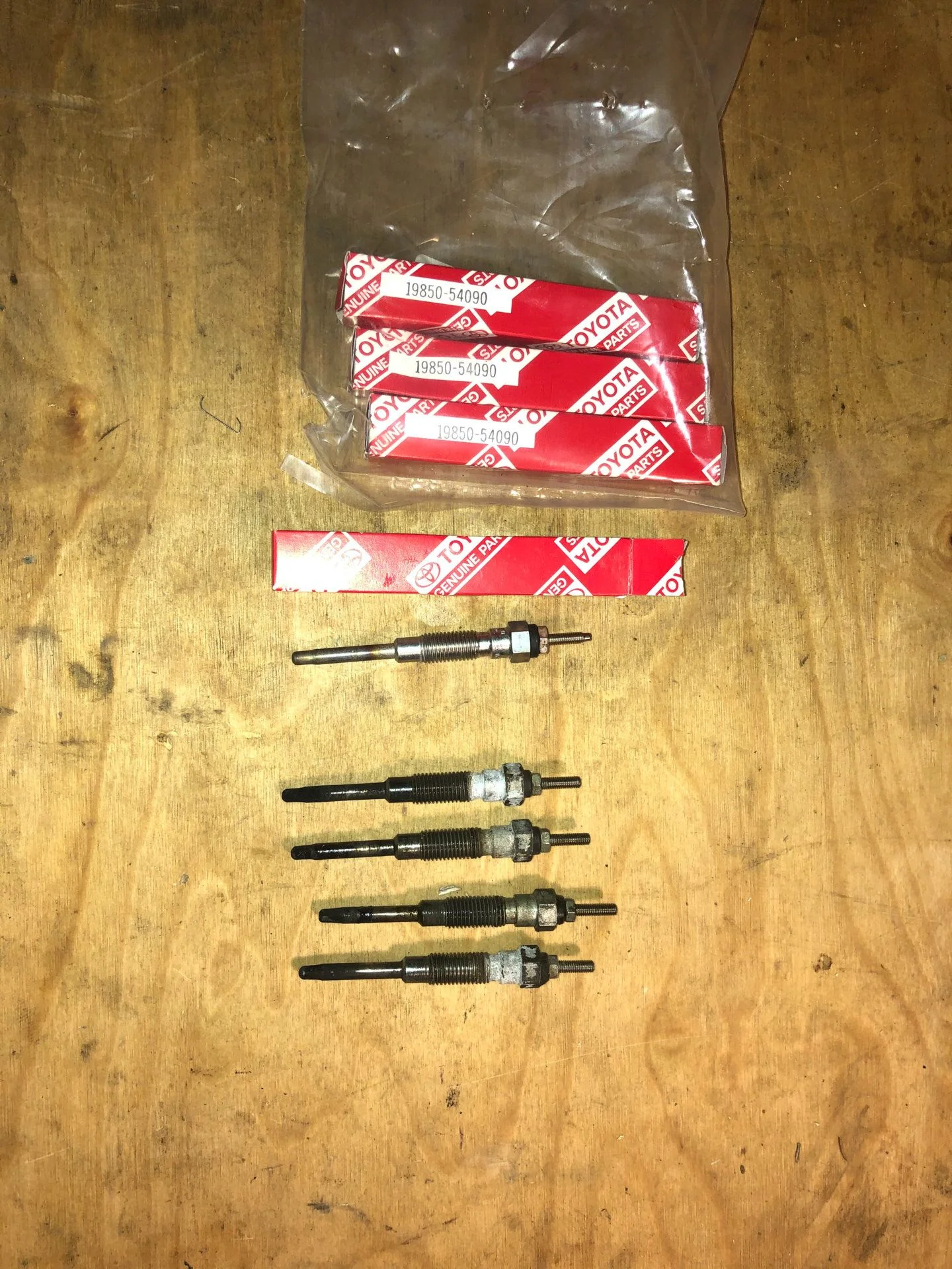

Between Aus and Atlanta I'm not sure the last time truck saw below freezing temps (does it get cold in WA?). Did the plugs on both the 3L and 3B this fall and it really improved the cold starts.

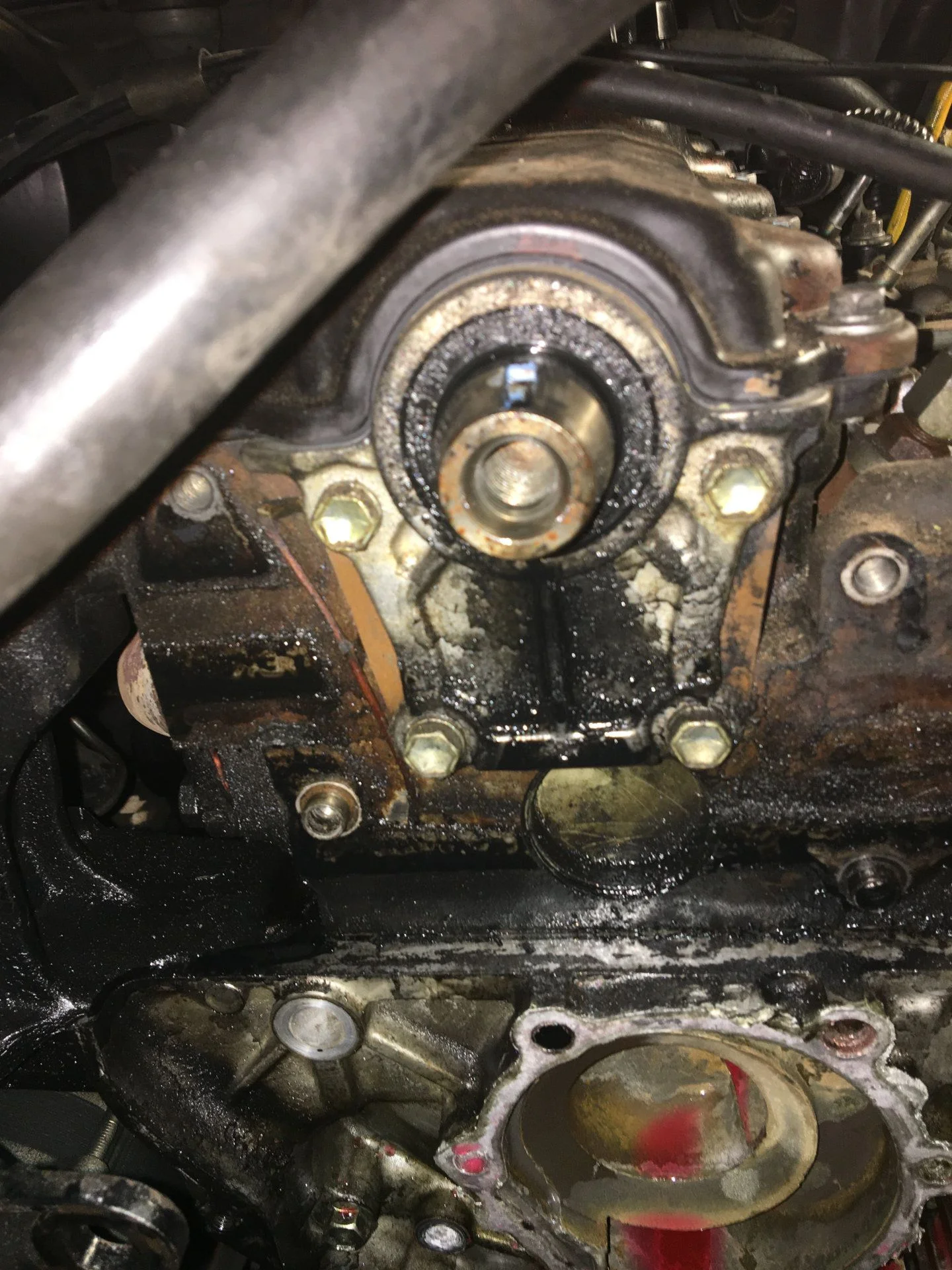

Got a couple of long trips in before tearing into the timing case to chase more oil leaks:
In the mean time I got a mess of oem parts delivered from overseas: timing belt and pulleys, water pump, cam and crank seals, flywheel bolts for the eventual clutch job, etc

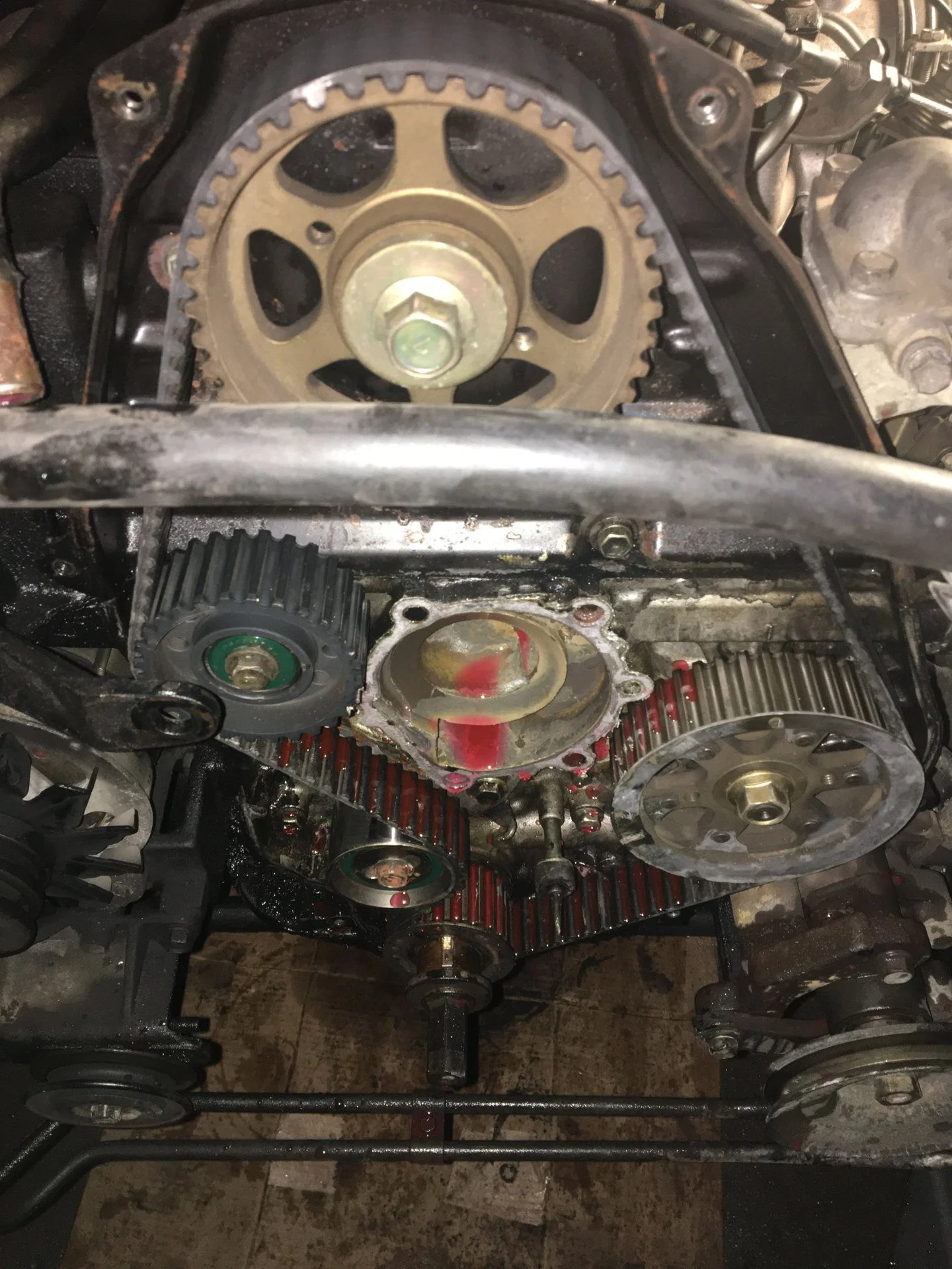

This is the first vehicle I've owned with a timing belt, so I was pretty nervous about my first time :flipoff2: I watched every video I could find of back-bush Australian fellas doing L series timing belts and I still managed to screw up the pump timing the first time around! thankfully no harm down save an afternoon of my time tearing it back down
Think this might have something to do with all that oil I've been missing...
Much better:

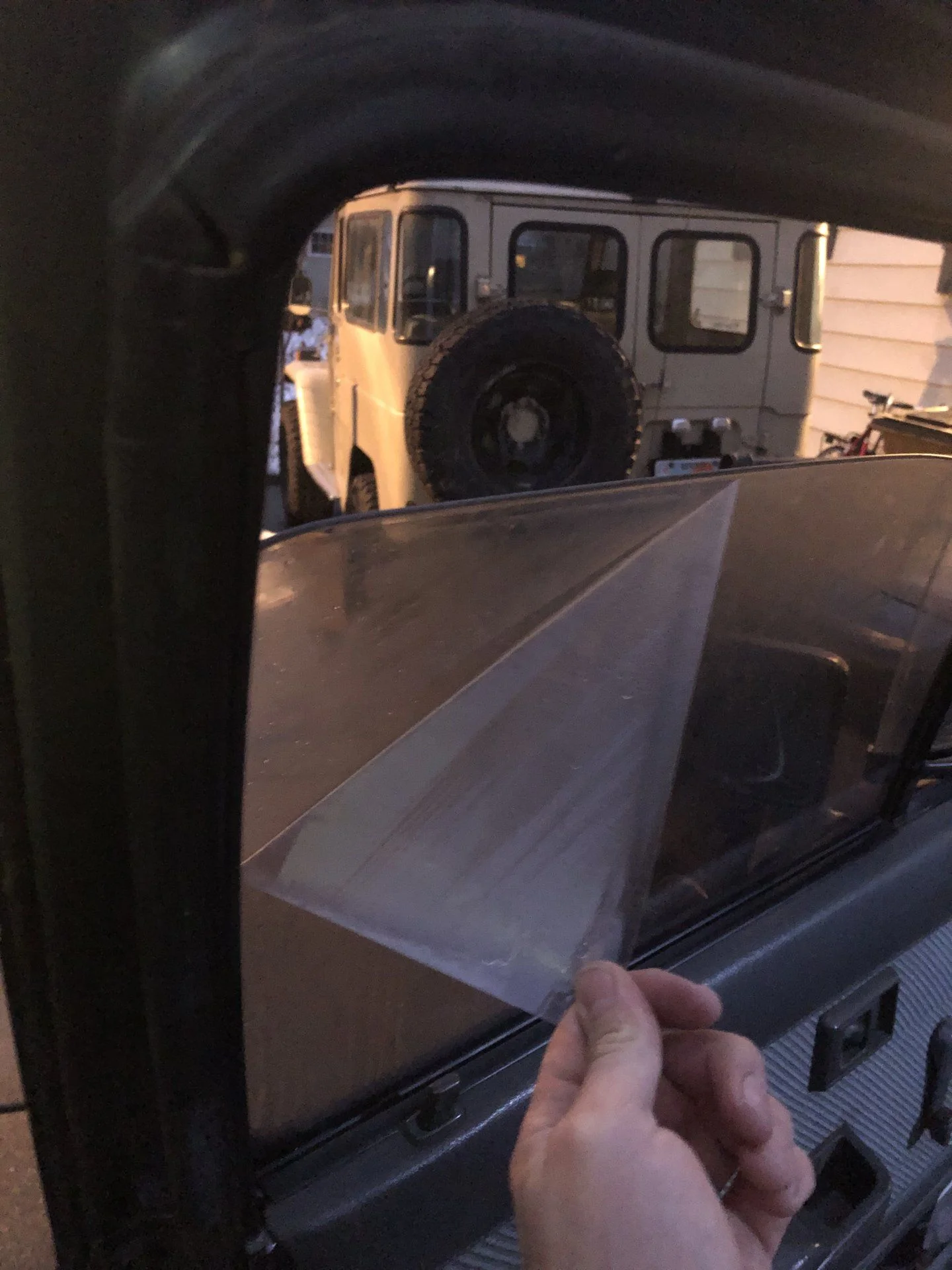

Beginning to tackle all the old window tint. (Thanks for the tips @BHillteq) The bed canopy blind spot is forcing me to use the side mirrors more and seeing through the bad tint at night can be downright dangerous.
I bought a steamer on amazon for $20. Makes it so much easier I highly recommend it if you need to remove a large area of tint - and it’s great for clothes too.

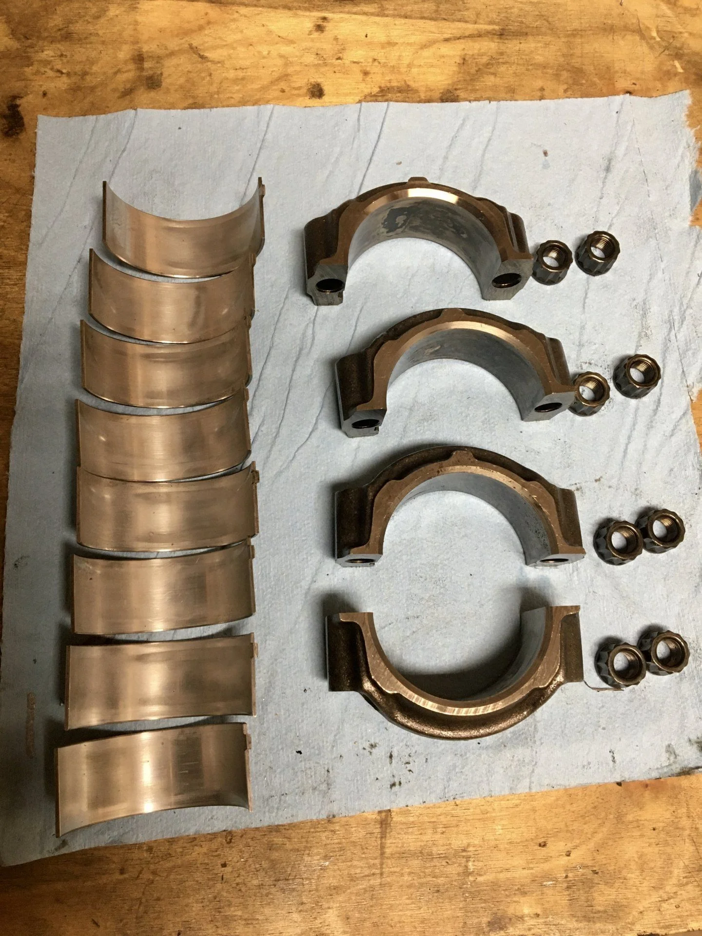

Pulled the pan to chase some oil leaks and may have gotten carried away:
The good news is the rod bearings looked great considering the mileage. New OEM std bearings plastigauge’d withinin spec (13041-54042-02). If you do your rod bearings be smarter than me and don’t buy the first bearing part number that pops up - there are 5 for the 3L - read your repair manual...

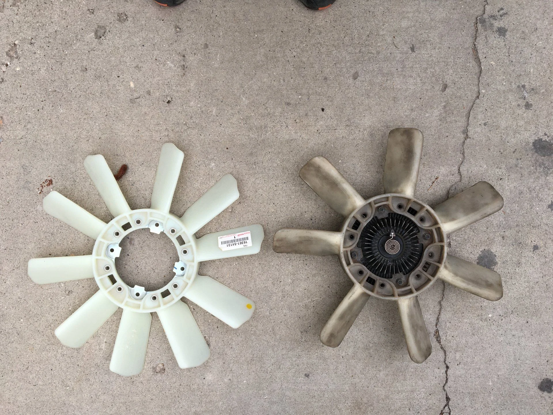

Also used this down time to swap in a 10-blade fan off a newer 5LE Hilux I picked up (16361-54131). It’s shallower than stock by about a fingers width, which is the clearance I need to eventually stab a 4 core radiator in
Curious about that 5L fan, was the upgrade worth it? Is it any bigger than the OEM 2LTE one?
I've got a 2LTE myself I've been building up to drive down the Pan American highway
Hard to say if it’s bigger, since the fans depend more on the chassis than the engine. Not sure what model yours is, LN108 maybe? But safe to assume it’s the same diameter as what you’ve got now - you can see in the picture it’s the same as my stock 3L one (16361-54040).
The hilux/surf radiator and fan shroud are smaller than the cruisers, so a 2H or LJ7# fan won’t fit without mods. I will say the 5LE fan moves a lot more air just by feel and sound, but I’ve already baselined my cooling system pretty well so I can’t see any change to the coolant temp. I was mostly after the increased clearance between the fan and rad, so I have the option of a bigger radiator if I ever go turbo.

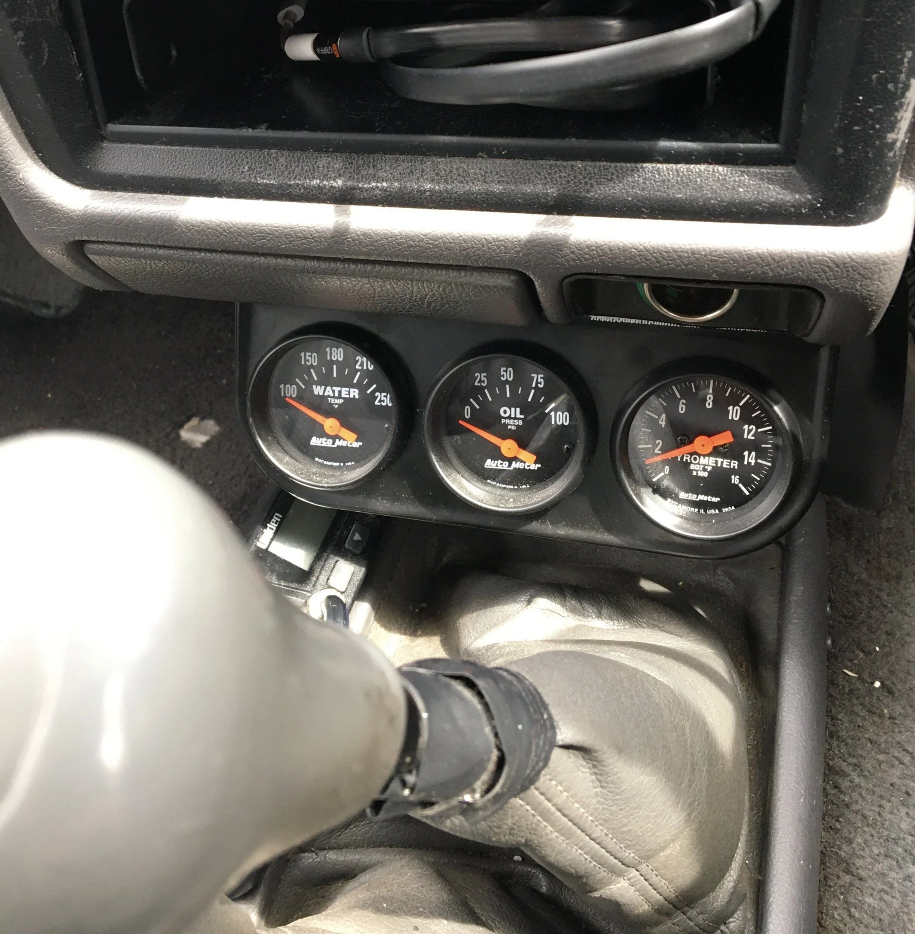

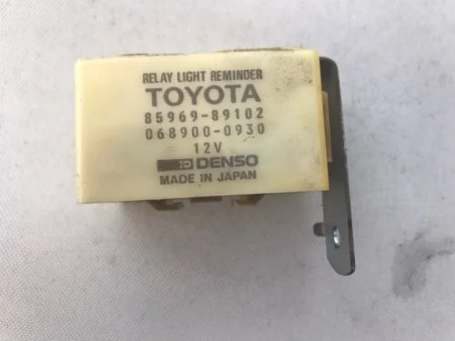

Added some aftermarket gauges. Was excited to find the headlight reminder buzzer is located right behind the shifter boot panel and is perfect to tap into for the gauges - has 12v inputs for ignition and lights, and is powered through the 10A gauges fuse to boot. Connector is standard spades so no need to cut up the factory harness if you don’t want to.

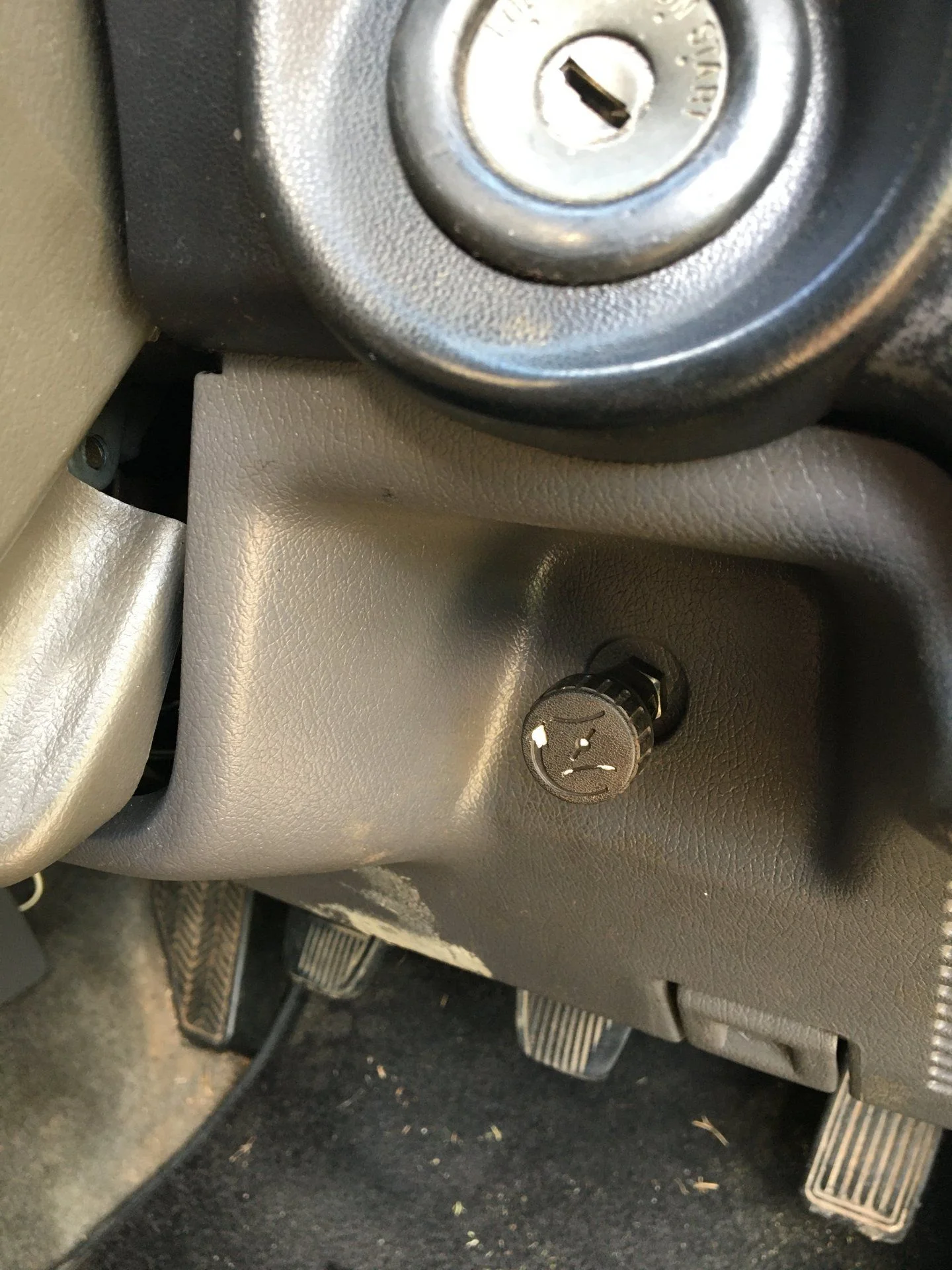

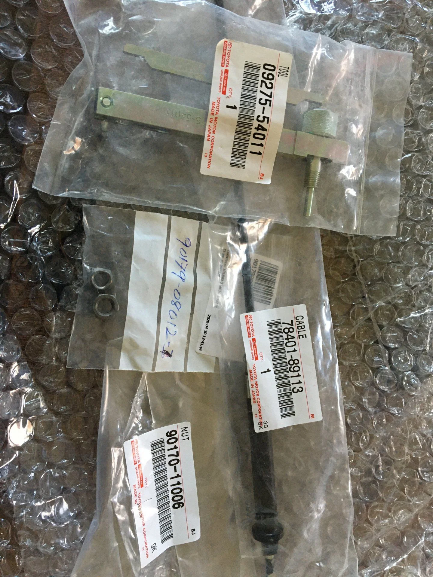

Digging around behind the dash to put gauges in a found the truck had a factory hand throttle. I guess most diesels do I’m just not used to working on one that isn’t bastardized :flipoff2: looks like someone had shoved it up behind the dash when the cable broke, luckily it’s all still available from Toyota. You can even get the pedal assembly from Japan for ~60 bucks; if anyone wants to add it to their US truck let me know I’ll send over the PNs

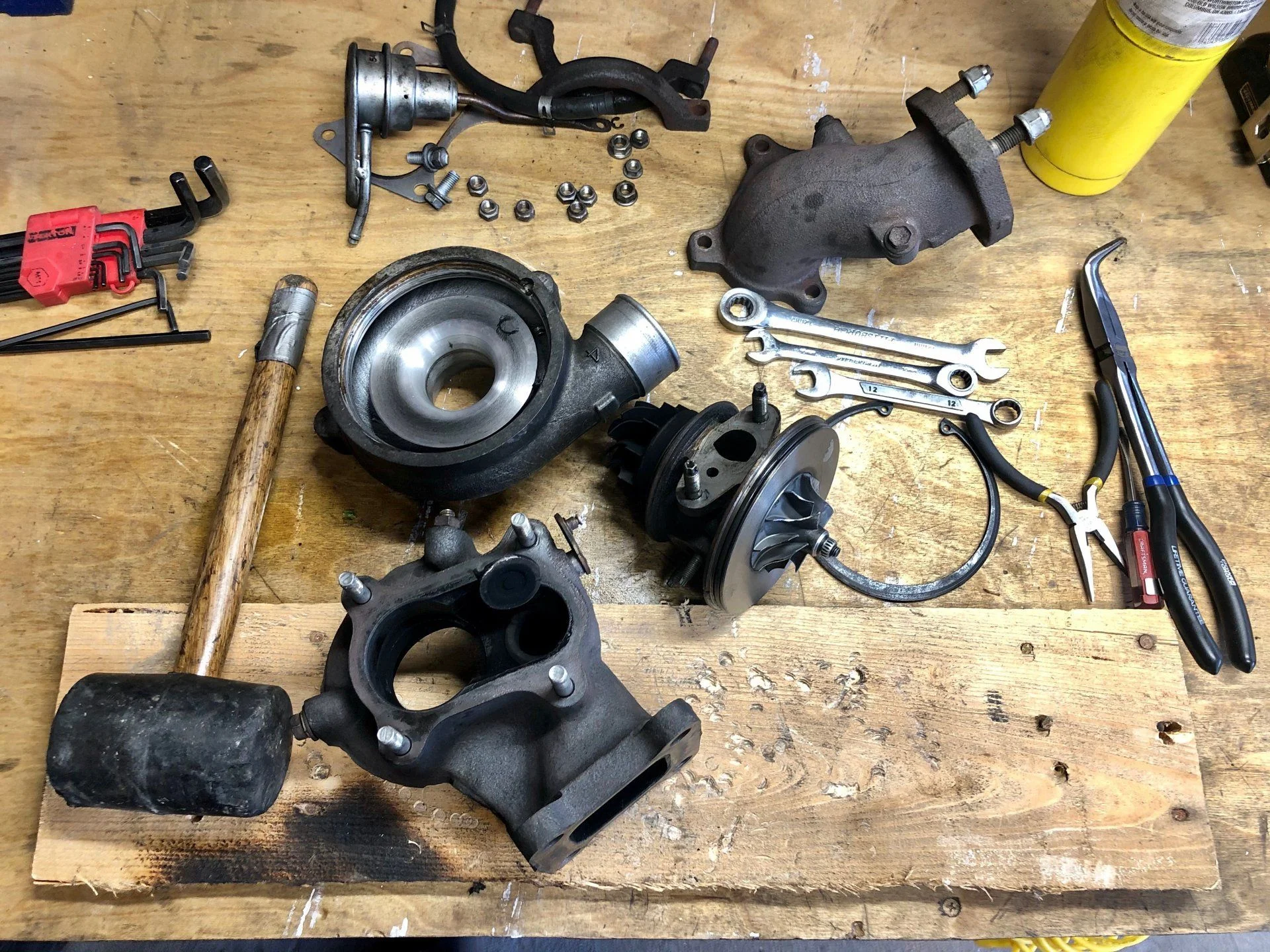

Operation turbo is nearly done, checking interference with the LJ78 oil cooler, which hangs the oil filter pretty close to the torque rod bracket on the front axle. Looks fine but I think I’ll carry an extra filter on the trail from now on.
Adding a turbo to the 3L is something I’ve gone back and forth on for awhile. It’s risky given the negative results seen on the 2LTE, not to mention the Kms already on this engine. Hopefully my recent cooling system And bottom end maintenance as well as some very conservative tuning (Not upping fuel at all to start) will save the crank and head. This truck will get a 1kzte one day anyway
Opted to spend the big bucks on an NOS turbo cartridge instead of one from eBay. A little disappointed in how Toyota chose to package something that costs as much as this did. :bang: No harm no foul I guess.
