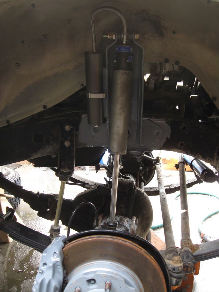

I didn't keep the invoice (don't want to know what I've spent) so no idea of p/n's, which is why I suggest calling them if you go in this direction. I looked for a pic in my build and I don't have one. Closest that I have is this one, and it doesn't show much:

I can take a pic of the caliper end in the morning, if it helps
That would be great...
