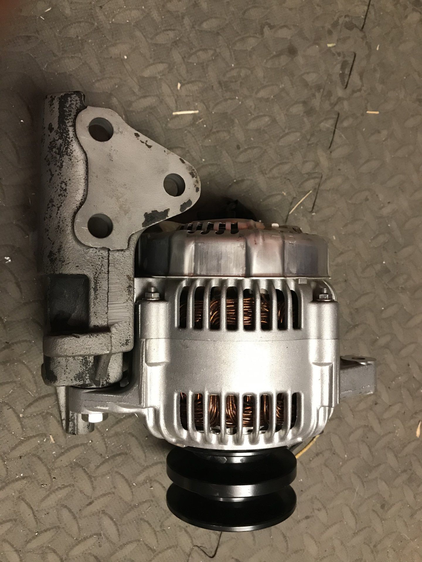

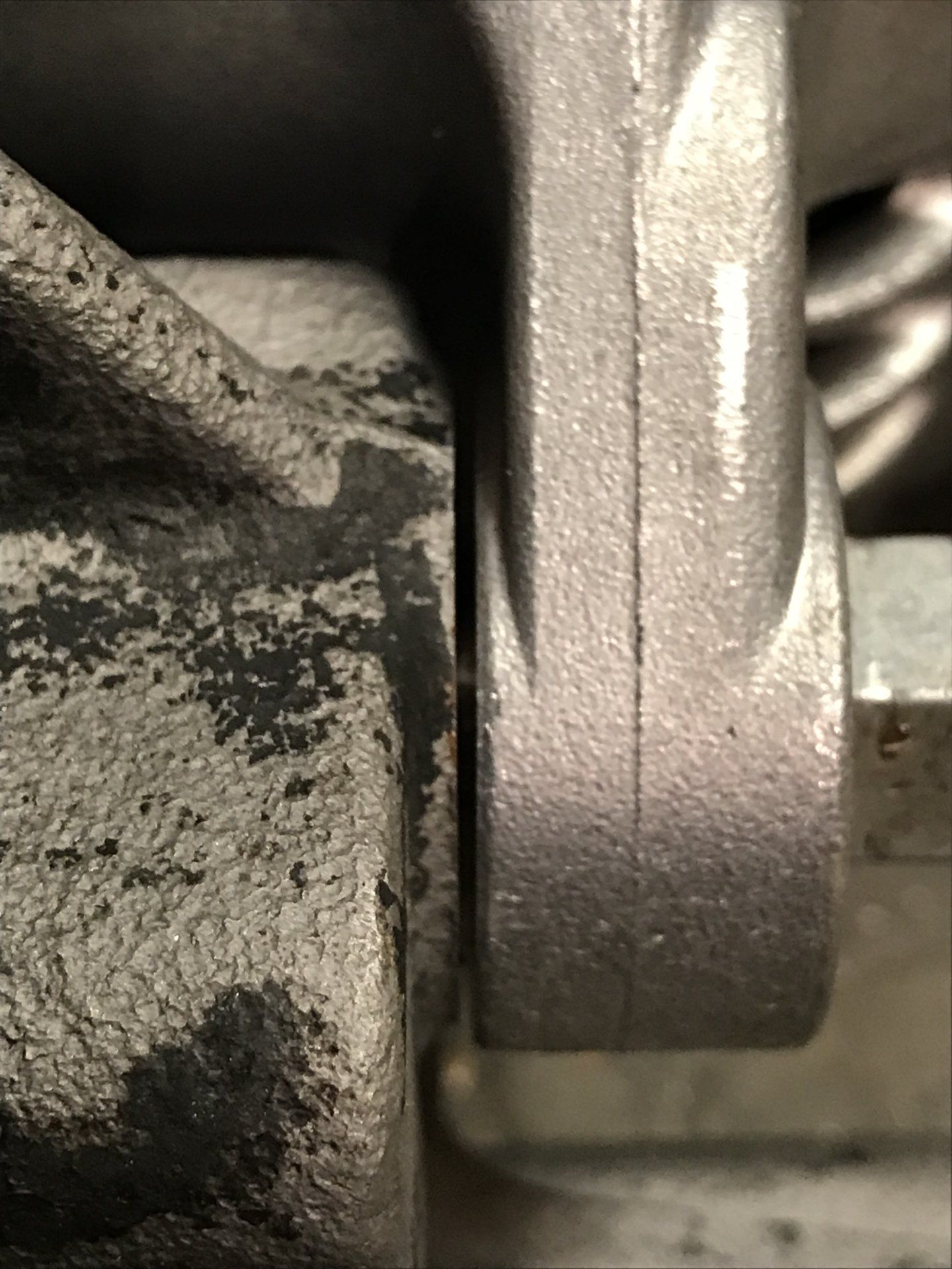

I got the bracket milled at work. I bring it home and my calcs were off by .025”.
Right now the alternator is sitting on the back mount face and not the front which is where it should be to line up with the belts.
So how tight does the alternator and bracket need to fit?
Weighing my next move. Take back to work or install?
Well if your not in a hurry just make it right.. then you will have the correct measurements for your thread .025 isn't much .25 is lol good stuff tho more options for all of us

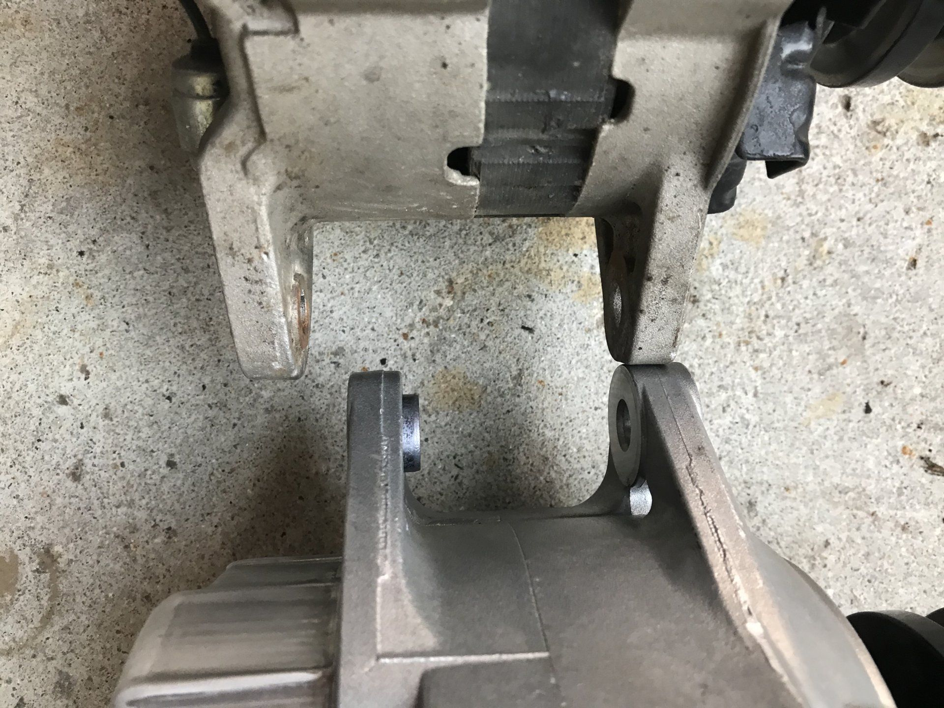

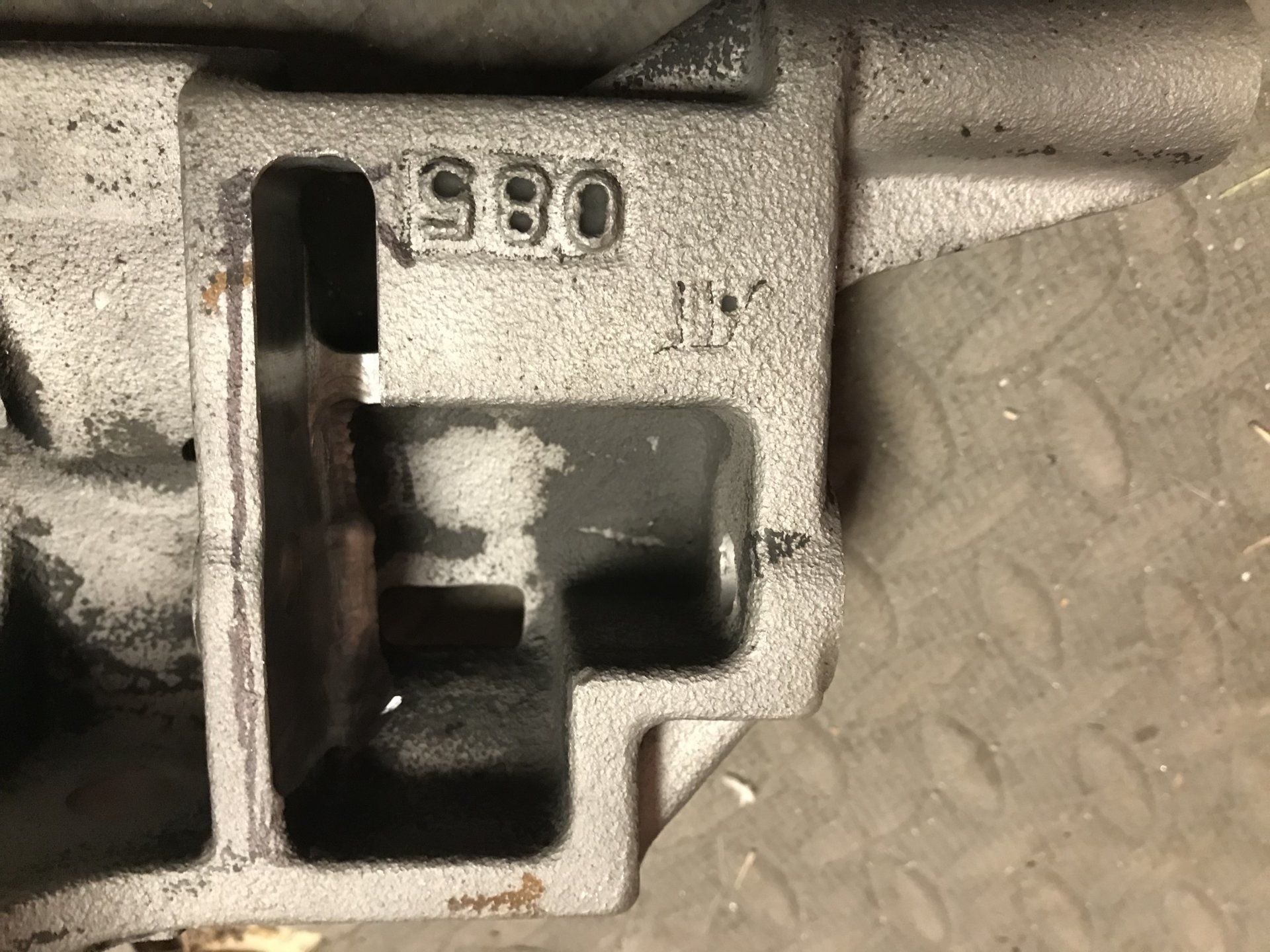

View attachment 1882747 View attachment 1882748 View attachment 1882749 View attachment 1882750
Oh that is not fair! I had to do it with a Dremel! Hahaha.
Nice work! Looks great. I say go the rest of the way and make it contact. Then there is no side pressure on the arm so no risk of a crack forming over time. Although I bet that wouldn't happen anyways. :P

If the alternator pulley was .025” too far forward would it cause any issues? I’m guessing no.
No I need to look at it and determine if I can sand the spot down with a file on the rear lug or give up and take it back in for a haircut.

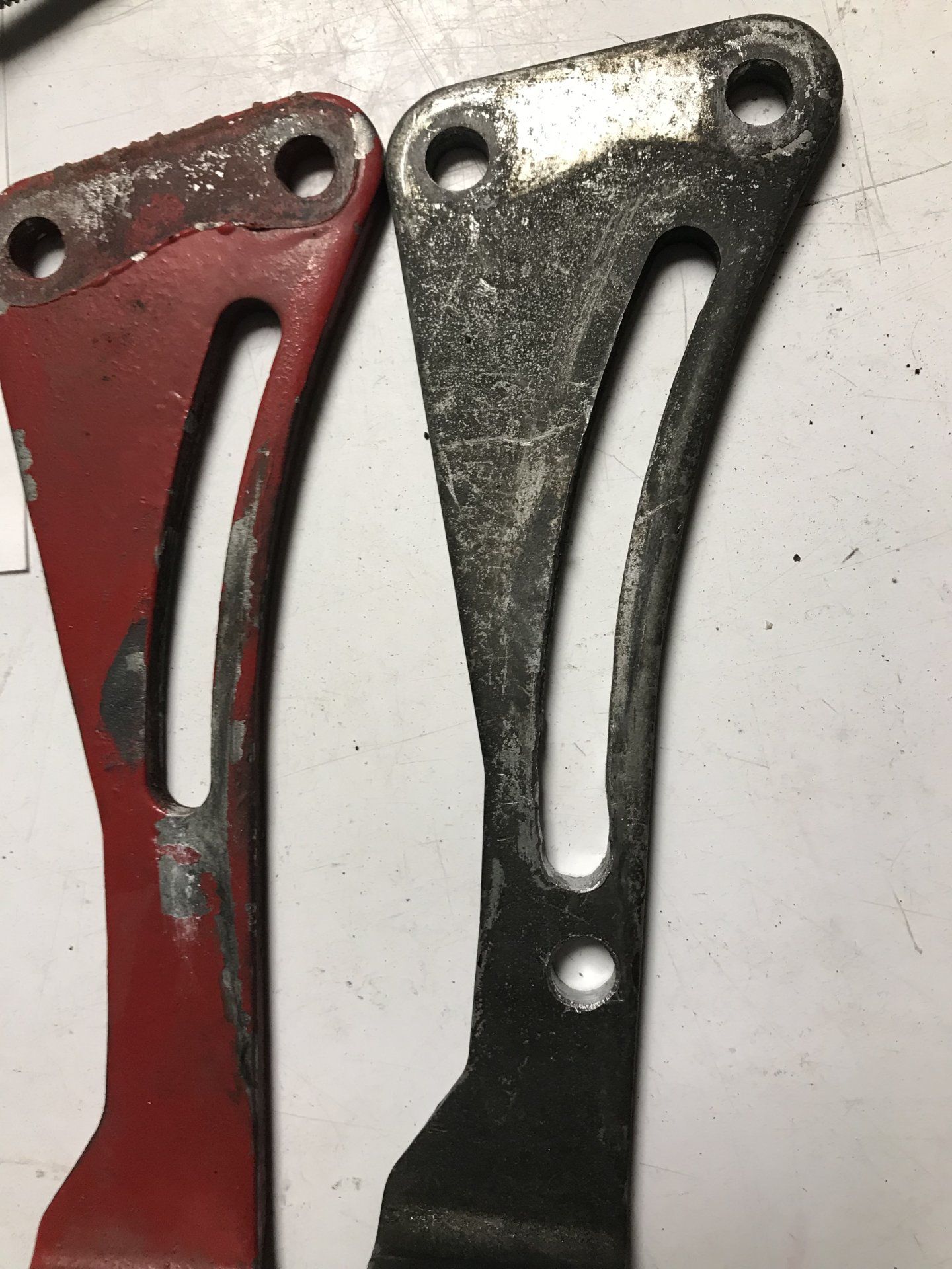

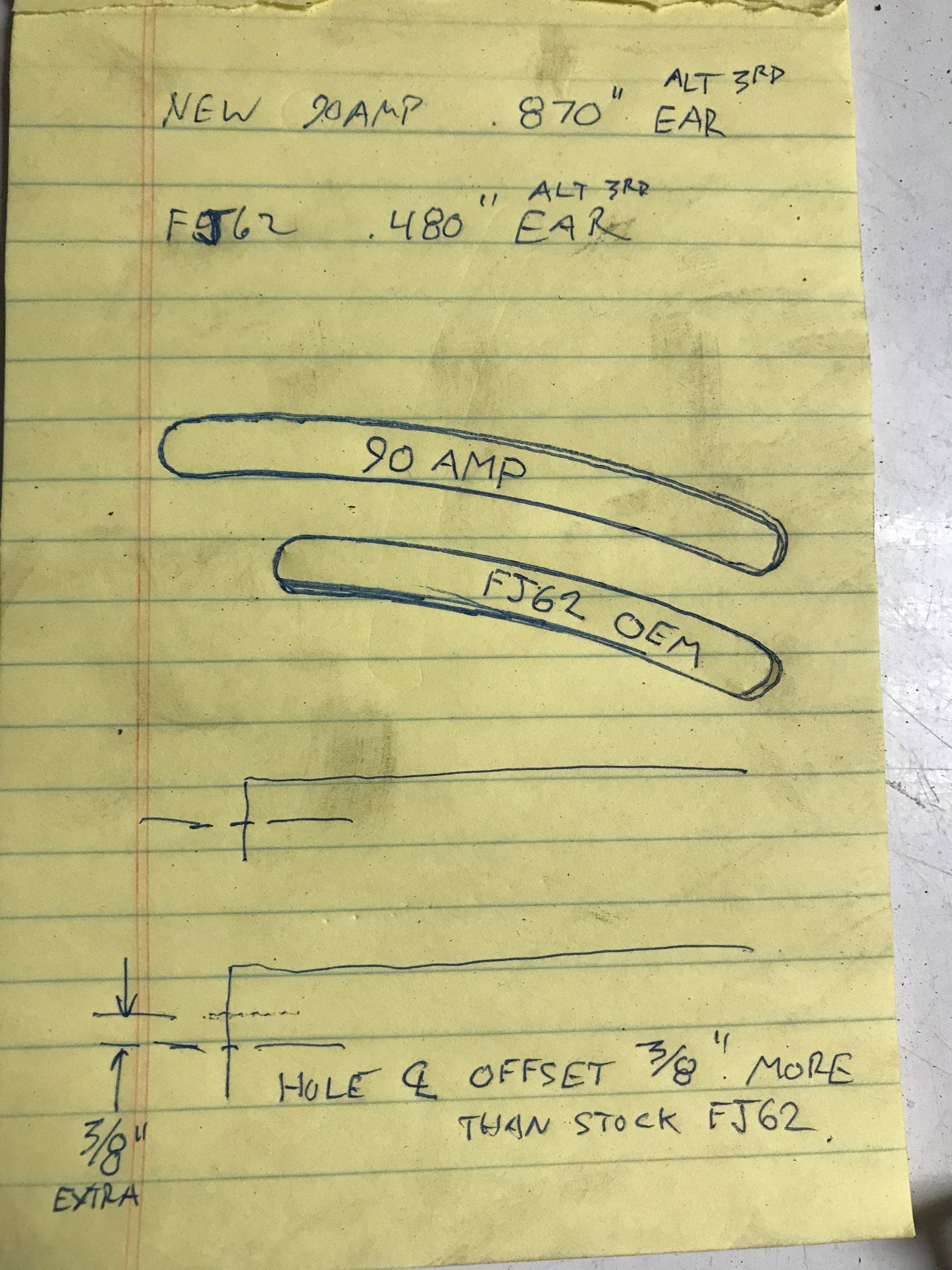

The tensioner bracket is different. You can buy or mod as I have. The bolt that tightens the tensioner must be threaded longer with a die or buy a longer bolt.
The tensioner bracket can be extended 3/8” towards the back of the vehicle to accomodate the new alternator.
The 90A alternator has a thicker top third ear which means the tensioner bracket end where the bolt tightens must be modded.

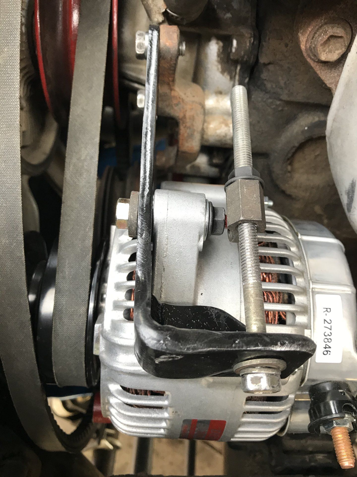

All buttoned up and working.
Is there any chance that this, if done incorrectly or not, could cause the alternator's pulley to be slightly offset and make the belt whine?
The back part of the mount is what needs to get clearance, so the front mounting ear positioning doesn’t change. The pulley alignment shouldn’t get altered at all.
red66toy explained it well. The alignment of the belts is not modified when clearancing the rear lug of the engine mount.
View attachment 1883896 View attachment 1883897
We liked this mod enough to make a tensioner to work with it.
One less thing to monkey with 😉.
