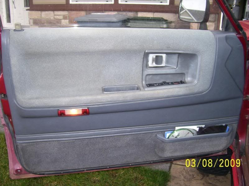

Here's a better picture from my 85
My 84 SR5 4runner has the basic flat switch for both windows, no lockout. Did Busmup change out his panels? The interior is brown and the panel is grey.
I am pretty sure that 84-85's had the same switches (flat). In the center console, 84's did not have a lockout for the rear window, but I am not sure about the 85's.
If you really want to see a contrast, look at a loaded 89. The one I had did have the contoured panels, but also added the power mirror switch to the driver side armrest.

Sorry to confuse everybody. My 85 is a SR5 with a 5spd and it came stock grey interior with the door panel you see in the picture. This truck had every option Toyota had for this year. Being that I'm from Hawaii, none of these options were coming down our way. This truck was made in 10/85 so i don't know. I also bought this truck here in WA, where I now live. I no longer have the truck, but i had a 86 2wd turbo that i wrecked and swapped entire interior to brown. I couldn't use the drivers door panel because i was tboned on the drivers door. Glad to be alive, as they needed the jaws of life to take me out. I was more pissed that my truck was smashed than my injuries. Truck only had 45 original miles.
This door panel style didn't come out until later in this generation, I believe 1988 was the first year, only on the "fully loaded" SR5 models. This is the same panel I am upgrading to, same color. I had the upper insert portion (lighter gray in this photo) reupholstered with new velour at a shop that specializes in auto and boat interiors (Superior Interiors), they look brand new now. I'm giving up the map pockets and adding a set of 5-1/4" Hertz speakers to my doors, I'll have to space them out a little with some wooden trim rings, and I might even get adventurous with some fiberglass surrounds. I carefully scrubbed the rest to remove any stains, used Resolve and TuffStuff to clean them, they look great. Mine don't have the power mirror switches on the doors, the switch was in that little cubby to the left of the gauge cluster. I'm not installing the power mirrors, too much trouble for little benefit. I think I have a couple mirror switches in my stash, if anybody needs them.
This is the door panel that was in my '84 Xcab SR5:
Basic 2 switches for the windows, no power locks, no passenger window lockout provision, no puddle lights.
That's how i bought it. My 86 22ret had the same door panels! Even my other 22ret 4wd had those door panels. If it only came out in 88, something's very wrong here.

Based on what people are saying about the "later" style switches coming out in 88 I think is incorrect. From what I have seen, it looks like the "small" switches (just the 2 window switches, no window lock) came in the 83-84 SR5 Runners. The "bigger" switch came in around 85. Those are for the door panel mounted switch. The armrest switch is still somewhat of a mystery. It looks like the early turbo trucks had that style (based on options maybe? not really sure) and the later(?, not sure when they started, thinking 85?) Runners had it as an option.
Just to further complicate things, my 85 SR5 4Runner has the smaller 2 switch... That's not to say that manual and power locks were not available in the same year on early SR5's....
Always throwing a :wrench: in the gears... I think I stated it in one of my earlier posts but it looks like the production date is pretty fluid. I don't think we're going to be able to nail it down 100%.
^^^^^ Yup, what he said. My 85 has a July 1985 production date.
Oh well, if nothing else we (we being Sam at Lowe) have established what the correct part number for each type of switch in each type of panel. Now that we have got a few pages on window switches what part should me move to for our next major discussion. :-)
