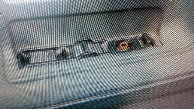

Ok, so I have talked to Sam at Lowe and we are getting sorted but just for reference here are the two types of switches.
Switch A (sorry phone pic of the computer screen)
Switch B
I have switch A and got switch B, islander based on your previous post, my guess is yours are like mine.

From what I have determined so far in my great amount of research into this, KLF seems to be correct. It has to be an SR5 to have power windows at all and I'm thinking that the production range is one of the differences. The catalog is not exactly crystal clear on the descriptions and usages however... They are all listed for the same model codes, SR5, production ranges vary.
jynx, as we discussed earlier, the switch you have in the picture above (a) I believe is part #84820-89104 which IS available, not disco'd, (sent one to someone else, also was wrong) and seems to have been snuck in all the way from 85 (only in Turbo trucks? Maybe?) and then used on some of the later production trucks, depending on what type of door panel you have. The one you received, 84820-89103-23, is if you have the other type of door panel (like busmup) and production range, again, varies.
