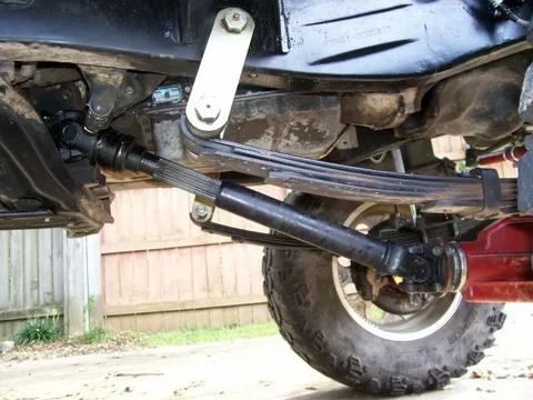

The 4runner is 4wd again. Installed the right transfer case flange and had a single u-joint welded on to the front drive shaft. Drove it on the street a little bit and the front locker does not unlock to well making it hard to steer, but that's an auto locker for you. With the auto trans I can just shift into 2wd when needed.

Sweet... that's quite an angle my friend.
Yea, nice to see you got it all together. Now it's time to :steer: off-road.
John I am pretty much a novice at lifts and probably don't know what I am talking about but is there a way you can get that diff to angle up a little more. I know with non SOA you can use shims but I know nothing about SOA. Just curious. Looks awesome.
how much lift can you put before you have to correct for driveshaft angles?
im going with 2" longer shackles in back and 1 1\2 balljoint spacer upfront.
The rear is fine I have only noticed it unlock a few times, but no tire chirping or anything else during parking and tight turns. The front locks and is not fun to steer on the road (just seeing how it acts) but in the dirt its alot better, I will just use 4WD off roading anyway.
