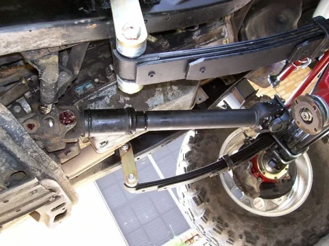

Also ran into a problem with the front drive shaft, it is to long after I brought the whole truck so that they could measure themselves. The angle is not right it seems I have the wrong u-joint, any suggestions.
Will try to take it back to the drive shaft shop tomorrow, but it doesn't look good for the weekend. But got everything else together just hope that tire holds up.:bang:

Looks great John, sorry to hear of your woes. No ideas on the driveshaft but with a well outfitted shop they should be able to fix the length with no problems. Drive it over there and let them get it right you went out of your way no they can fix it. You should be ok on the tire I've had tire shops damage the bead on several swampers and others because of the new style machine they're using it not really big enough to mount large tires and it pinches the bead. The beads on the swampers are very thick. I've tried a few places and they've turned me away for just a 33' tire.
Put a single u-joint at the T-case to eliminate the CV joint .This still means to cut and re weld, look at how much angle you are getting from the single u-joint for the front third member.
I have some spare drive shafts, let me look at them and see if I can find one that will bolt up to your T-case and you can cut the tube off it and swap it in place of the CV on the one you have now. Don't give up hope on the truck we all get little thing that does not work out like planed.

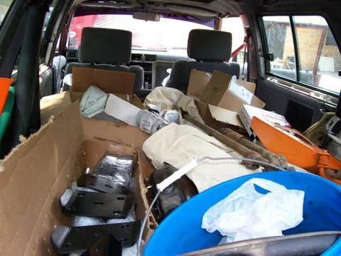

Thought I would do a story line and pics for those of you just wandering about the process. I used the trail gear 5'' IFS eliminator kit and 5'' rear classic lift kit. Loaded all the parts and some tools onto the cargo area of the 4runner and off to the shop we went.
