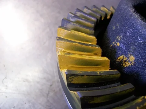

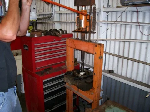

Finished up the gears and Detroit Lockers just have to reassemble the rear axle. Plan on reassembling the front after all the welding. It took use three wrenches and a home made jig to get the rear crush sleeve set. Four attempts and all our shims to get the front gear mesh set but it is all set right thanks to some friendly guidance.

New parts are always nice. Yep setting up gears is fun. Are you going to do anything special to break in the new gears ?
Nothing special just heat them up, cool them down several times , and put about 500 miles on them before I strain them to bad. I was going to try riding around with my front hubs locked to warm up the front. That way I do not have to ride around in 4wheel drive all the time. Is there some special way to break them in? I would be truly grateful for all the advise I can get.
No Sir, the real work will begin tomorrow at Albert's friend's shop. Plan on having the work done by Friday if all goes well, with Albert's know how and skills I think it should all be good. If anyone would like to stop by and check things out just give us a call for directions. I am pretty excited to say the least.
