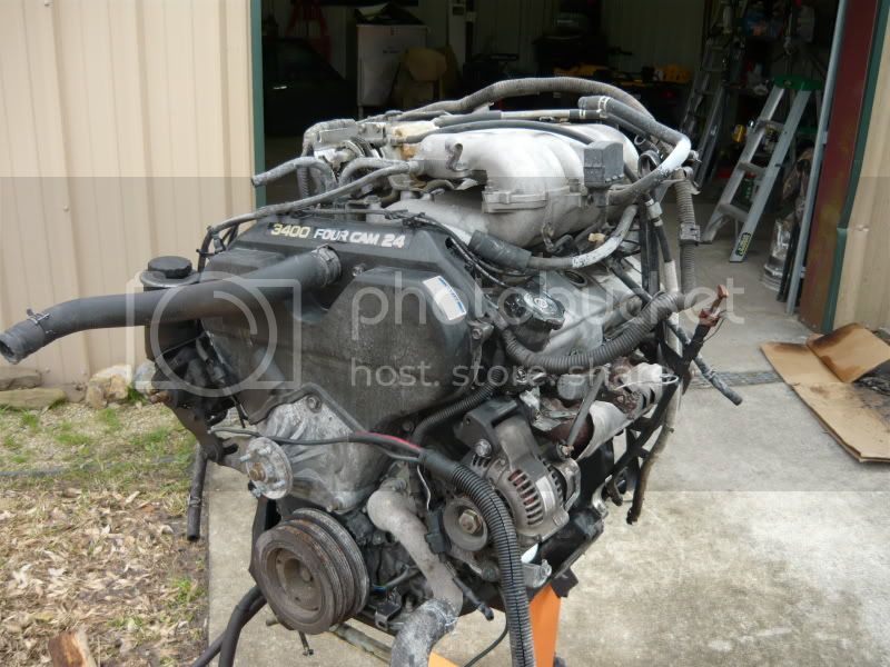

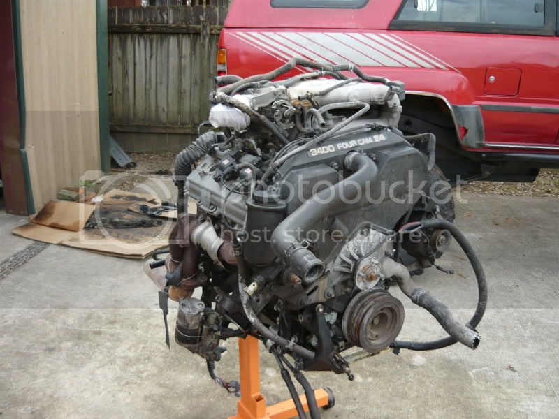

Spent a couple hours cleaning the Red Dragons new heart, and depending on how much Obama lets us have for change on tax return determines how soon it will be dropped in. For your viewing pleasure and mine::grinpimp:
Whatcha going to do about those missing coil packs? Or are they laying around somewhere we can't see them?
Yep have a few extra parts to put on later along with a new seal kit, and possibly head gaskets not sure yet.
I have to say that is one of the best things I did with my current engine. Before I dropped it in I put a new timing kit, oil pump, seals, gaskets, etc and have been running full synthetic ever since and she uses no oil. I just wish I would have had my injectors professionally cleaned before I put them in. My #1 likes to stick closed sometimes, especially when it's cold out.
I'm exploring more options for a possible future swap for mine. I definitely want to follow your steps to see what you run into along the way.
Let me know when you are ready for that heart implant. So what transmission are you putting in, auto or manual or the one you have now.

Bolted the starter up today and did a compression test the cylinders all ended up over 150psi after some lubricant was sprayed down the spark plug holes. So looks like we will just do the timming chain, water pump, and a gasket kit for the engine repairs, along with alot of parts washing.:hhmm:
good #s
SOOOOOO will B ready for R-B-R HS June 4/6:steer::clap:
How was leakdown?
Let me know if you need help with anything. I owe you a few.
