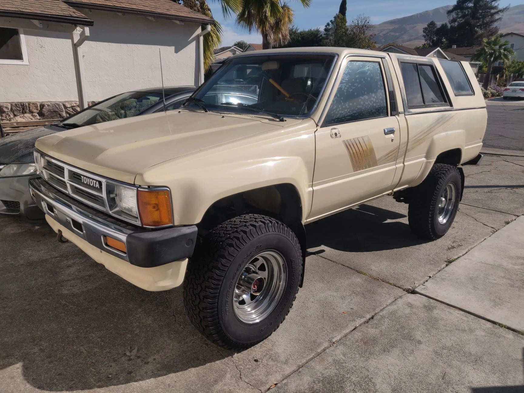

Im in a weird spot. Just bought an '87 Toyota pickup 22r (4x4 standard carb w/ 110k miles). Looks like the old owner had the truck sitting for a long time and ran it with the same old gas in the tank. It corroded the gas tank sending unit and ate up the carburetor from the inside. Mechanic friend says the carb probably cant be rebuilt with that damage and that we'll need a new one. (havent seen it in person yet)
Am I s*** out of luck when it comes to aftermarket carb that will pass California emissions? Looks like the weber CA legal carbs were only made for the early 80s models.
Thankfully, my local smog shop doesn't care too much about the visual inspection, as long as the tail pipe exhaust smog test passes.
Assuming a rebuilt is out the question, is finding a donor truck my best option here? If so, any idea if the 2wd trucks used to same carbs? What about year/model?
Finding a similar year/model donor CA vehicle seems like a pain.
Thanks in advance

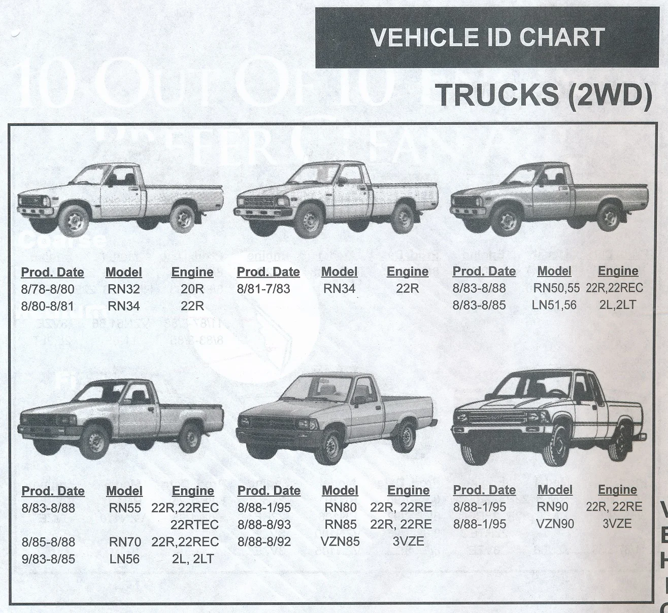

True, in 2WD trucks.
