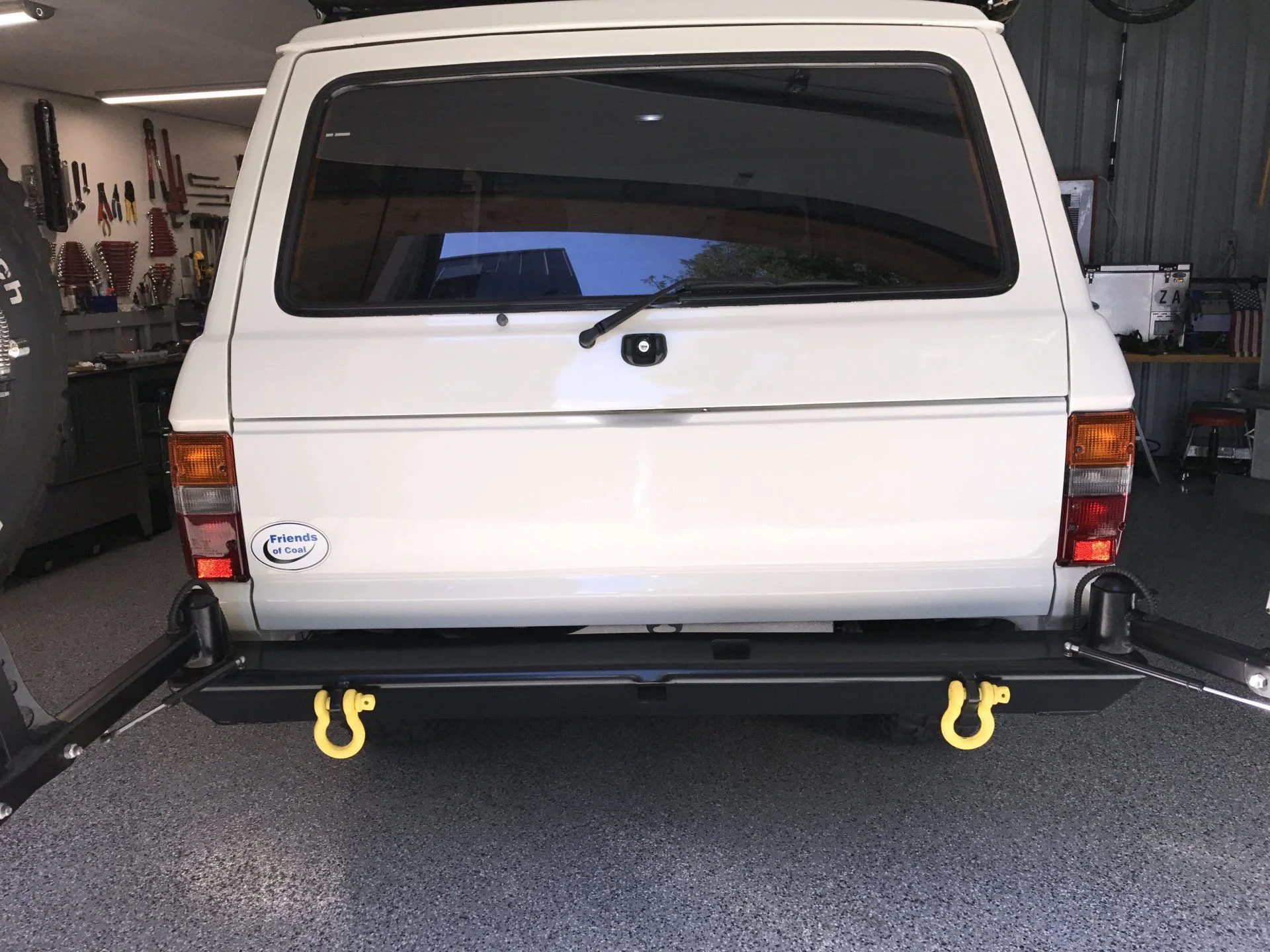

Modified the rear of the truck too

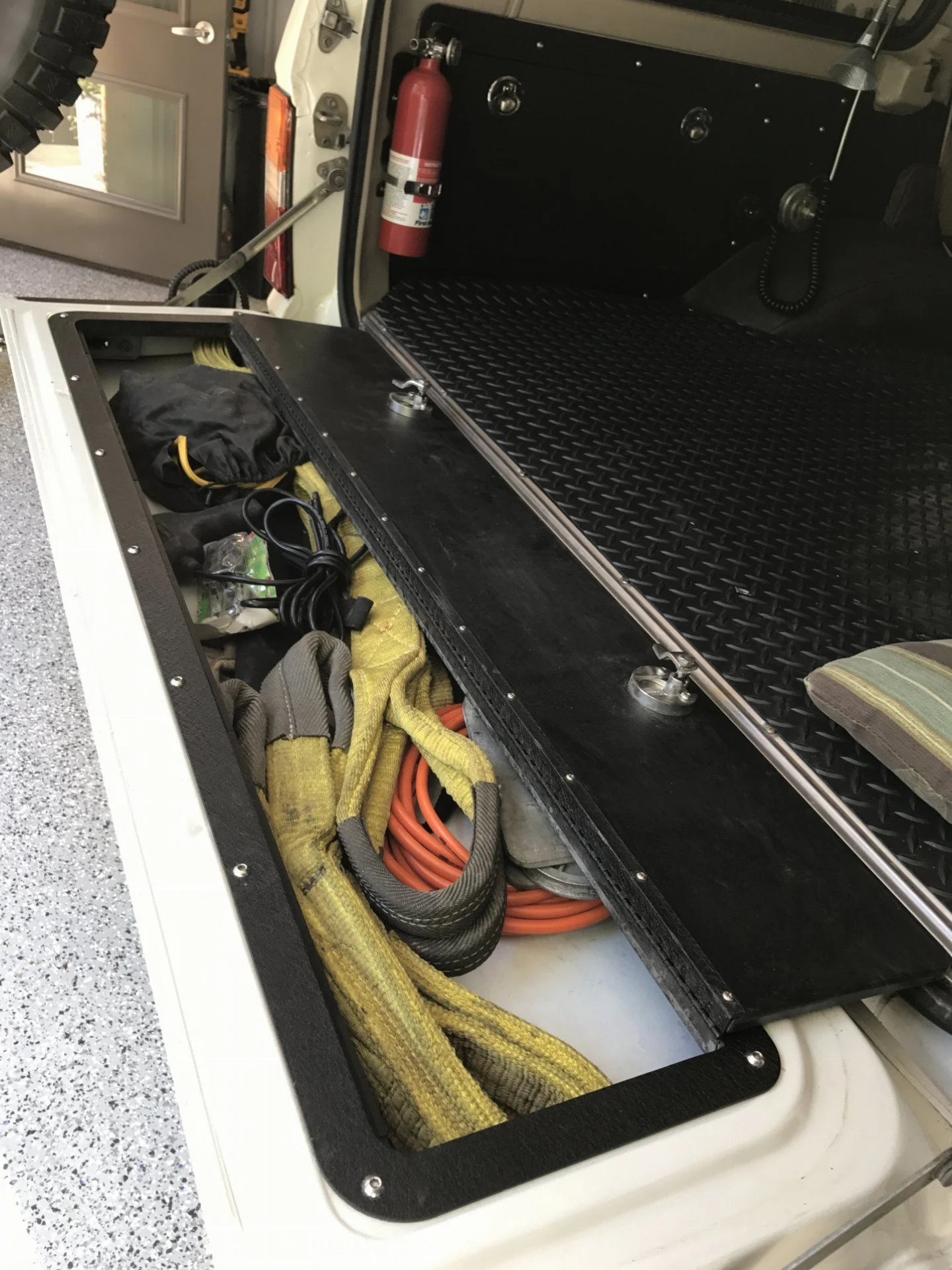

Had the rear tail gate modified removing the license plate inset to allow more room for storage inside the gate

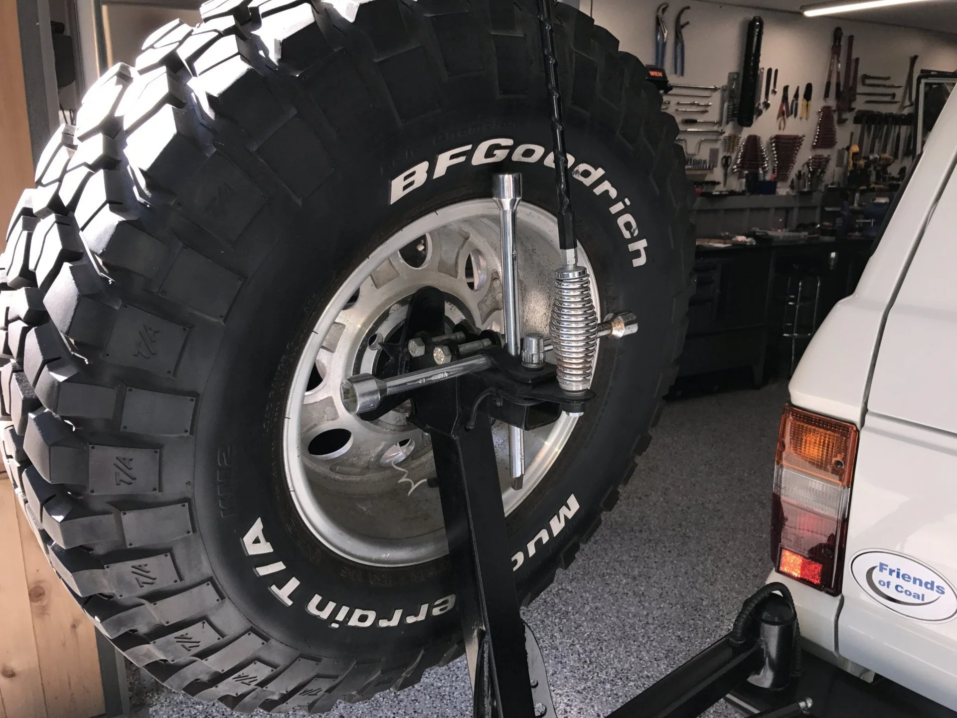

The 4x4 Labs number modified to hold lug wrench modified with a 3/8" socket drive

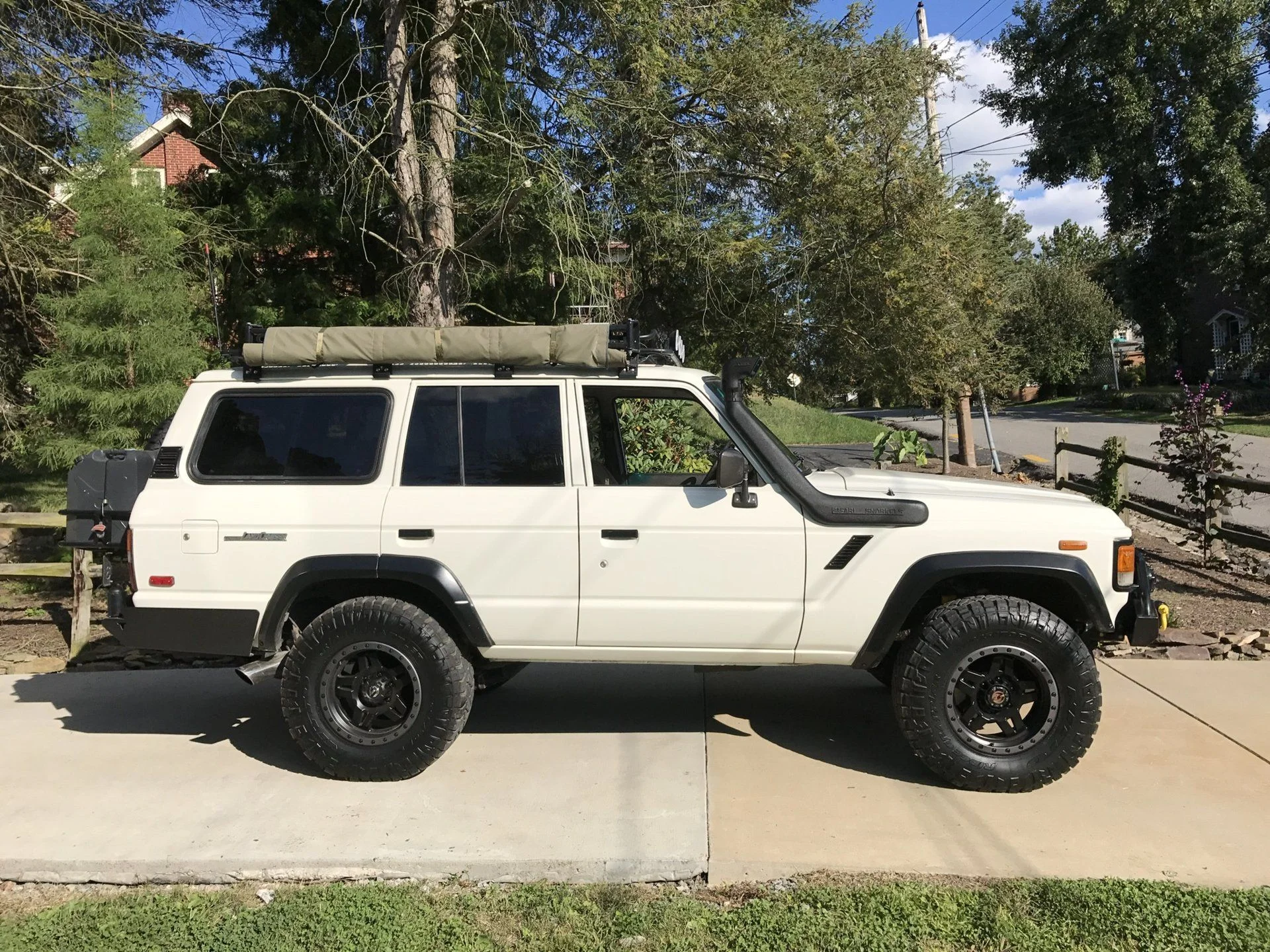

OK I am back after some time behind the wheel. I did get the final drive ratio back to 3:70 and have the 34” tires on. I did a 1/2” body lift to get a better bit of clearance for those tires.
This engine rocks. It took me a bit to learn how to drive a very low end motor- less revs are the watch word. Driving around “Not-a-flat-spot” West Virginia presents some challenge to getting steady easy cruising as such I am getting 16 to 18 mpg. Less than I wanted, but I am really happy with the performance. I cruise at 70 to 75 at revs between 2100 to 2300. When I get a load on the engine, the turbo spools up and the air inrush through the snorkel is awesome along with a smooth increase in power. All around a hellalot better than the 2F.

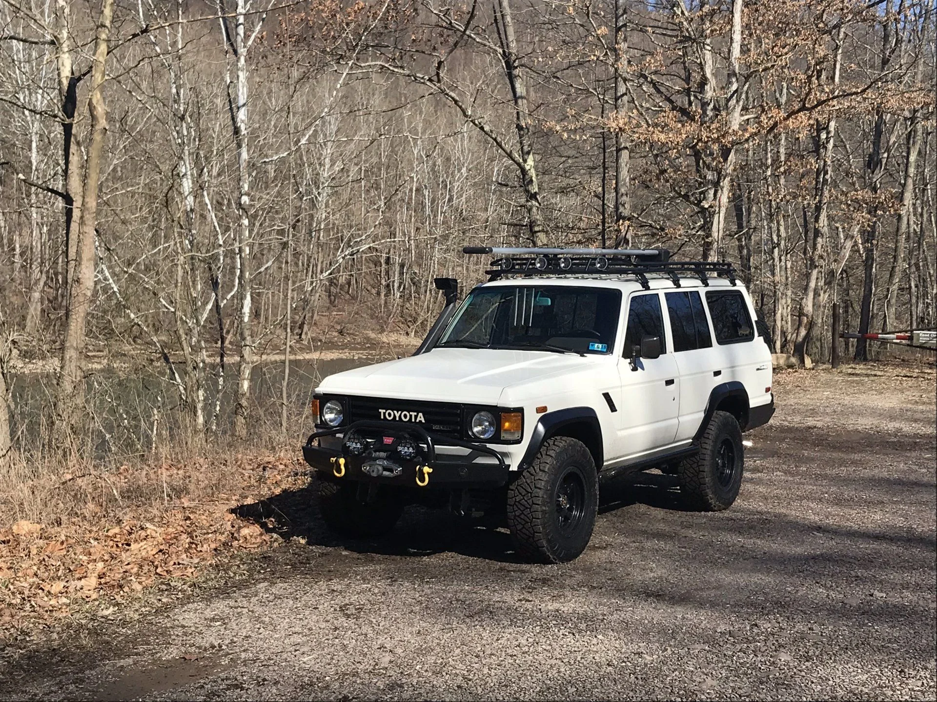

Above is before the body lift
After the body lift

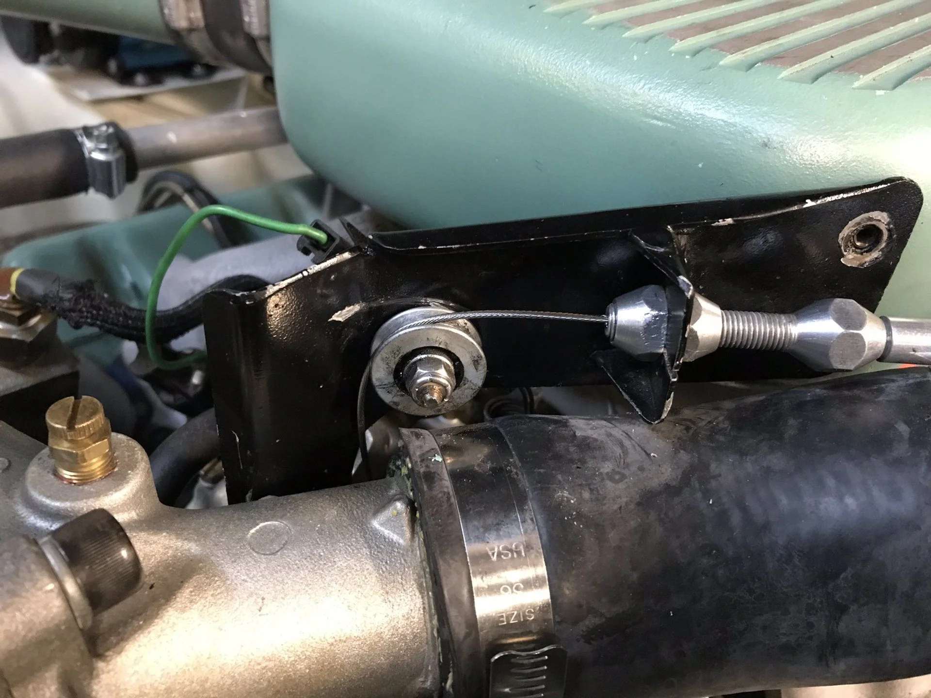

I have had very few serious “design” or fit issues. One item is my accelerator cable. I fab’d a bracket with a pulley to snake around the water outlet and reserve back to the fuel pump throttle connection. The problem is that the pulley is too small a diameter and the cable frays as it fatigues.
I am going to have to put in a bigger pulley an, likely modify the bracket
