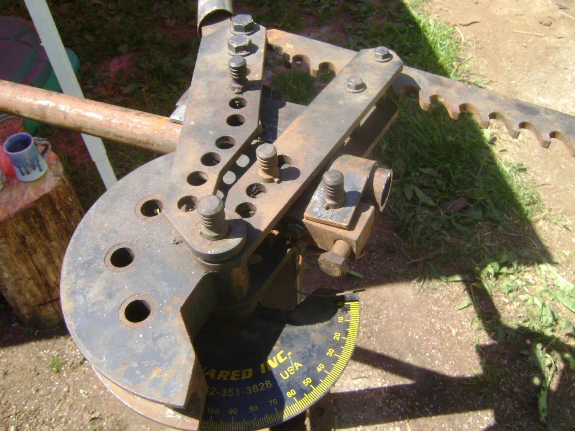

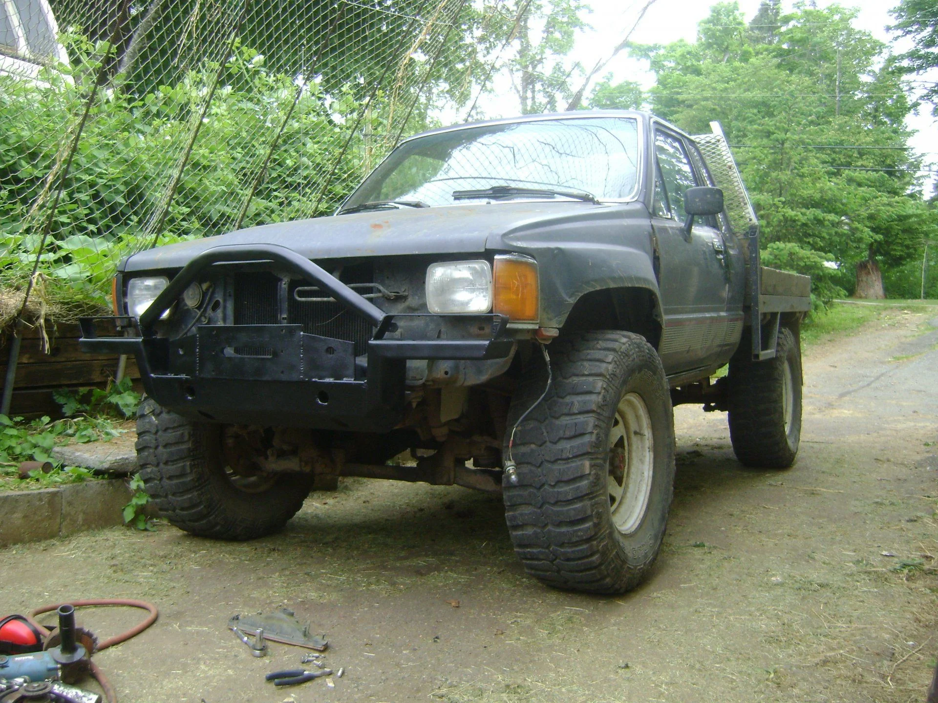

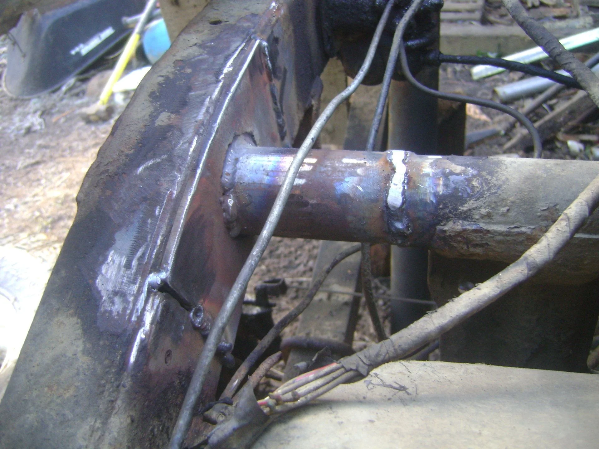

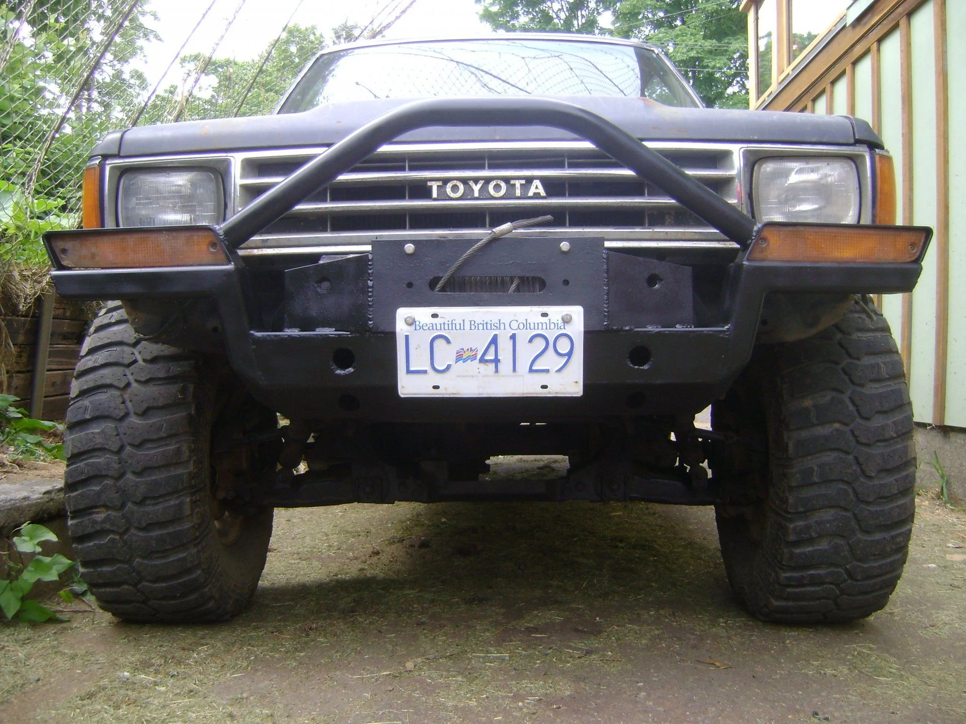

The tube bender is fairly easy to use. 5 degrees for each pump on the bender. then you switch to the next ratchet and repeat.

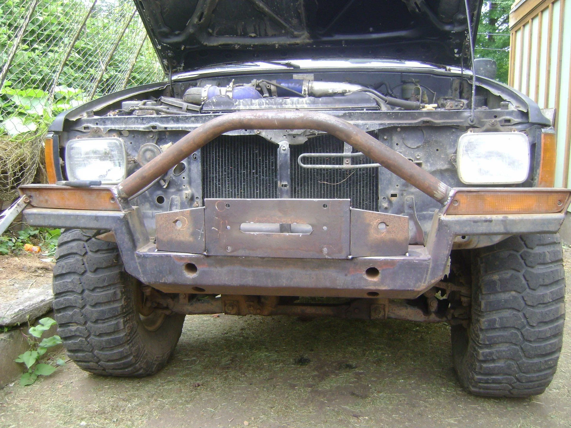

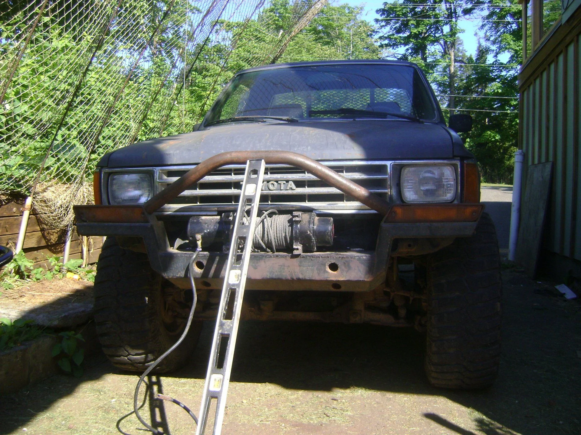

It was kind of a fly by design. I havn't hook up the electrical or nor do I have fair lead. Nothing I do is ever perfect but I think its a decent job.
Time for a test drive.
very nice. just read thru the whole thread, love it. always loved these little hilux's. and that turbo setup is sweet
Its not easy to build something like that with symmetry. Its looks even and follows the body lines well. Good job. Now all its needs is some chrome! Chrome all the things!

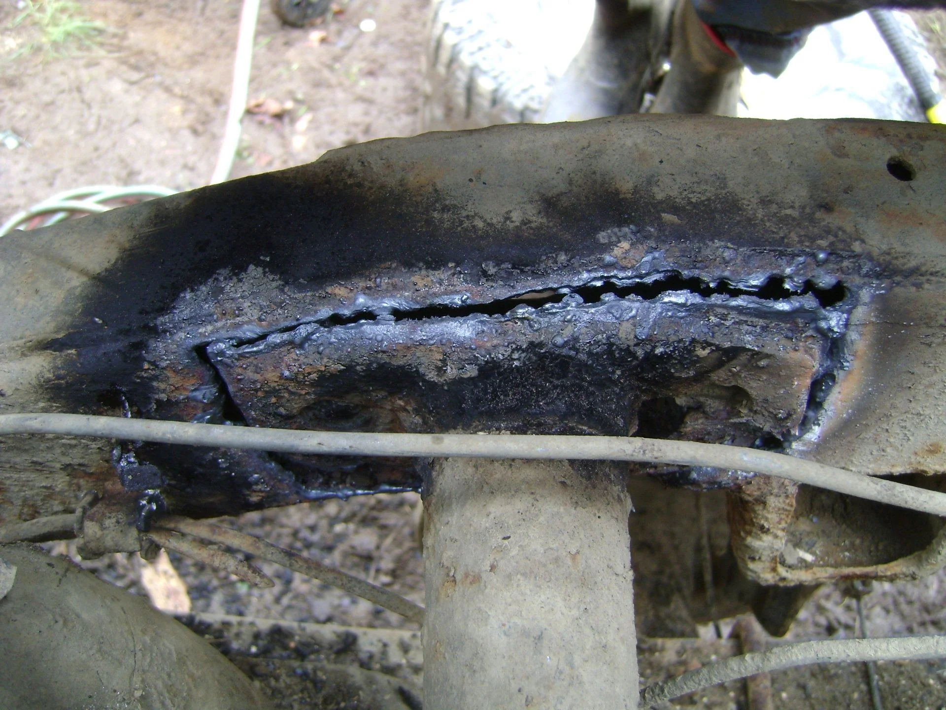

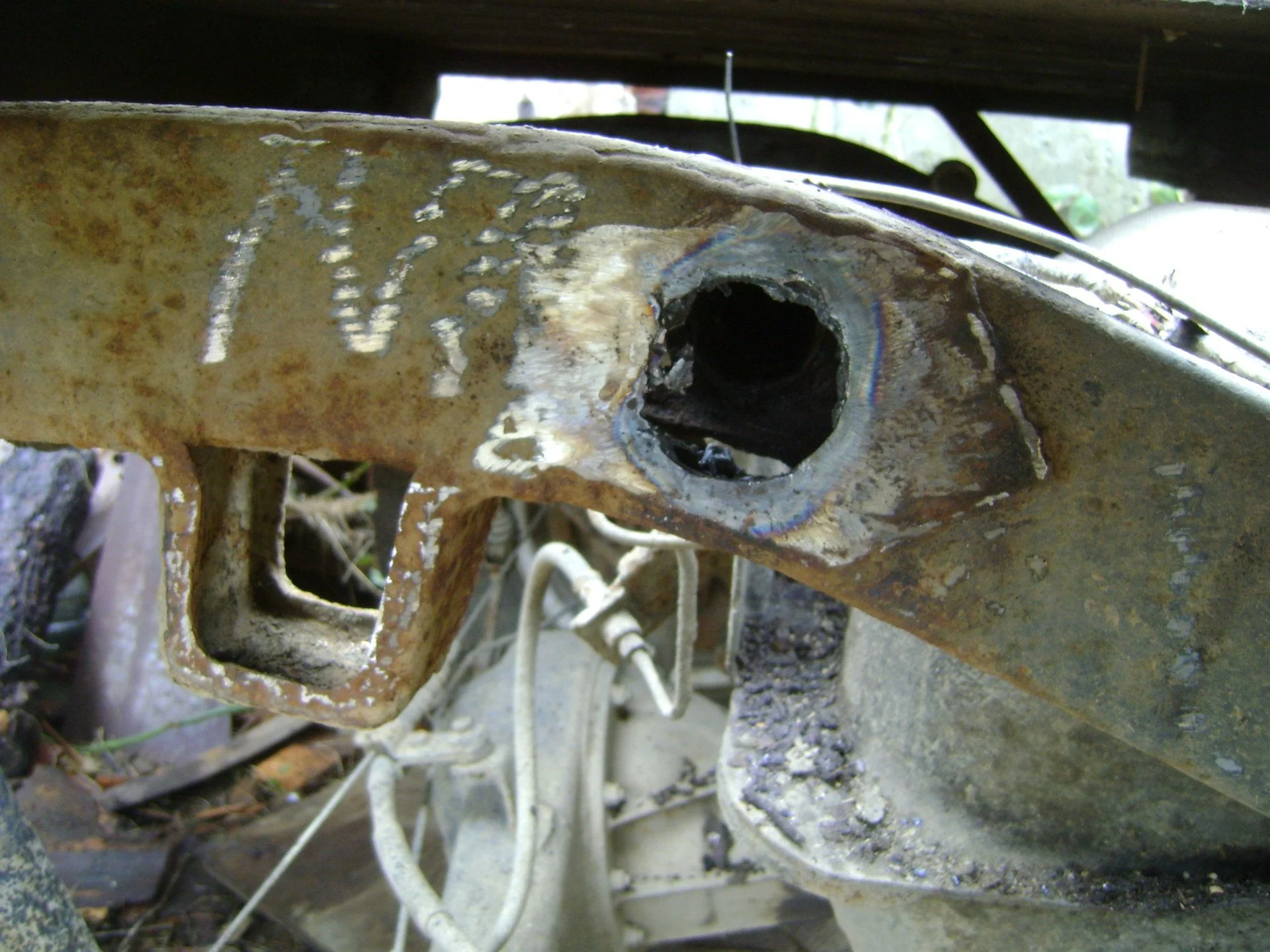

What I really need to do is to cut off this pita rusty azz frame and make the whiole rear section but I am gluten for punishement and chasing the rust again. Story of my life.

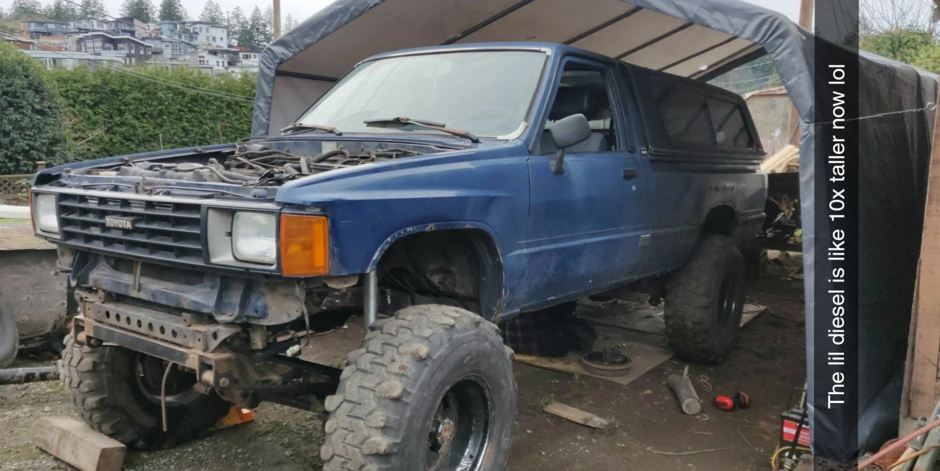

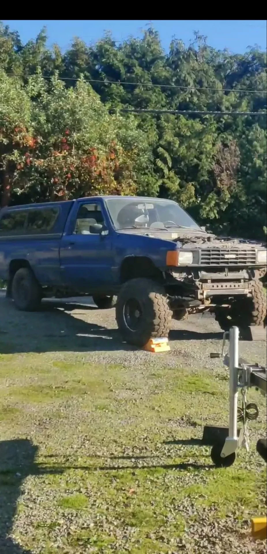

I want to open up chat in this thread again. I know it's been 4 years but you care to indulge me with your great ideas? I live in Duncan, have myself a minty 2wd little 86 Hilux diesel. Was a 2 wd that I solid axle swapped and a turbo is coming up next!

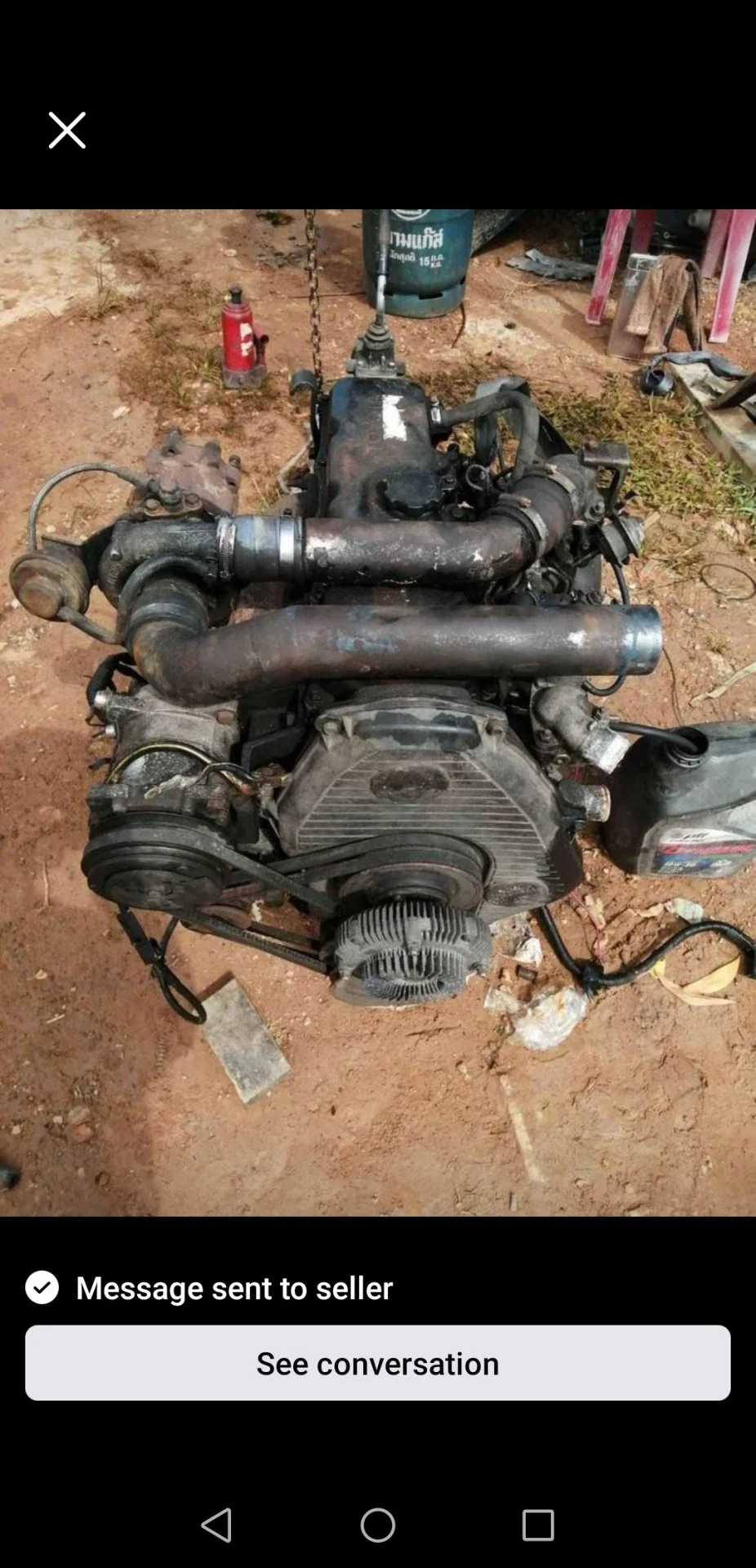

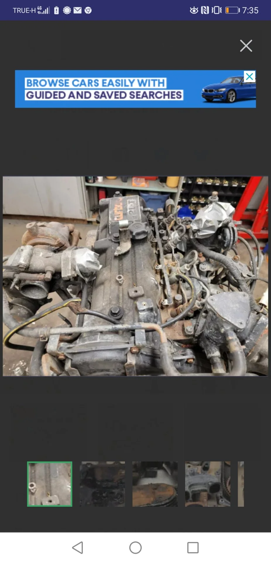

1st pic is of the engine that been disassembled in Kamloops. Second is the engine available in Thailand. I am excited for this build so I can spin some tires. I expect I may need some new injectors to really get the fuel where it needs to Be.... An inline pump is what you used after the fuel tank? And before the IP?? Any idea the GPH
