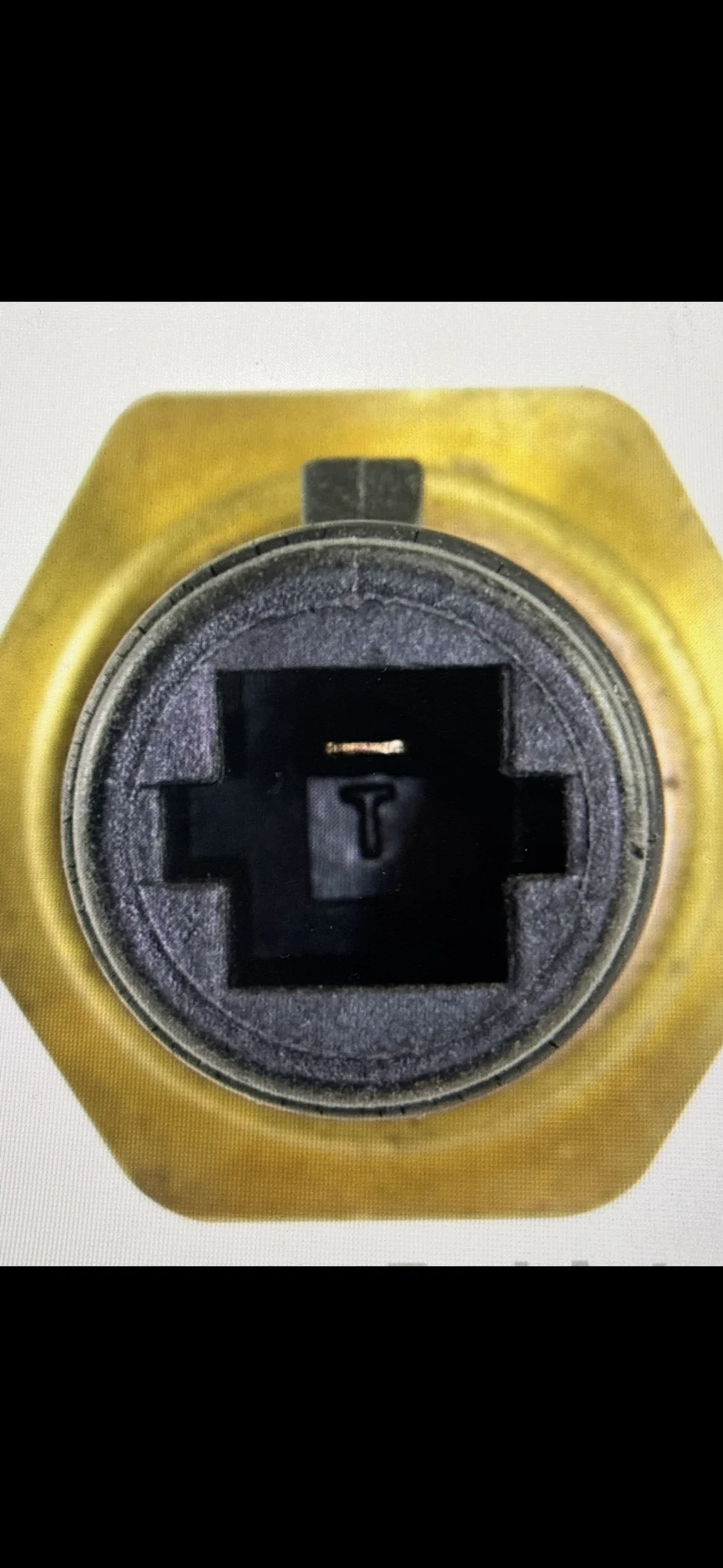

So, I noticed some of the sensors plastic connectors are loose with tight terminals but test ok. Another has both a loose housing and terminal. I wonder if these can work intermittently.

So that one has a loose connector housing in the sensor but tight terminals. It tests good. I might replace it anyway since I’m wondering if it is working intermittently with the loose housing.
Anyone know how to get the connector for Temperature Sensor #2?
