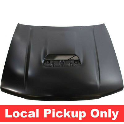

Blue cruiser Is there an actual part you recommend?
No, but I’m sure a guy like you could make something. No one is going to look at your hood anyway when they see all that shiny 3-link hardware. Aren’t you in AZ where it never rains? Just cut a hole and leave it…
That's too funny. And true. I was hoping you had an off the shelf item. I'll figure something out.
I still might put in a body spacer. 🤔 It's challenging to hack up a truck AND keep it "looking" stock......ish.
I don’t think your linked crawler on 37s is going to fool anybody into thinking it’s stockish.
Guy with an FJC bought an (aftermarket) 3rd Gen 4Runner hood, cut the bulge out, and integrated it into the FJC hood.
Some scoops cost more than that hood. Hey I'm open to ideas. I have PLENTY of time to figure it out.
And I said stock ISH. 😂 What I mean is not a truggy I guess. You'll know it's a Toyota pickup when you look at it. A Badass one though 😉
