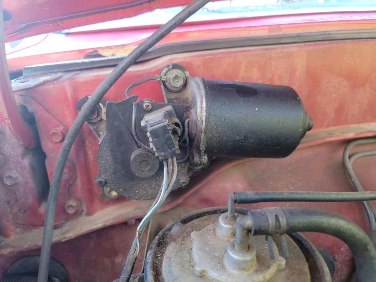

Trying to fix my wipers they sometimes work In high speed, i looked behind both kick panels and under the column no relays. im wonder if they realy is built into the wiper motor?

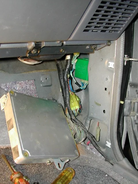

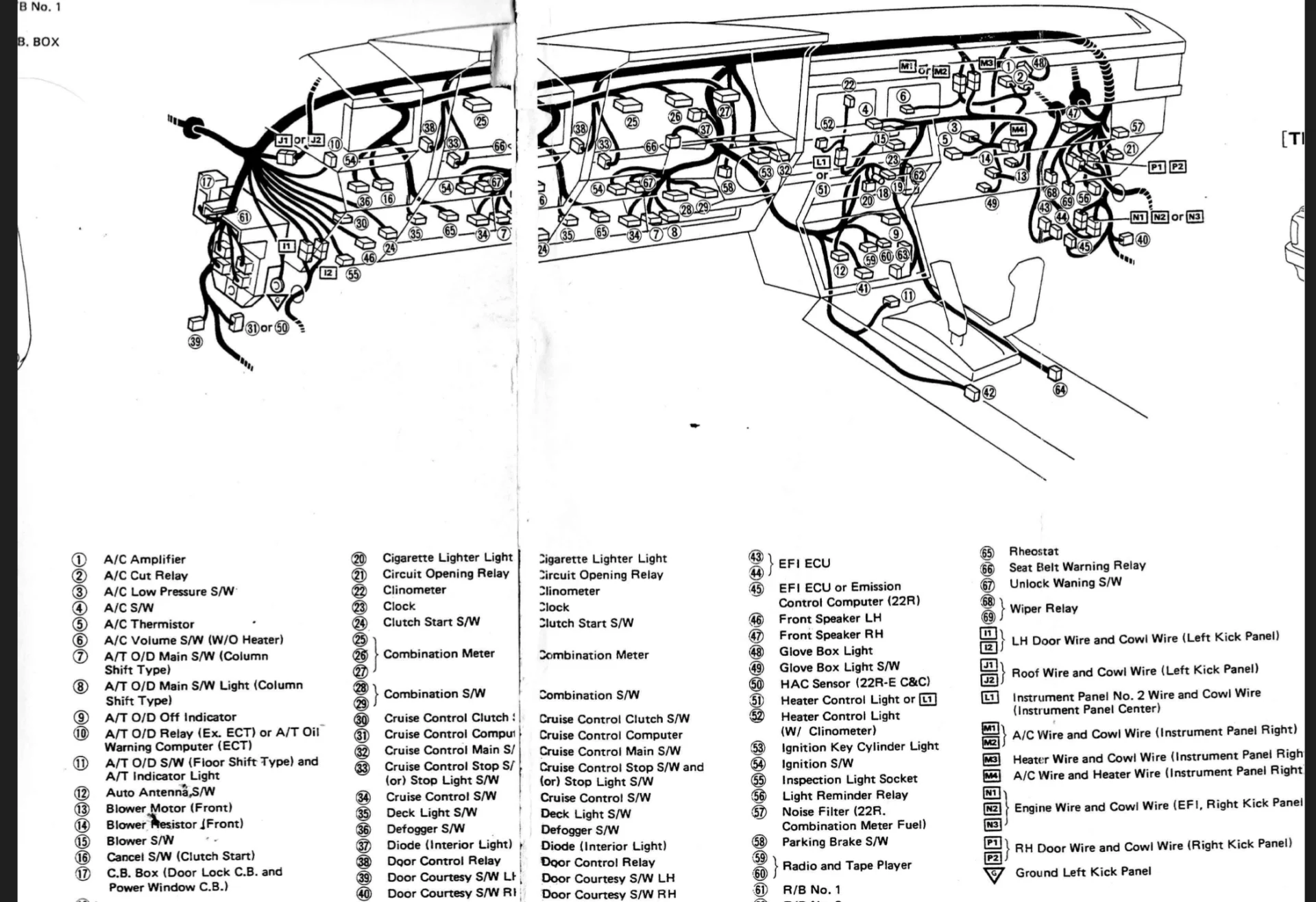

Its under/behind the ecu
Do you have intermittent wipers? If so, the relay is where gnob said. Behind the ECU, green box.

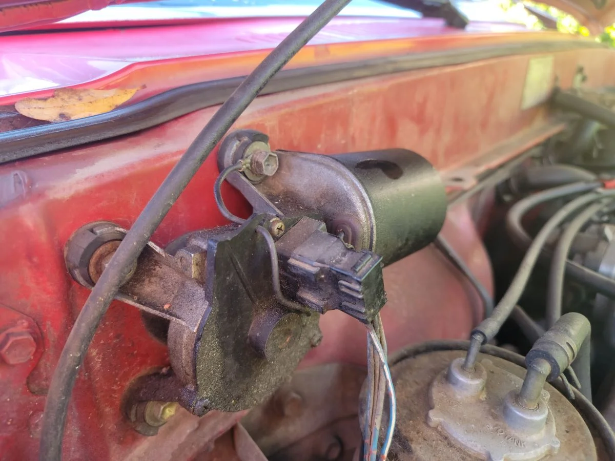

cleaned the plug up still nothing. i tested the plug with my multimeter and get voltage just not the motor . do you think that motor is bad?
