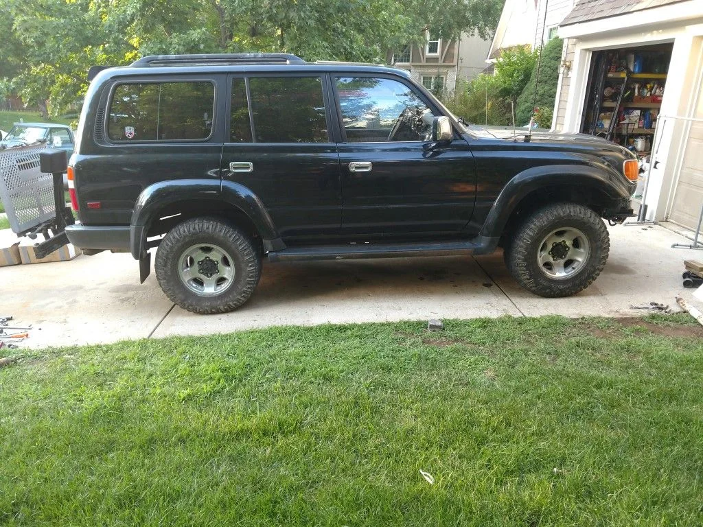

Finally got around to installing the lift I bought 9 months ago......
2.5" OME Heavies
OME 850's in front
OME 863's in rear
OME Nitro 60070 shocks in front
OME Nitro 60020 shocks in rear
It took me about 8.5 hours by myself in the driveway where it sits. The rear was 6 hours but included time to drill and tap one bolt that broke off for installing a new bump stop and about an hour's worth of drilling for a bolt on the main bumpstop inside the spring until I decided to give up because the bolt was so hard. I was going to install a couple shortened bump stops to help my airbags with the lift.
I will post real after measurements in about a week when the suspension settles in a little.
I'm delighted with the ride and the lift. I am guessing about 3" of net lift due to the saggy worn out old springs. Turns out the old shocks were rusted out as well.
This is the AFTER shot.
I have a Badlands 12K winch on the front and 4 OR lights, and no bumper. I don't have a lot of stinkbug in this picture because I'm always carrying a lot of stuff in the rear. I also have a wheelchair lift on the back. Since I've installed these springs, I don't NEED to use the airbags I have installed in the rear springs.
After about 5K miles, the ride has really improved and feels more stable and smooth. I still need to install all new suspension bushings to tighten things up even more.
I think the 850J in front will be too much and it will have the front end nose up. Maybe just the 850 in front.
My net lift from the original sagging suspension (where it was....) ended up at 3-7/16". (Not over stock, just over the old worn-out saggy springs)

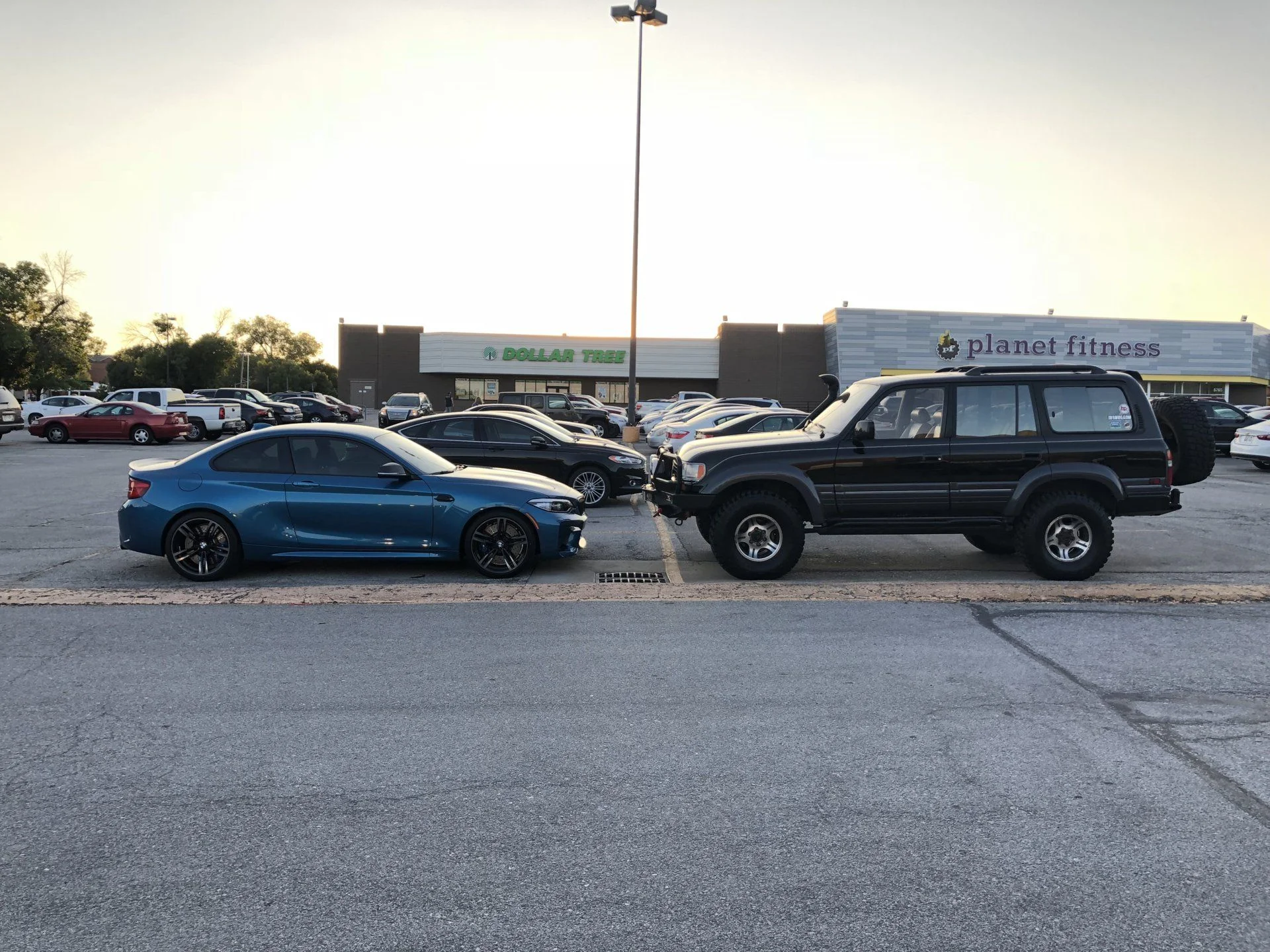

What's in the back right now? I ran 850Js in front with 860s in back for years and was unhappy with how it sat, it was still stinkbug. So I went with 865s in back to bring the rear down. I keep my truck pretty unloaded, so depending on what you already have in back, I bet 150 pounds on Js will probably be fairly level.
The thing with these trucks is everybody takes measurements to the fender, and I think it throws people off. My truck is two-toned and you can clearly see that the front wheel opening is higher up on the body than the rear. So when you measure to the fenders, and you're coming up even, you're actually stinkbug. That said, when actually level, visually it might look like you are higher in front.
Phil's shot (sweet truck Phil!) is a perfect example to illustrate this.
And for reference, here's mine with 850J front, 865 rear. Pretty unloaded, stock bumpers, no third row.
