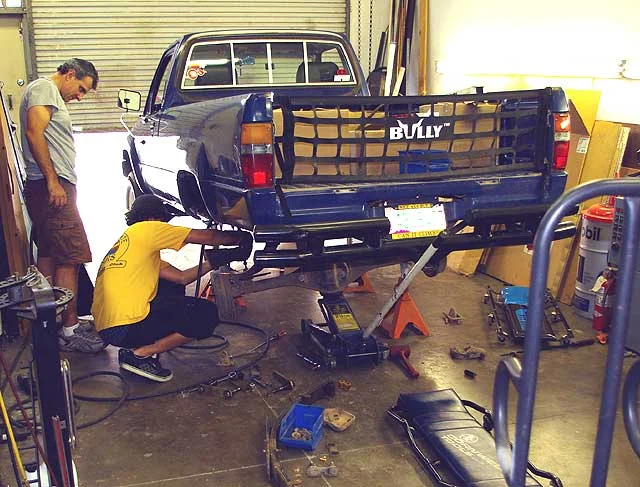

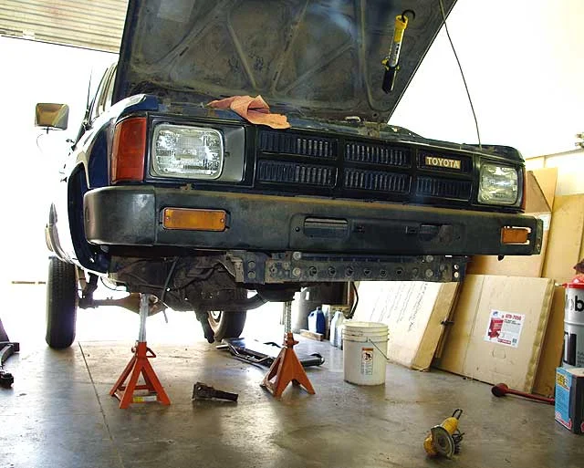

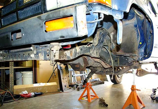

Juan's (lexycrzy) son Diego got a mini and they did some work on here at the shop. Only shot a few pix;
The victim and work starting on the rear.

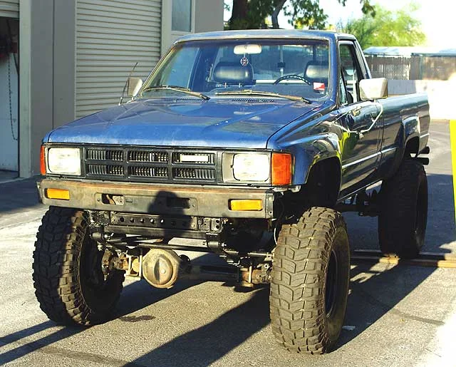

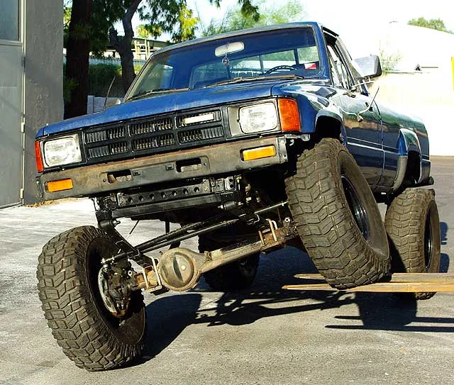

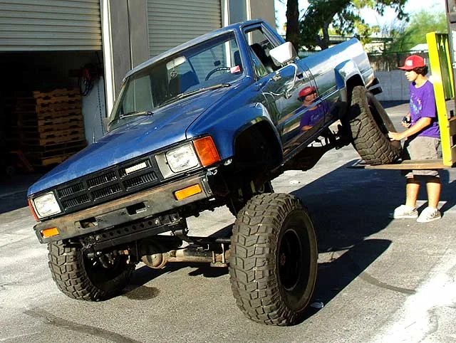

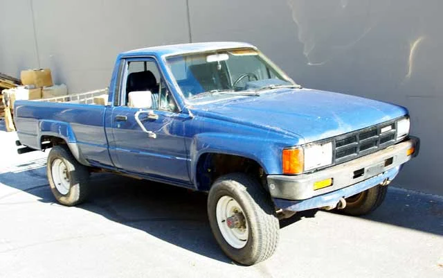

Stuck the parts back where it looked like they belong and it works!:eek: Still needs some minor stuff, front drive shaft, bump stops, front shocks, but it's close to wheeling. I think it looks :cool:!

Howdy! Looks good to me. So, what tires, what lift? Your just teasin us without any numbers. John

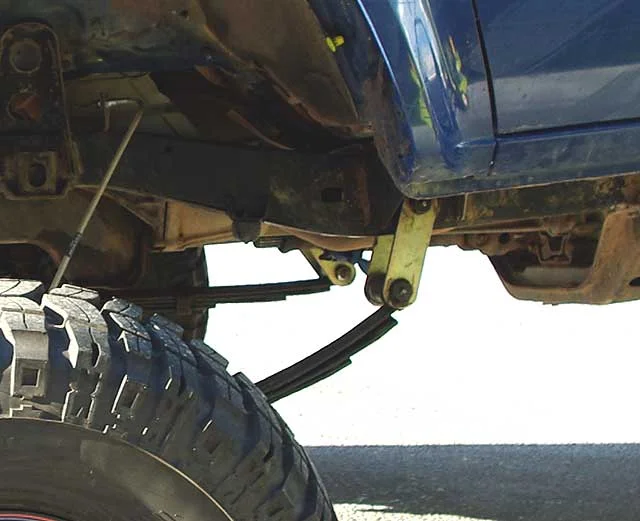

It's a collection of parts, most from Craig's List and All Pro. The CL stuff; 35x12.5 Pro Comps on 15x8" 2" backspace rims, modified Ruff Country rear springs, All Pro front springs, all of the spring hardware. New from All Pro; the spring hanger, hi-steer kit, IFS steering box mount kit, shock hoops and brake lines. Not sure where the IFS box, etc, came from or the specs on the springs.
We got lucky, nailed the shackle angle on the first try!:hillbilly:

Howdy! Still cool. We originally did 3" body and 4" suspension lift on mine. It would still rub on the rear of the front fenderwell when it was flexed hard and steered to that side. My sond decided to go with 5.29's and a detroit in the rear, which makes it pretty streetable with the stock power. John

5.29's and 35's, if so how does it drive, he has 4.88's and I'm thinking that swapping them for 5.29's maybe better? This setup moved the axle ~2" forward, so it doesn't look like tire to firewall rubbing is going to be much of an issue?
