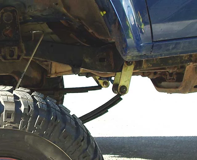

Made a "last second" quick run out to the coves this morning to test the mini. Found a few small issues, the clutch master is leaking, we missed on the front bump stops, they need to be lengthened and the front fender wells need some sawzall/BFH love!:hillbilly: Overall it worked very well and Diego did a great job driving it!:cool:
It flexes well, I was impressed with how well it climbs even unlocked. A rear Aussie is on the way, then it will be unstoppable!:D
... All of the frame side brake line mounts were cut, moved and welded back on, to give more flex slack.
This worked well, before/after pix of the front. Will shoot a pic of the rear, it's still the stock hose and has plenty of slack.
attachment.php
Those flex pics are obviously photochopped. I mean, everyone can see that those are leaf springs.
