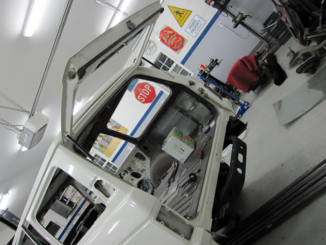

Update:
Got the hatch hung & hardware installed (waiting for a 2nd set of hands to install the tailgate):

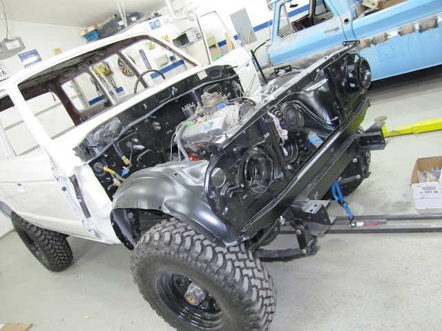

Front end is also coming together:

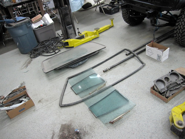

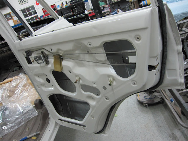

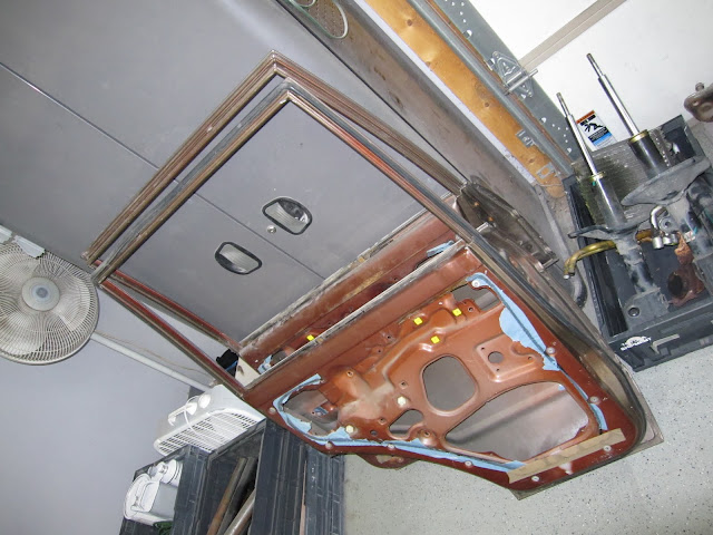

Started stripping the old doors to reassemble the "new" doors:

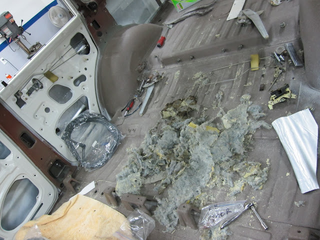

Installed sound deadening on the outer skin. I'll do the inner panel after I spray the innards with fluid film:

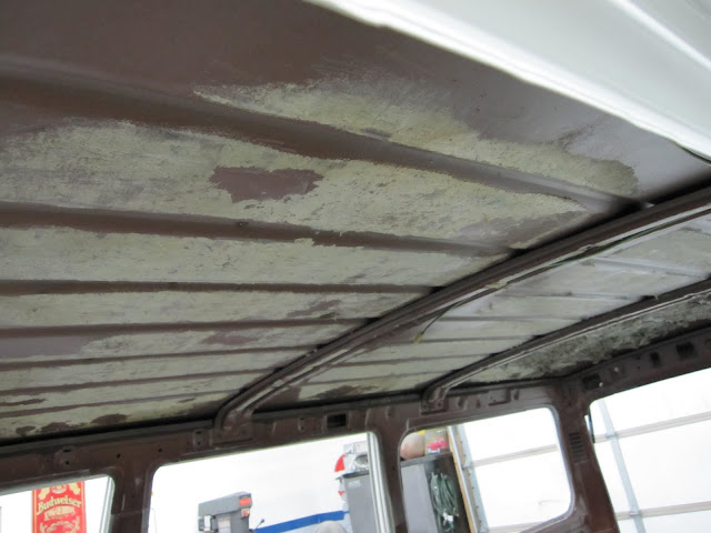

I've also been busy shearing the roof. . . PITA

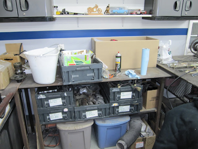

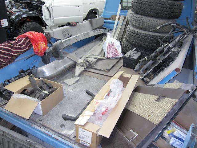

Other than that, I've been rounding up all my parts for reassembly. I had parts in the house garage, the extra bedroom, my shop,& the attic. They've now all been accounted for (I think:hhmm:):

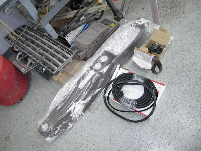

Looking good,is that a brand new dash pad from toyota?
What are you doing with the roof skinner?
No, it's one of the molded skins that covers the existing IP. I've used them before on some other trucks & they always work out pretty well.
For the roof, I've got a brand new headliner. I'll be re-insulating the roof with dynamat of something similar & then I think I'm going to install the new headliner on my own. I'll be sure to take pics.

I'll post some pics as soon as I get a chance; I've been working like crazy. I did make some progress this weekend though. All the doors are deadened. Front floor is deadened.

Excellent work. Man my(your) list of ideas keeps growing. What did you use to take all the fuzzies off the roof on the inside?? That has been an ongoing project for me. Hopefully some kind of solvent??

Skinner-on the dash cover-did you get that from $OR? Does it just 3M tape to the OE pad?
