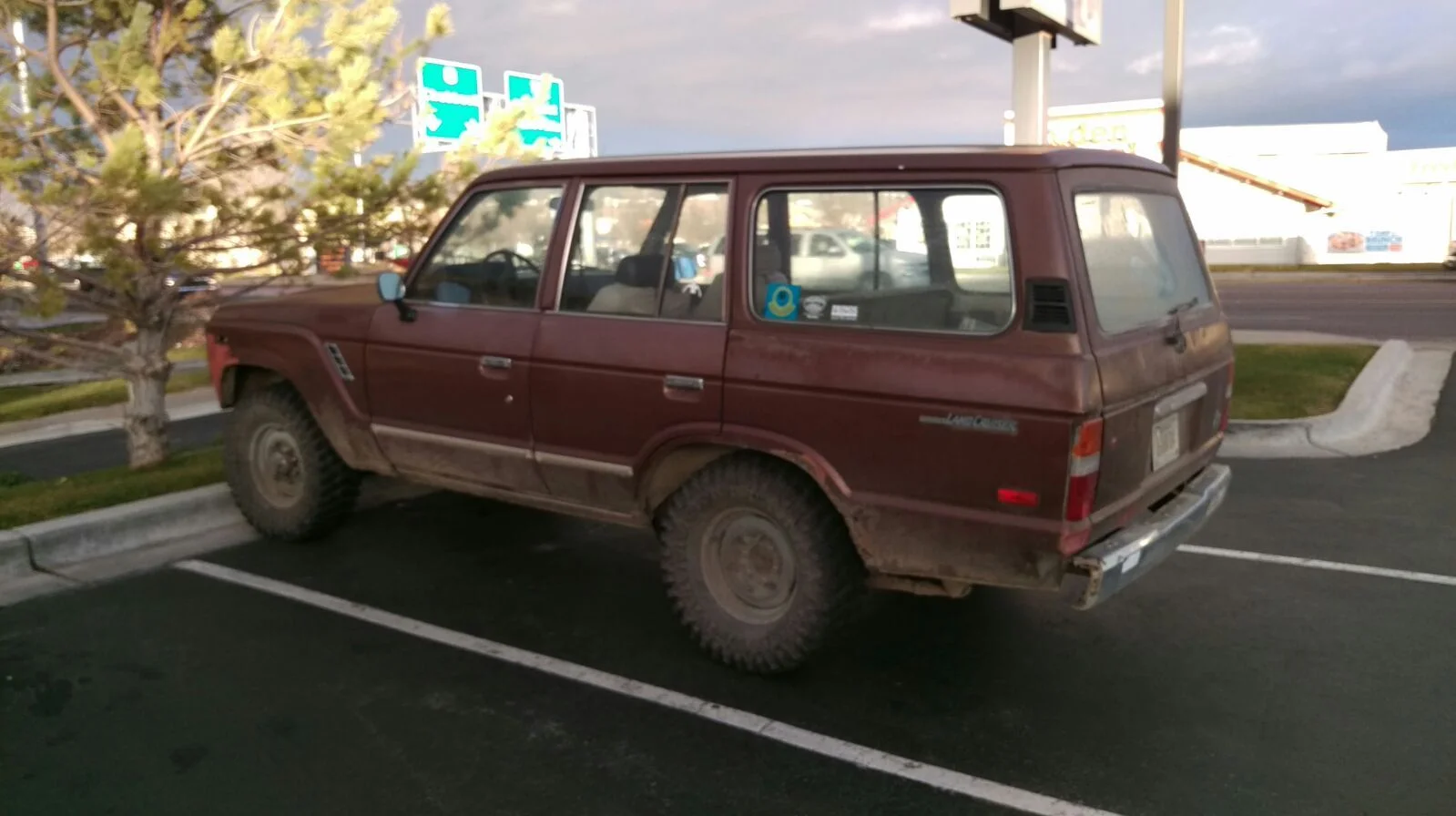

One of the newer members here, and just getting around to starting a thread on my latest project - a 1984 FJ60. I previously owned a 1990 HJ60 (while living in the Congo) and had to get my hands on another cruiser when we moved back state-side.
I found this one for a decent price considering the 4 hour drive each-way to pick it up, and the fact she only has 170K miles. The interior and headliner is in decent shape, but the body and exterior trim is going to need some work.
The first step will be to deal with the "small oil leak" coming from the oil pan gasket and somewhere else (I ended up hemorrhaging oil from Pocatello all the way back to Caldwell, stopping every 30 minutes to add a couple quarts) - ordered some parts from Cruiser Corp to start out, next step will be welding in patch panels to deal with the rust, and hopefully getting her onto a new set of OME springs.
