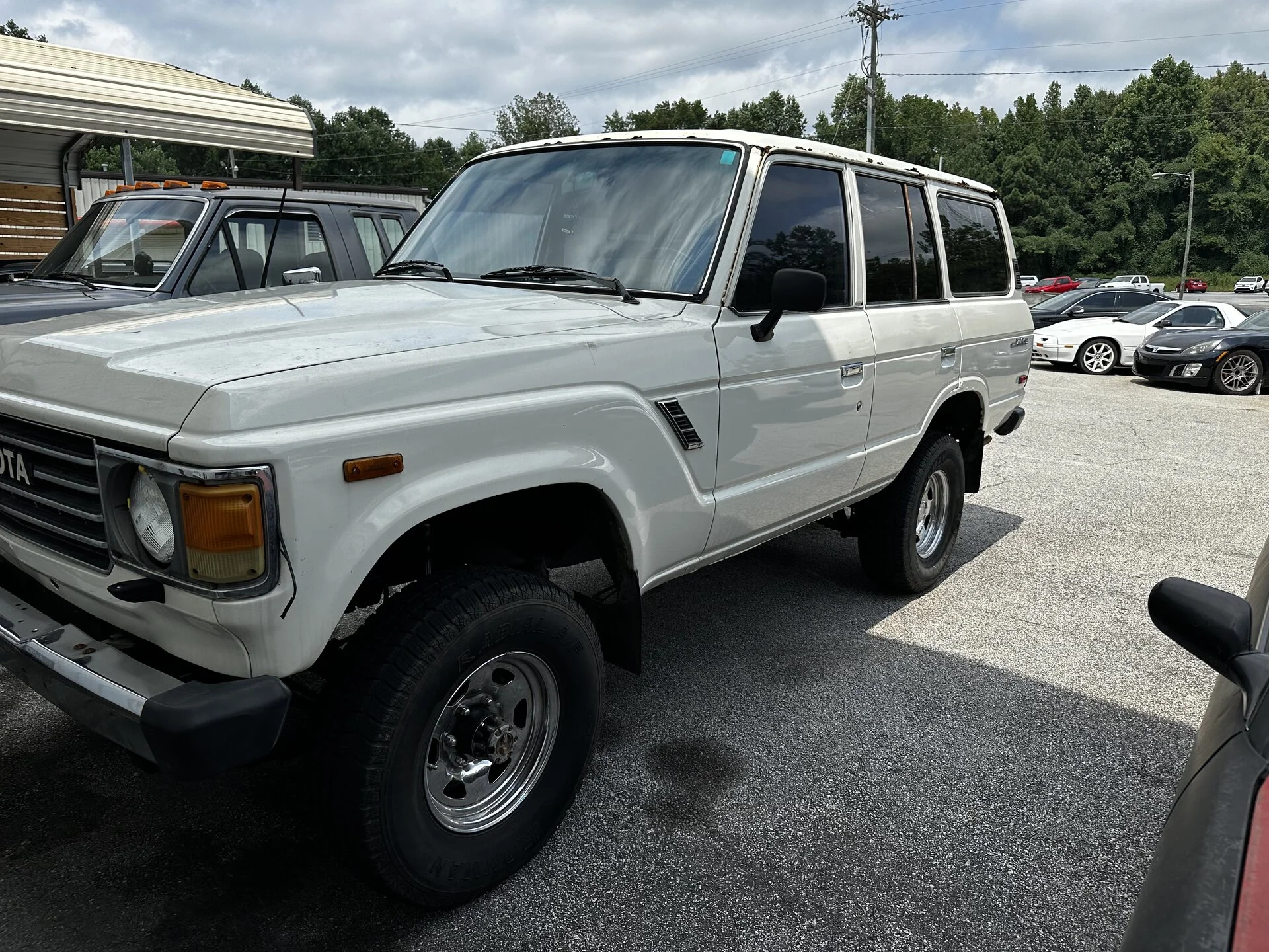

Picked up "Nick" on a Sunday afternoon in Augusta, GA, and started a 120-mile drive back to Atlanta. Made it 103 miles and totally lost the clutch and it wouldn't even hold fluid at that point. The PO told me there was a small leak in the slave cylinder and actually gave me the replacement part to install. Ended up towing it to a friend's garage that was close to where it gave up. Came back Monday, tossed on the new slave cylinder, and he's banging through all 4 gears (the reverse is a little crunchy) like nobodys business. I'll get it back to ATL this weekend, but figured I'd start this in the meantime. Came with an OME 2" and dead shocks, so it's a bit of an adventure to drive. The goal of the whole thing is to have a reasonably reliable rig with an aggressive look, front, and rear bumpers, able to get wherever and just be a little different. Catch some looks along the way, and have fun.

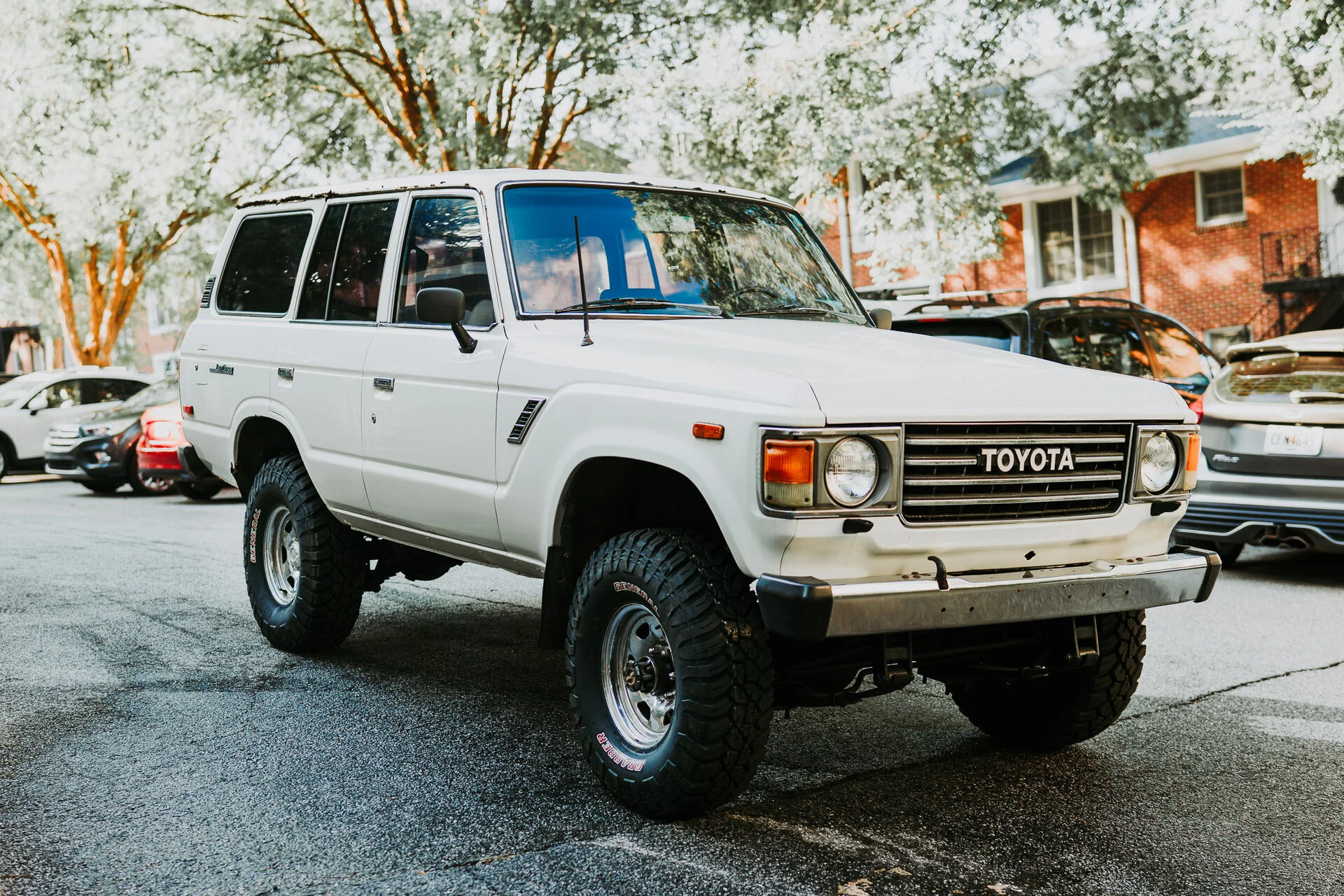

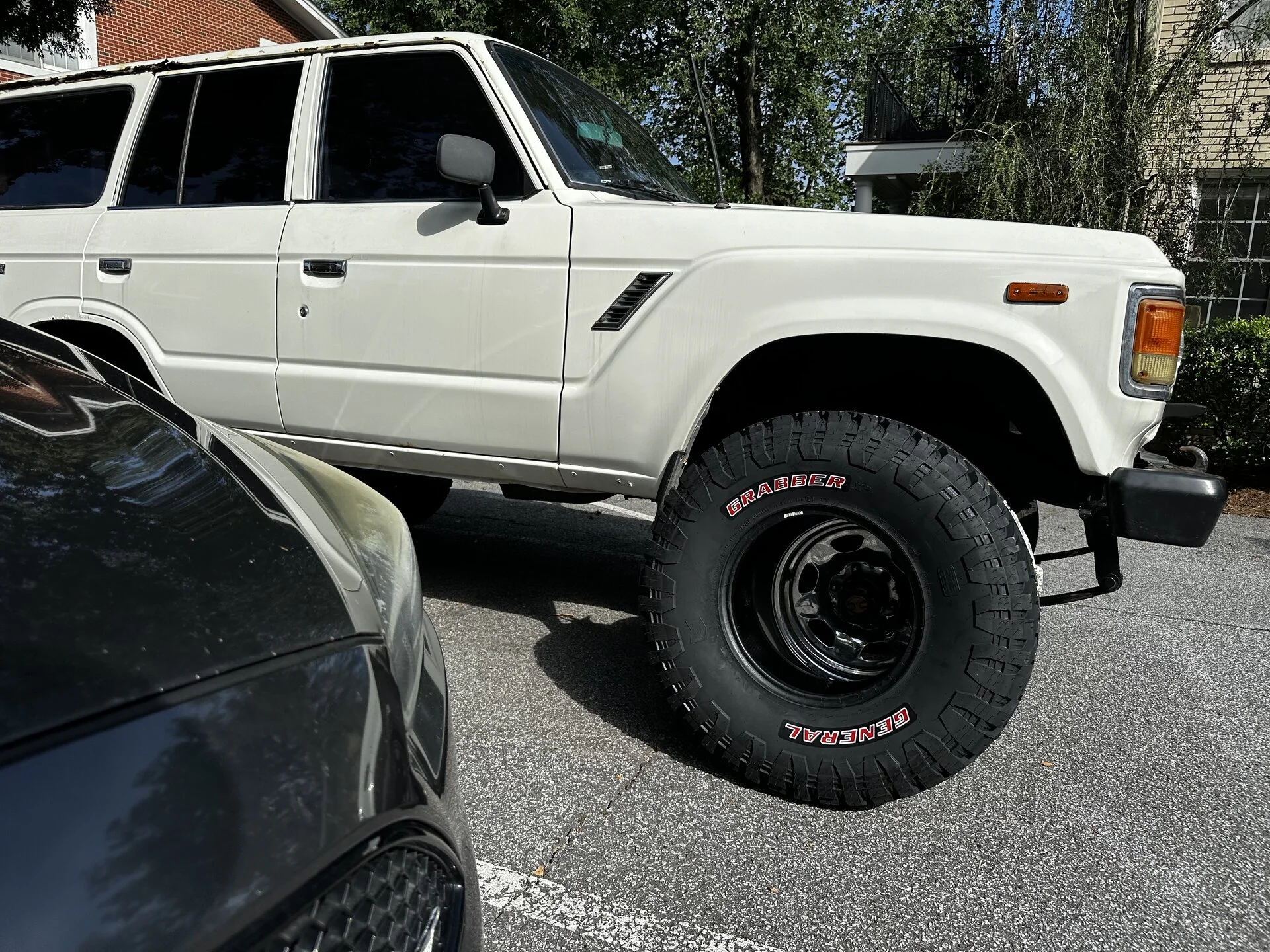

UPDATE: Went back to Covington to snag the LC, and was pleasantly surprised that the fluid level in the clutch master cylinder reservoir was right where I left it, so the major leak was sorted out by replacing the slave. Good news. Got it back to ATL without any drama, aside from every time I hit a hole or an offset portion of pavement I have to death grip the wheel or the thing tries to go off in whatever direction it pleases. I managed to score some 33x10.5x15 General Grabber X3 MT tires off Facebook brand new for $750 for 5, so those will go on today I think, if my wife is willing to let me mess up the schedule in her head for the weekend lol. Lastly, I pulled off one of the shocks that look as old as I am (which is younger than the vehicle) so I ordered all 4 replacements from OME and the steering stabilizer from 4wp. I did notice a super slight oil leak coming from what looks like the pan or the RMS, so that'll get identified soon. I'd like to pressure wash the whole underbody of the thing, and then start figuring out where stuff is dripping.
Next Up:
Install 33s
Replace shocks and steering stabilizer
Replace oil pan gasket
Replace whatever running bigger tires breaks
Start thinking about EFI...
Busy weekend! 33's went on, and my wife went for her first ride in it! She was... less enthused than I am, but is very happy I have a project lol.
Shocks should be here Wednesday, and I'll have a tag on it then as well. The immediate next step will be repairing / replacing the exhaust. Its pretty crusty.
