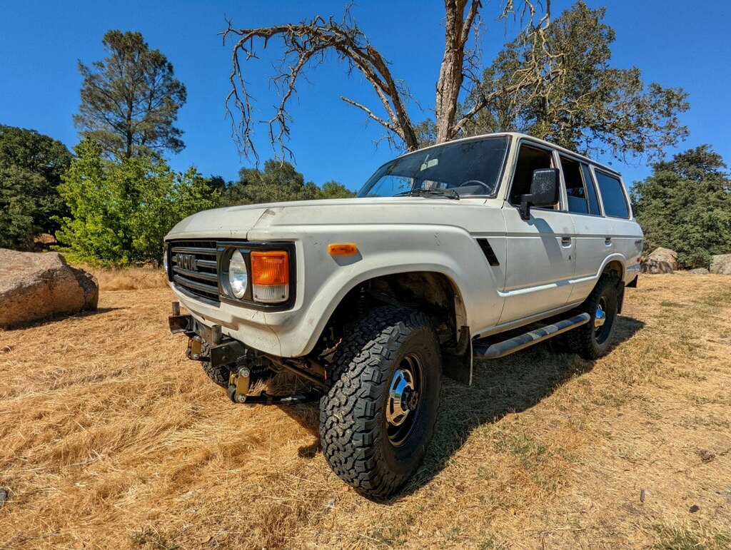

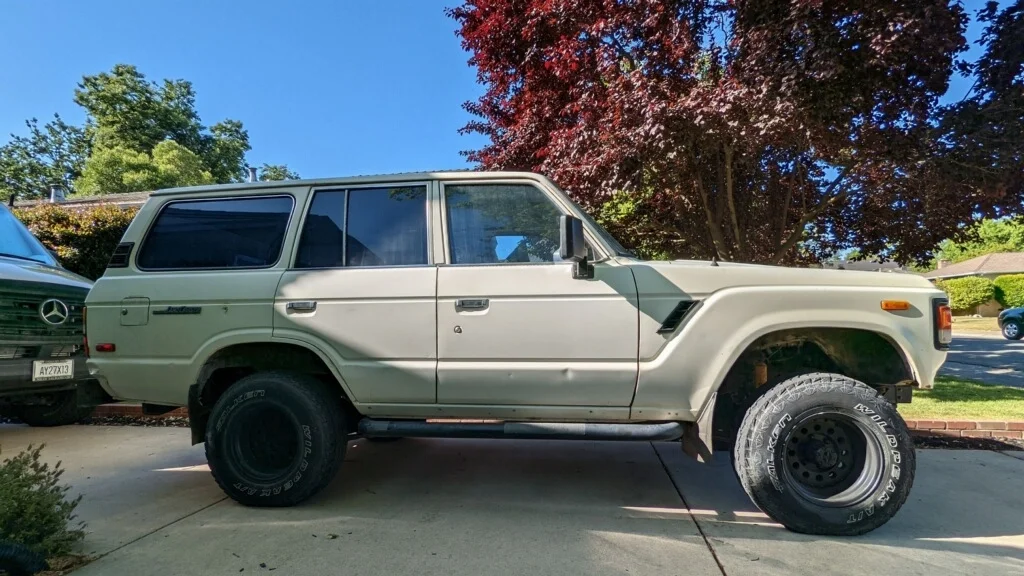

Here's a pic - Will add more pics as soon as I can get away from work for a few mins during the day.

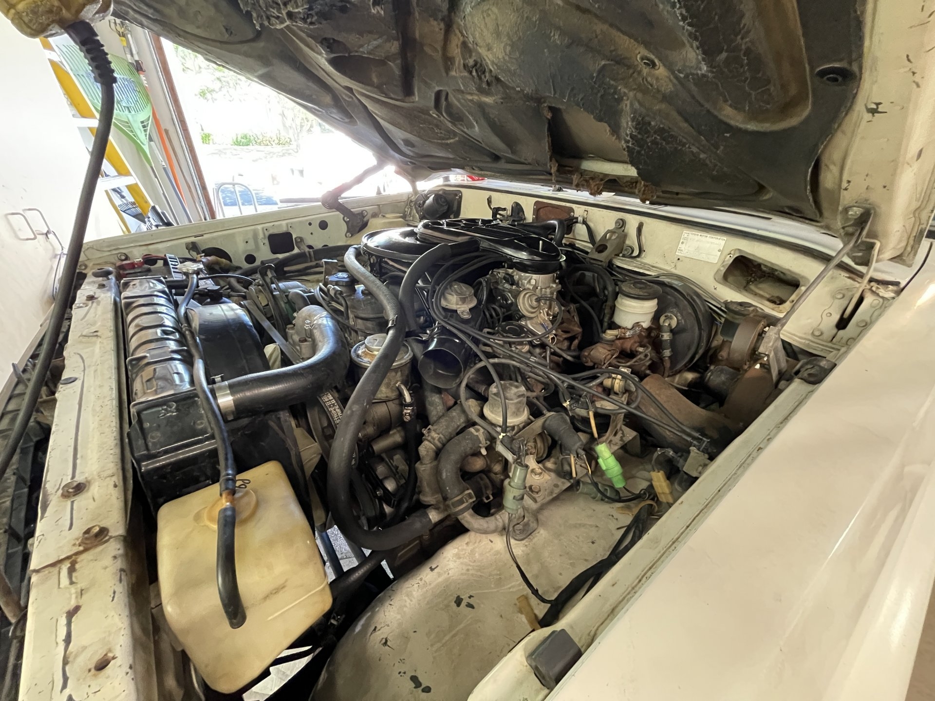

Got the Exhaust fixed for now sounds/smells a lot better but I suspect the manifold gasket or the gasket at the collector might be at least partially blown out.
Looks like she's got a little lean here.

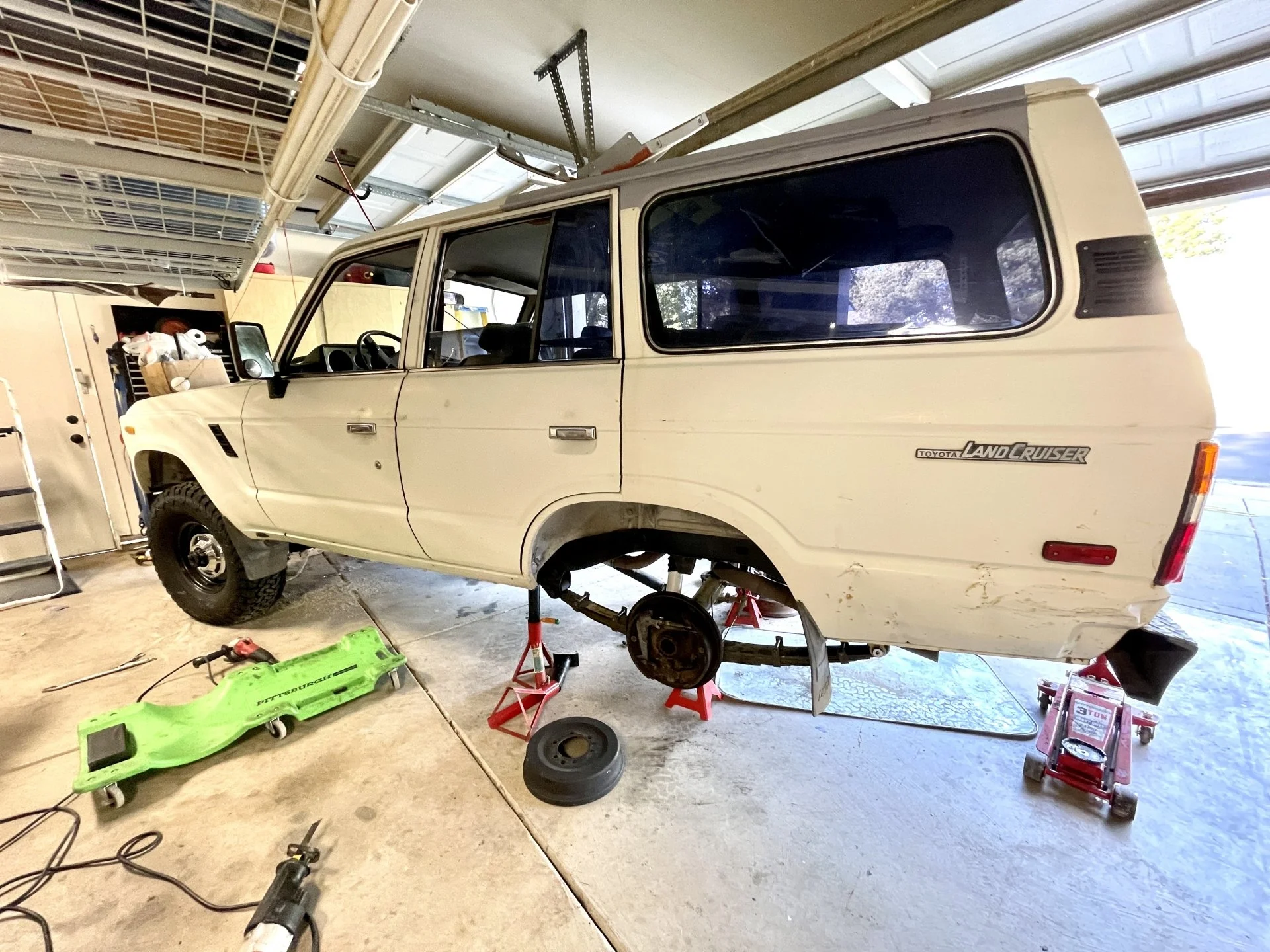

Last weekend we started on the suspension. Got all of the springs swapped out with the HFS kit. Mangled a couple of the pins so ordered from Toyota and waiting for one of them and that will be wrapped up! Looking forward to taking it for a drive. It sits nice and level now / will post some final measurements of before lift, after lift & after tires eventually.

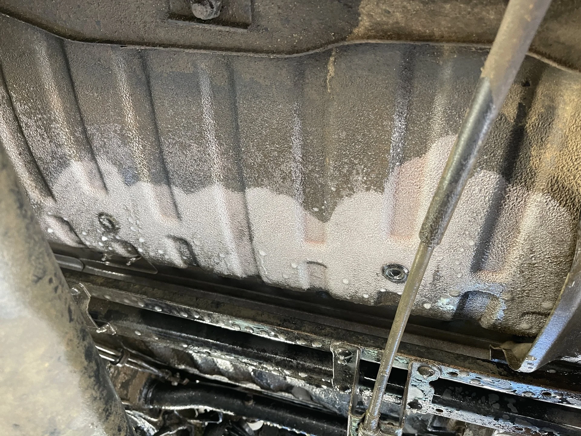

Sprayed the underside & engine bay down w/degreaser and hosed it off w a pressure washer!
Curious if this undercoating is supposed to be 033 White or Grayish - I was surprised to see it not 100% black behind all of the grime. Anyone know!? Have some more cleaning to do followed by some rust prevention etc. It’ll spend the next week drying out in the early summer heat!

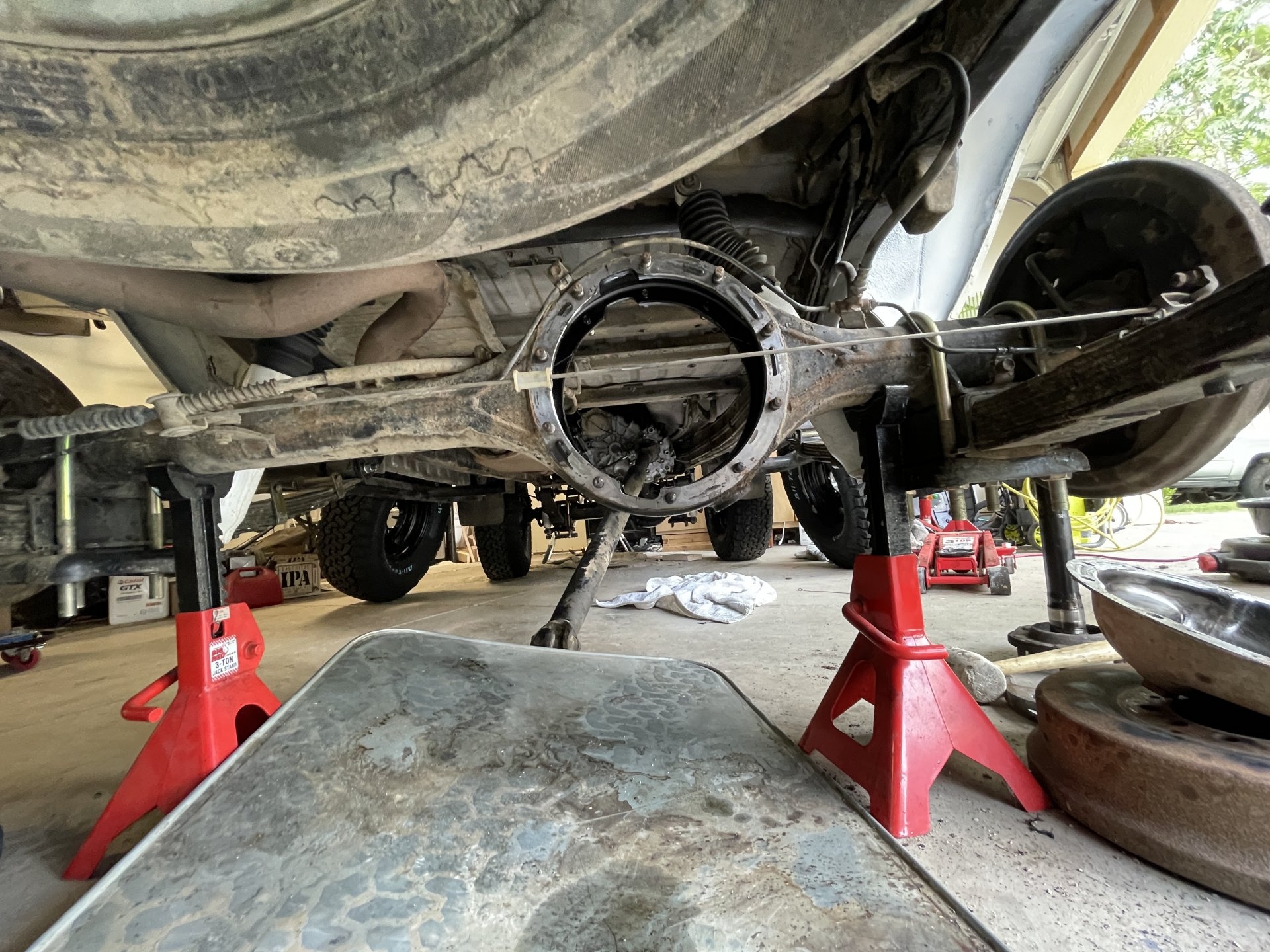

Found out the pinion bearing is pretty blown out on my rear diff so ordered that along w a new seal from Toyota. Never had a rear end apart before but Tom has so that’ll be interesting!
The plan for next weekend is to finish the tuneup/Maintenance stuff as well as the suspension and maybe try to get it smogged before tearing the rear end apart. Anything else we should do while in there?

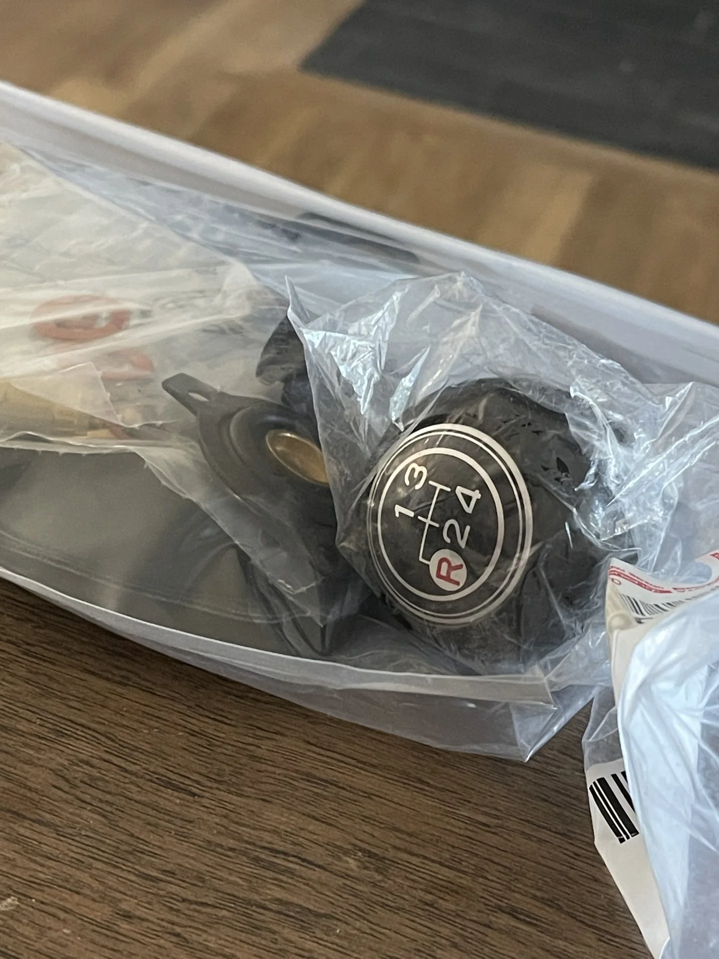

Got this OEM shifter knob in to replace the nylock nut the 60 came with - love it lol.

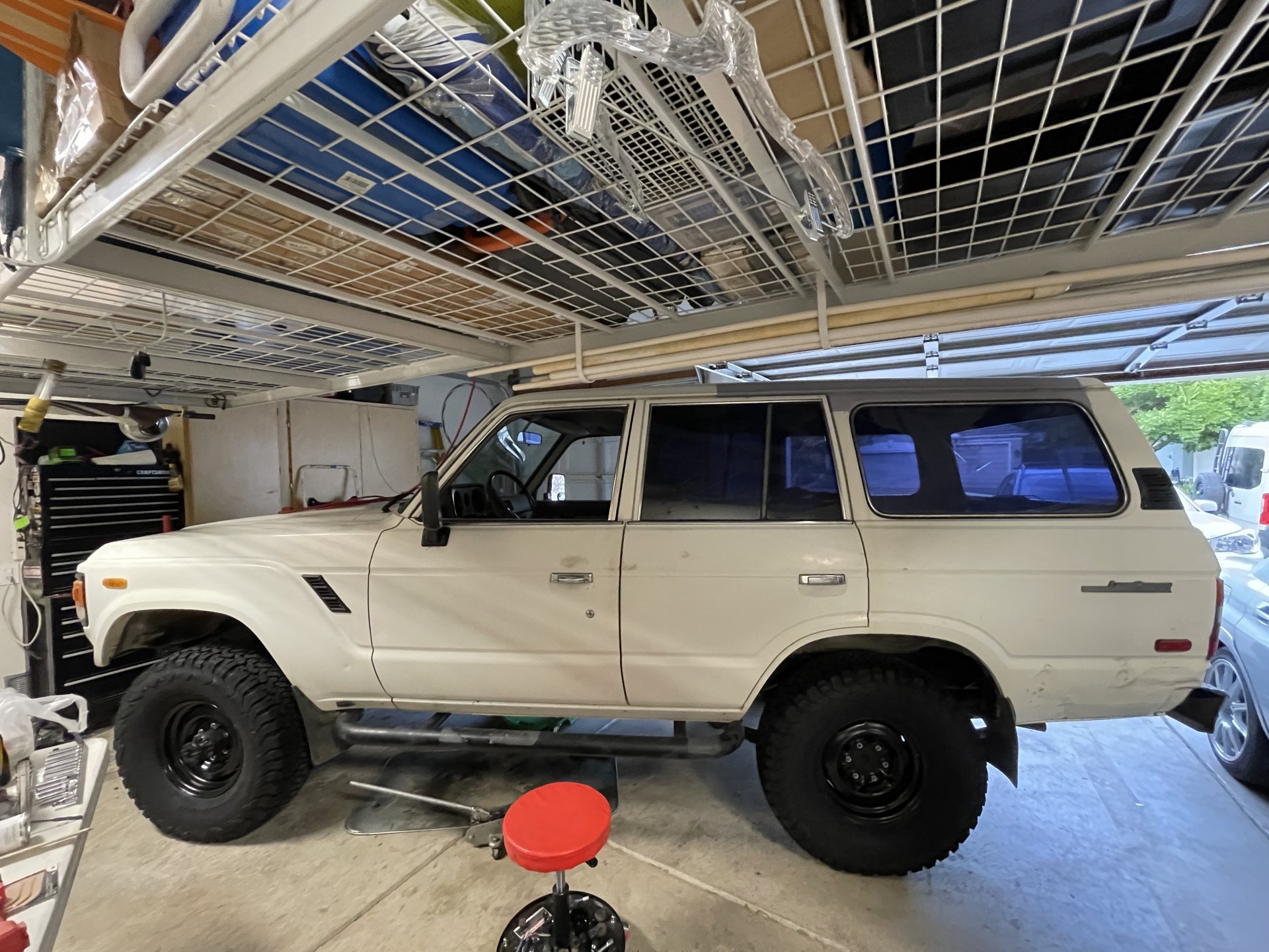

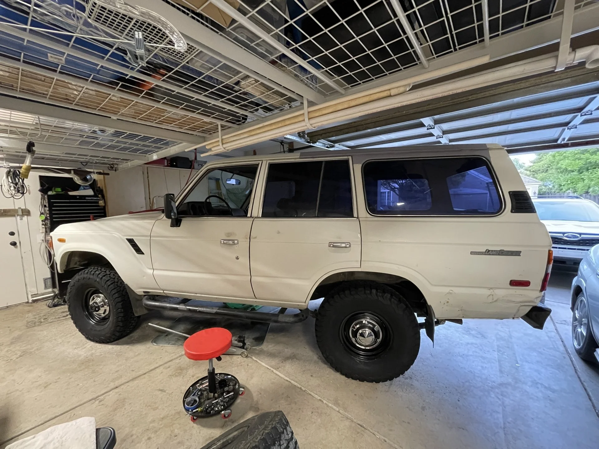

Here’s the rig after lift install. It’s sitting level left to right & I’m assuming the front is going to relax a little w the weight of the 2f…
still need to measure it, the lift didn’t bring it up too much because it had long shackles on it but the ride is definitely better!

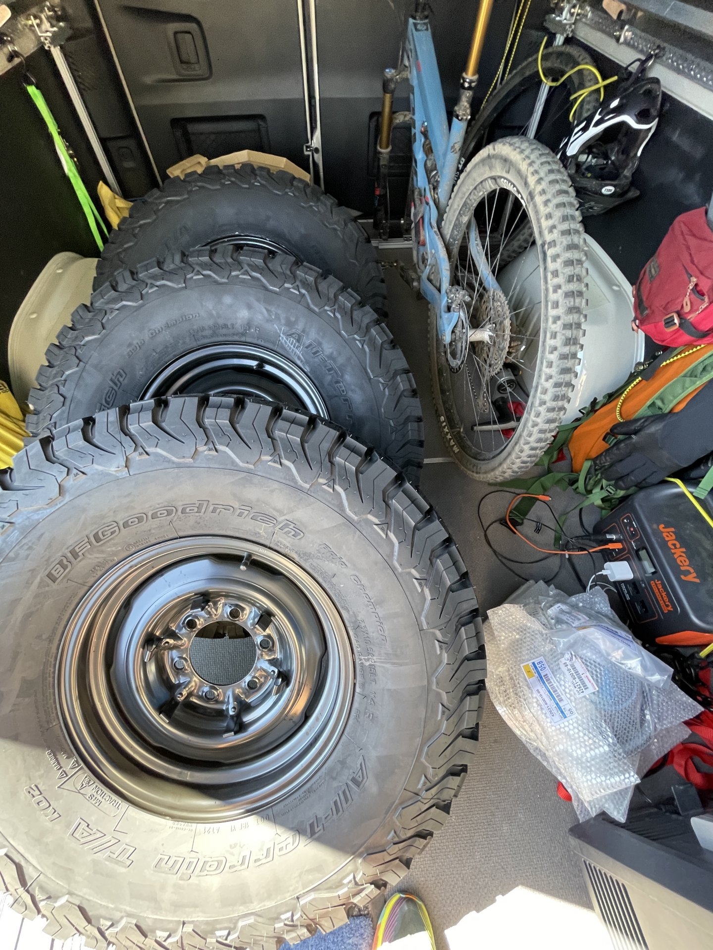

Got the new wheels and tires mounted up yesterday!
these are:
fj40 disk wheels and caps, 15x5.5
BFG 33x10.50 15
Mounted and balanced by mom and pop shop, box shops wouldn’t touch it due to the wheel width.

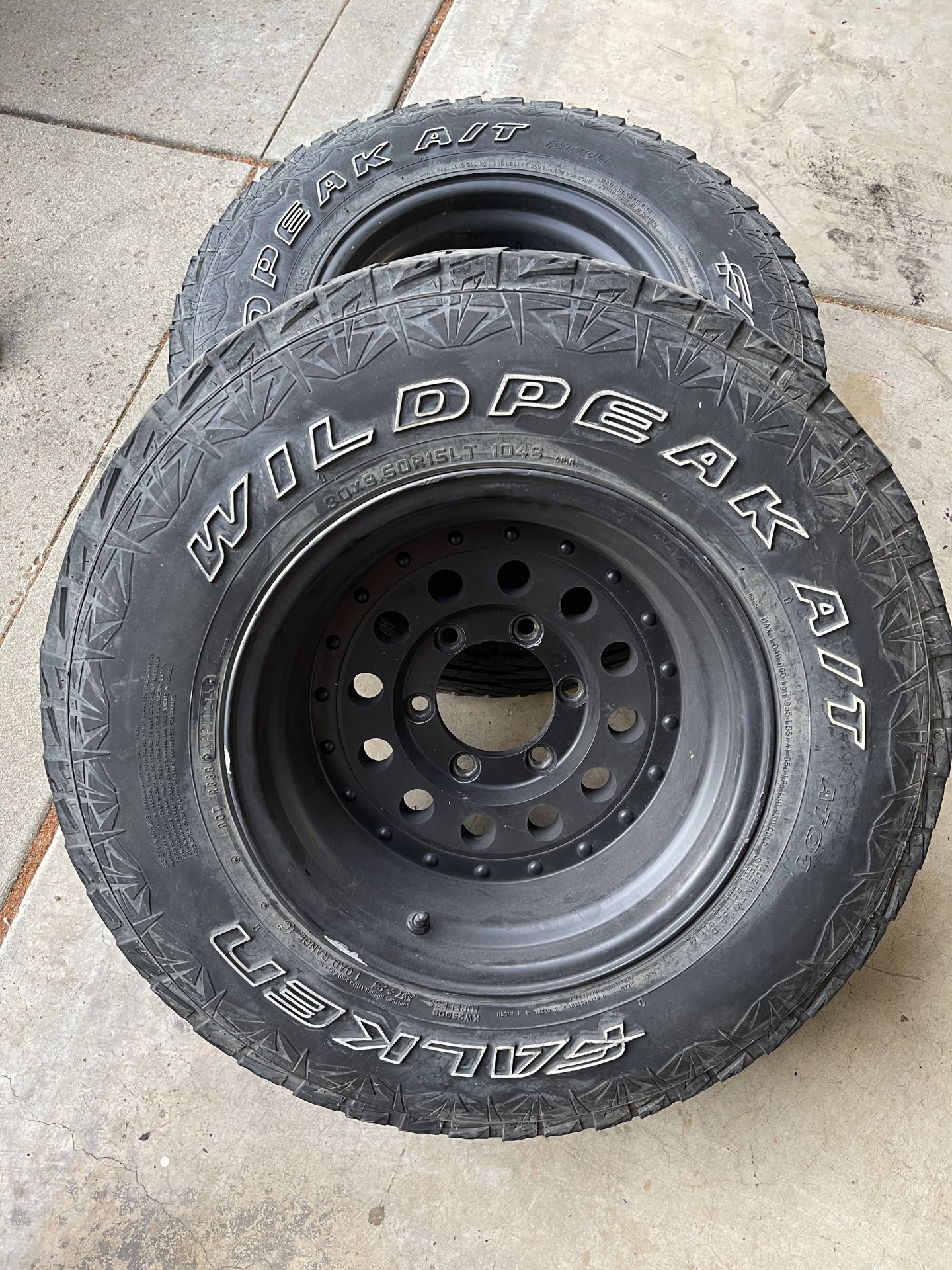

If anyone is local to Sacramento and you want some 30x9.5 on these painted aluminum wheels make me an offer…. Set of 4
I measured from the floor to the outside center bottom of the wheelwell:
Before ——> After lift+tires
Ds rear 33 3/8 ——> 37
Ds front 35 1/4 ——> 39 3/8
Ps front 37 ——-> 39 1/8
Ps rear 34 1/2 ——> 36

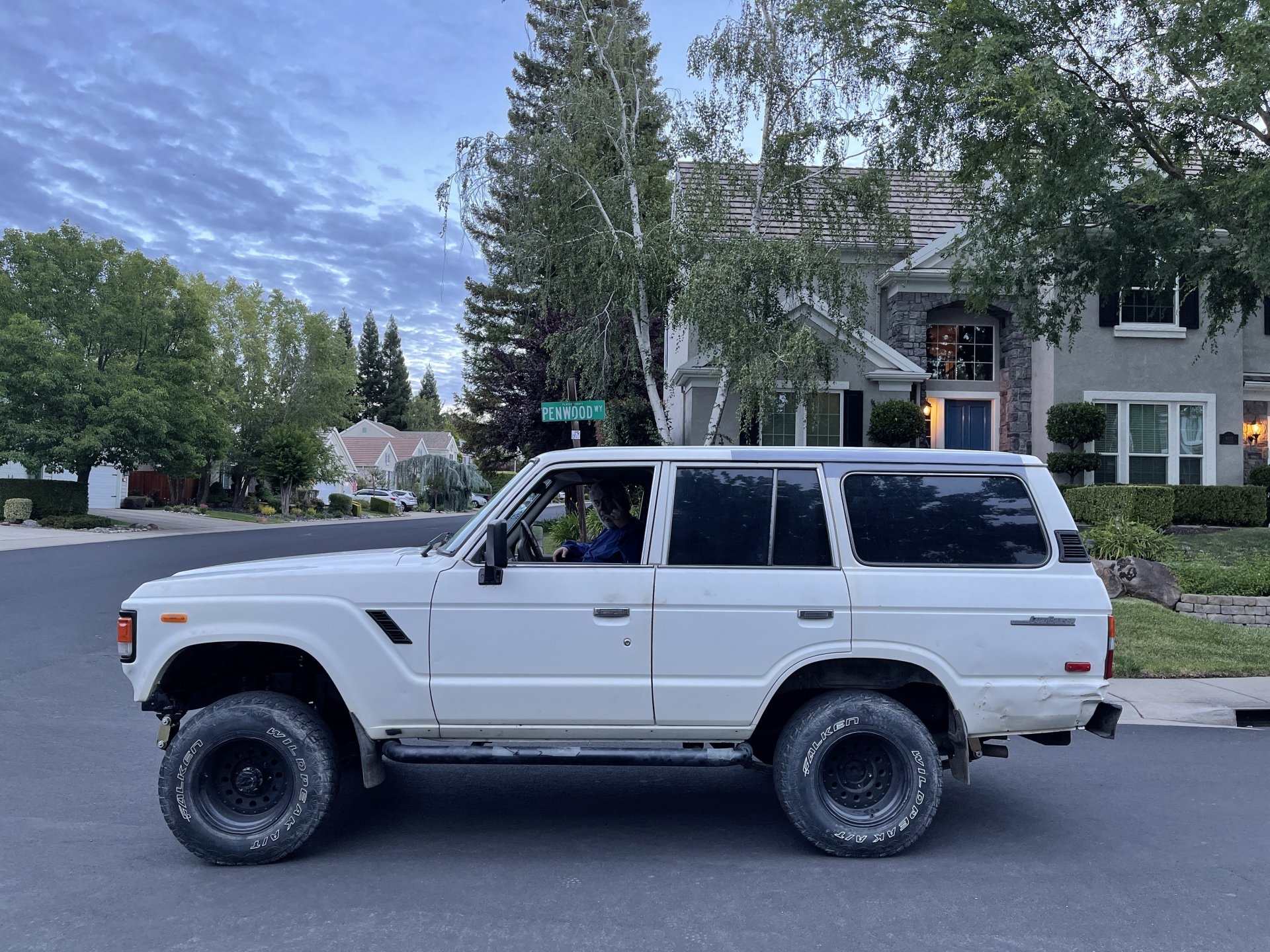

Here’s a pic before the center caps!

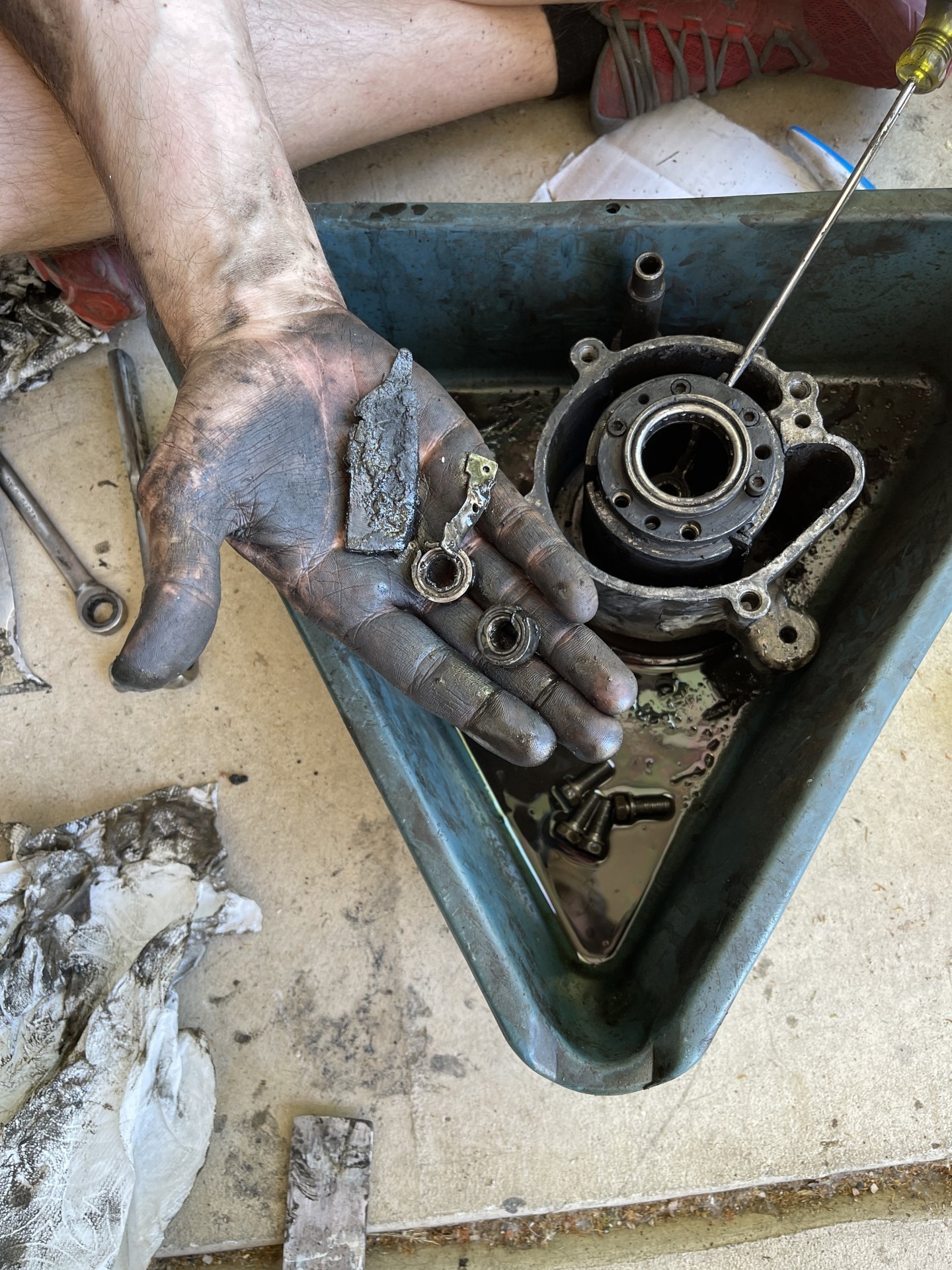

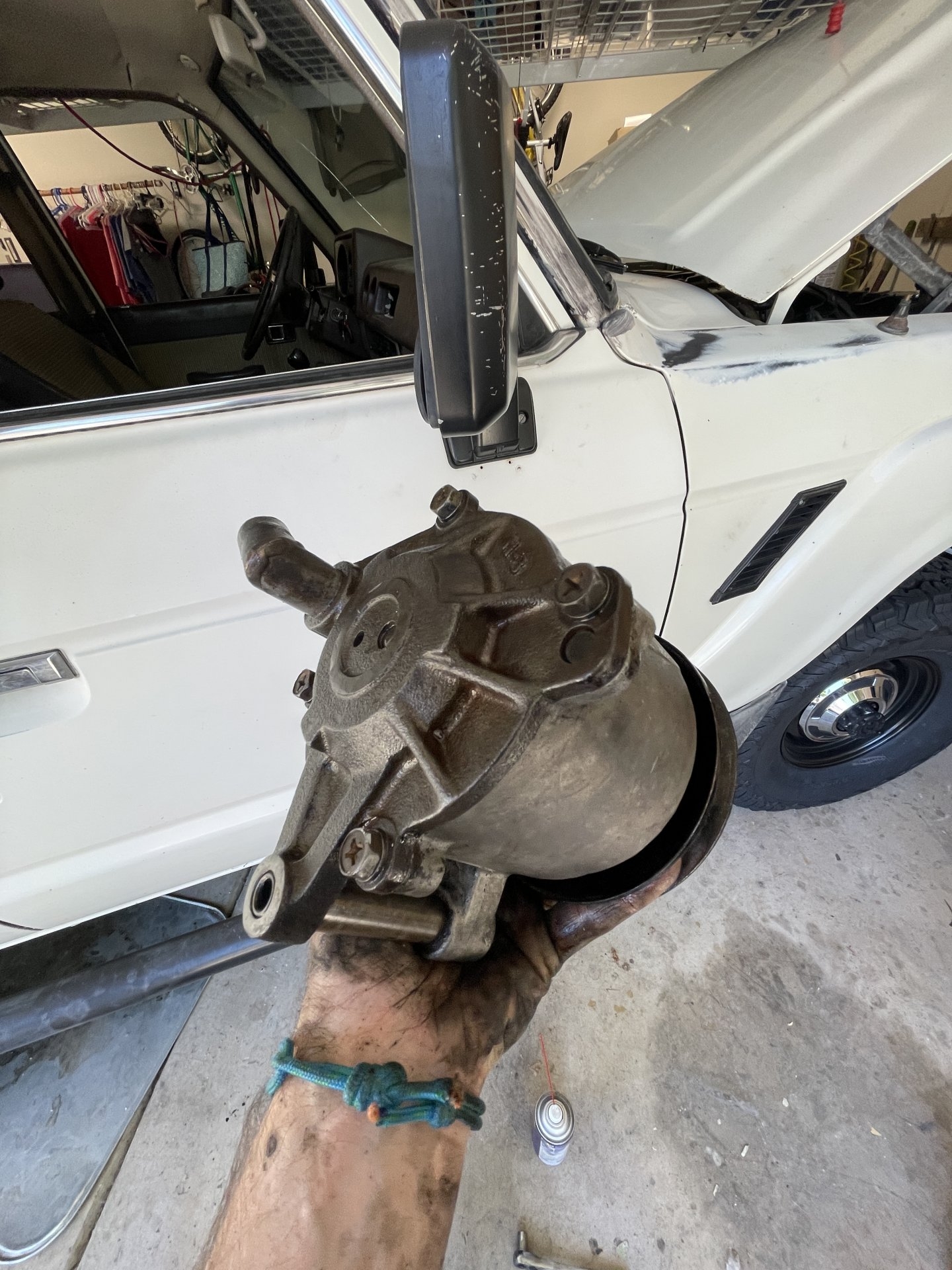

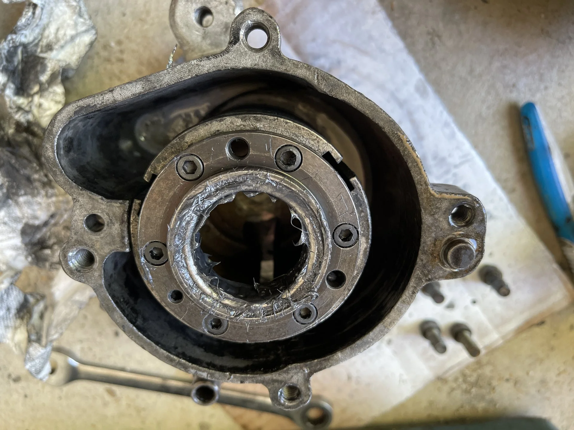

got the timing set, fixed some vacuum line routing, started charging the AC & the smog pump locked up! Was gonna take it in to get smogged first thing in the AM :/
Hoping I can pull it and de-vane then reinstall w/out too much trouble…. From what I’ve read it should run the same but I assume it’ll take a little longer to warm up in the cold? I just need it to pass visual.
here are some of the bits of vane that self destructed!
De-vaned, Cleaned up the pump inside and out, greased the bearing, and reinstalled!

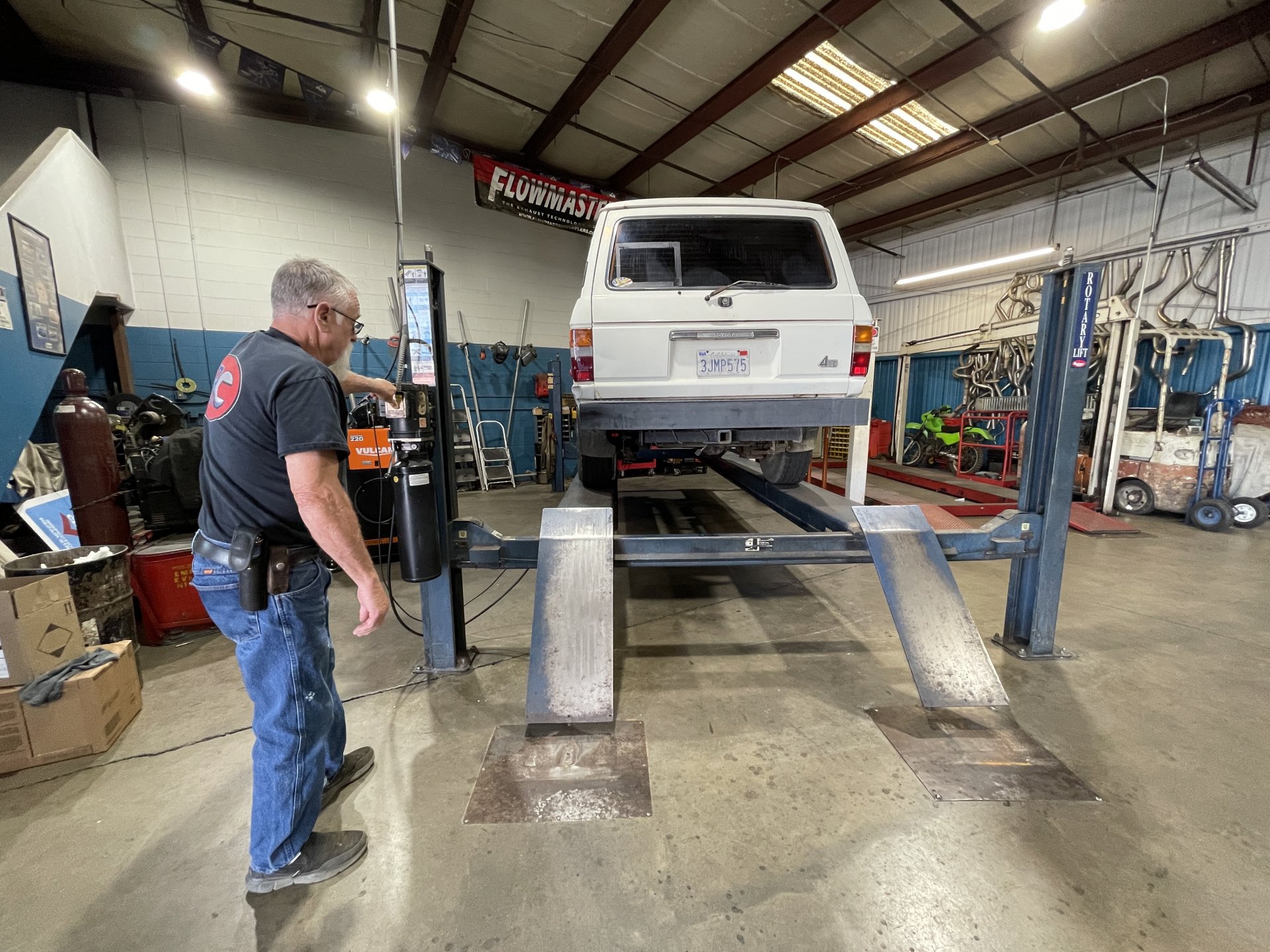

My afternoon opened up today and I was able to get this thing into the smog shop, and it passed! Super stoked, and very surprised!

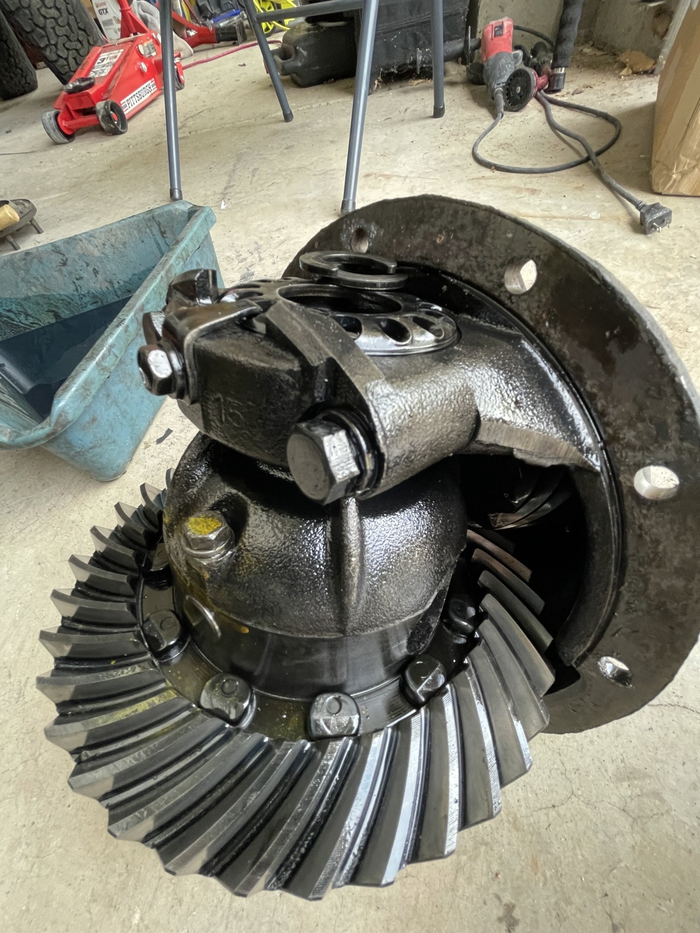

Got into the rear end & decided it would be best for me to take it to someone for a full rebuild…
Will get’er down to Georg as soon as possible!
The gears look to be in good shape for 265k but might as well give it some love.

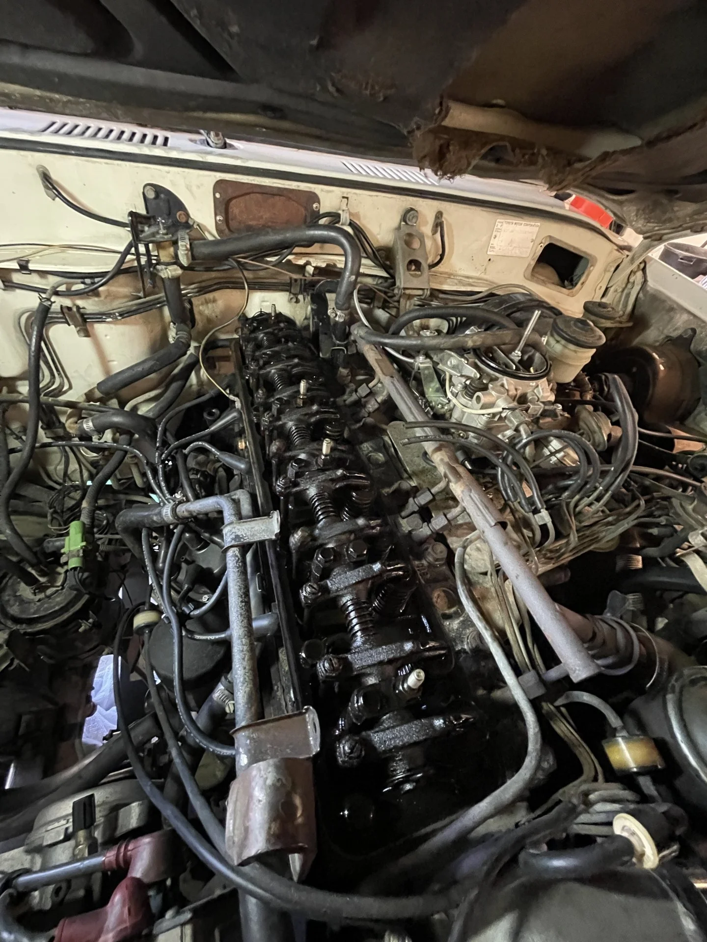

Valve adjustment complete!
Warmed her up & Used the hot specs.
Haven’t road tested it yet but fixed a couple of incorrect vacuum routings and after adjusting the valves my off idle hesitation is gone.
Compression tested finally, got ~120 on all cylinders except 1 which read 115, then 120, and is now holding at 130.
I assume this is nothing to worry about.
