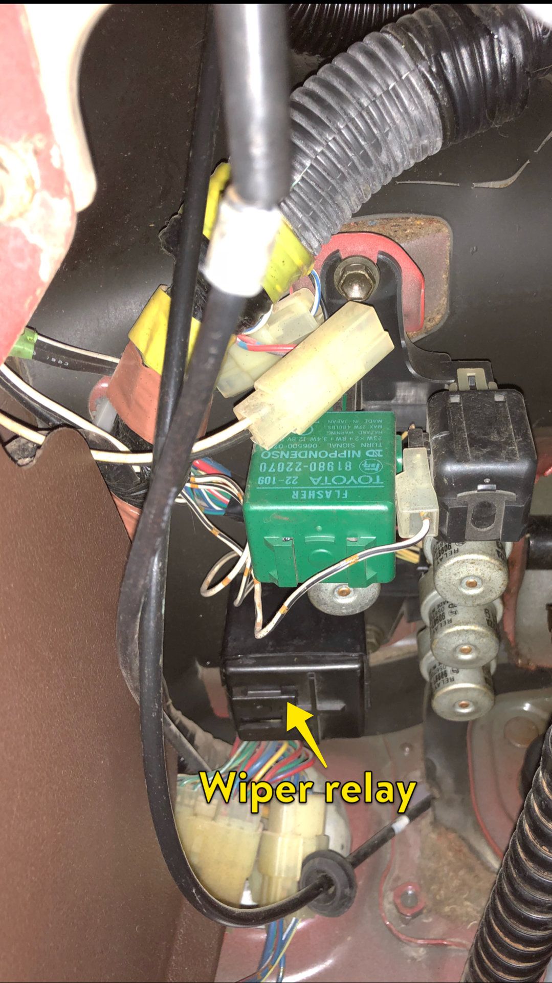

High pitch squeal in between when the wiper is on and moving and when it is stopped. Doesn't happen when you have them on high and they are not stopping, only when it is in one of the intermittent settings. It is not the wiper motor. Sounds like it is coming from behind the instrument panel. Any idea what it might be? some sort of relay or something that I could change out??
Noticed the same exact noise on my 84 on the slowest speed. I am guessing it's the relay but haven't explored it yet. My 60 is the same color if that matters ;)
It does sound like cats fighting in an alleyway a few houses down. The solution sounds like something I could do....so I know what the relay looks like from looking it up......, can you tell me where it is located?
perfect...thanks!!!!
yep....I got around to doing mine and it solved it.......THANKS!!!!
