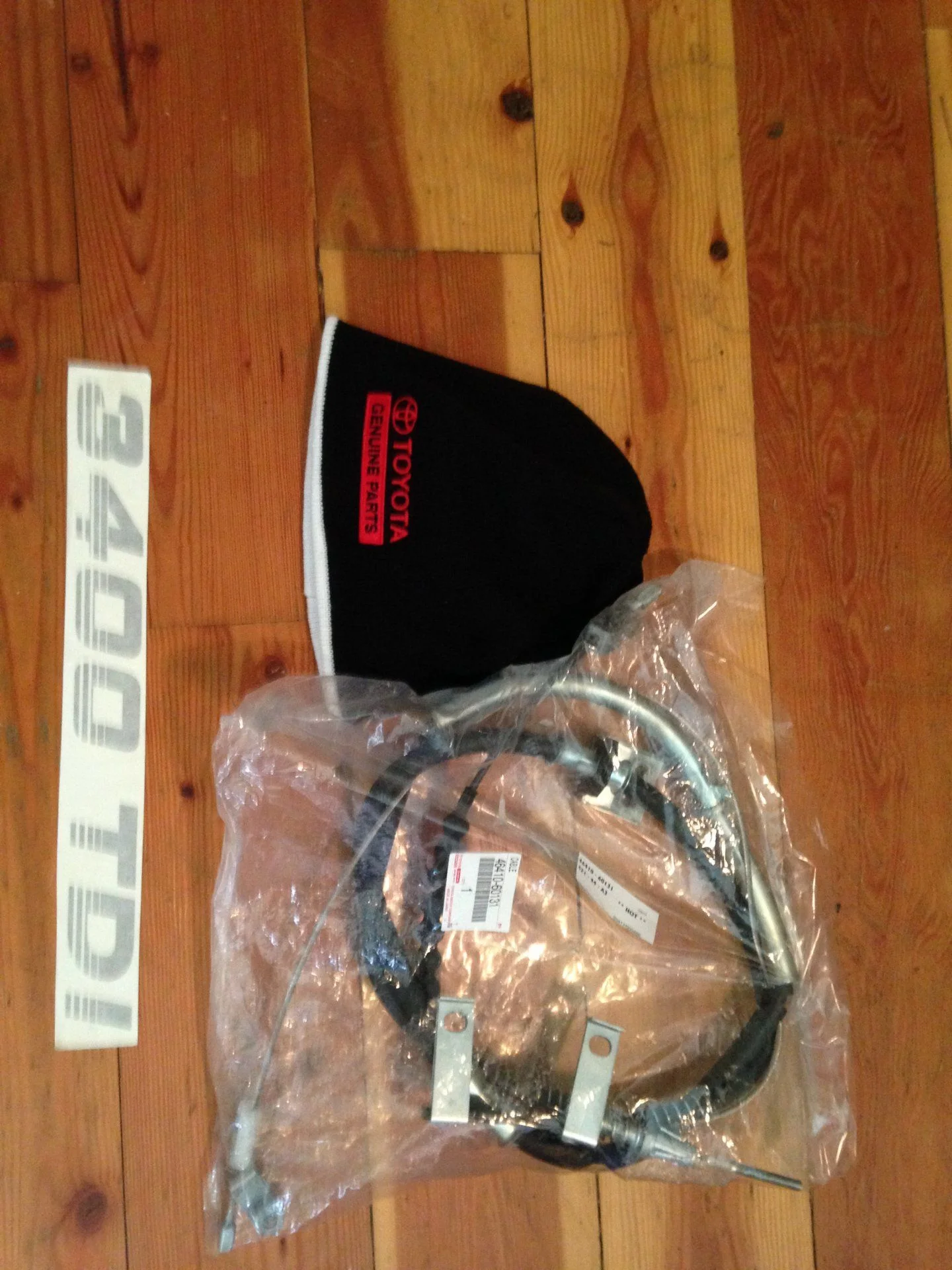

If you need some OEM parts I just received my ebrake cable from Onur, he is a busy guy so you have to be patient..He sent me some swag which was really nice.
He beat Mr. Canuck Toyota even with my discount by a few dollars after shipping..
He beat Mr. Canuck Toyota even with my discount by a few dollars after shipping..View attachment 1432751
Are these people on 'mud that you've been dealing with? Google searches didn't help me, haha. I'm not familiar with either of those folks! Definitely could use ebrake cables, among other random odds and ends.
