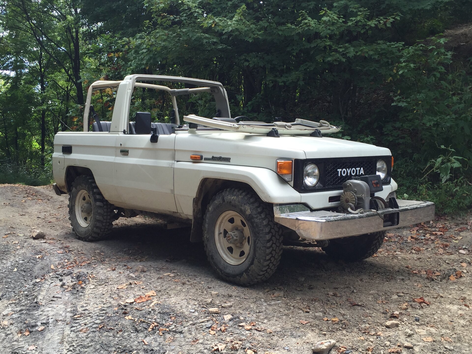

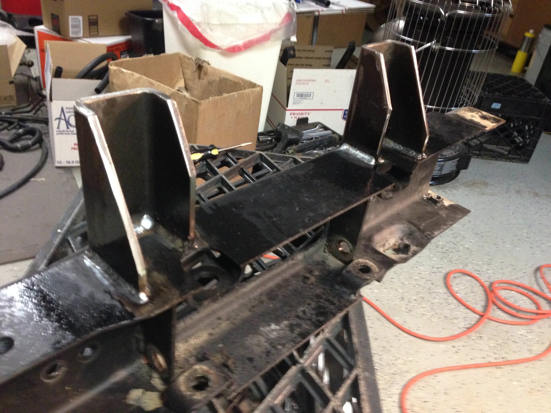

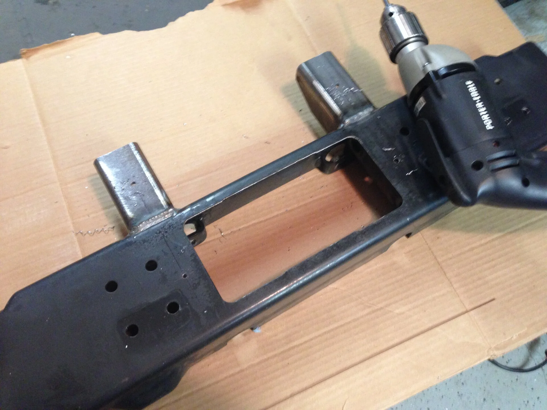

You could do something similar to this (its a 60, but the 70 series frame would be similar):
fj60-narrowed-bumper-installed-jpg.1791652
For Sale - FJ60 stock front bumper (narrowed + winch mount) ... - https://forum.ih8mud.com/threads/fj60-stock-front-bumper-narrowed-winch-mount.1090449/ and "Revamp" - My project FJ60 (SBC + Ranger OD / OME / etc...) - https://forum.ih8mud.com/threads/revamp-my-project-fj60-sbc-ranger-od-ome-etc.906951/
You would need to make bumper extensions and buy a winch plate for the 8274 to mount on, but that would be the simplest option. That or modify a PTO bumper with a winch plate.

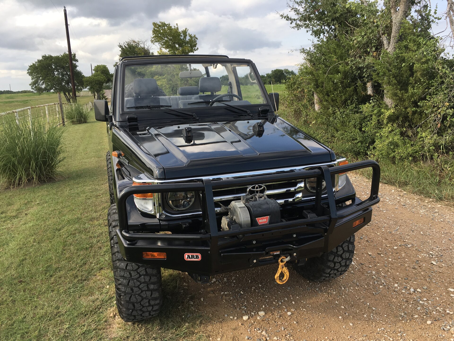

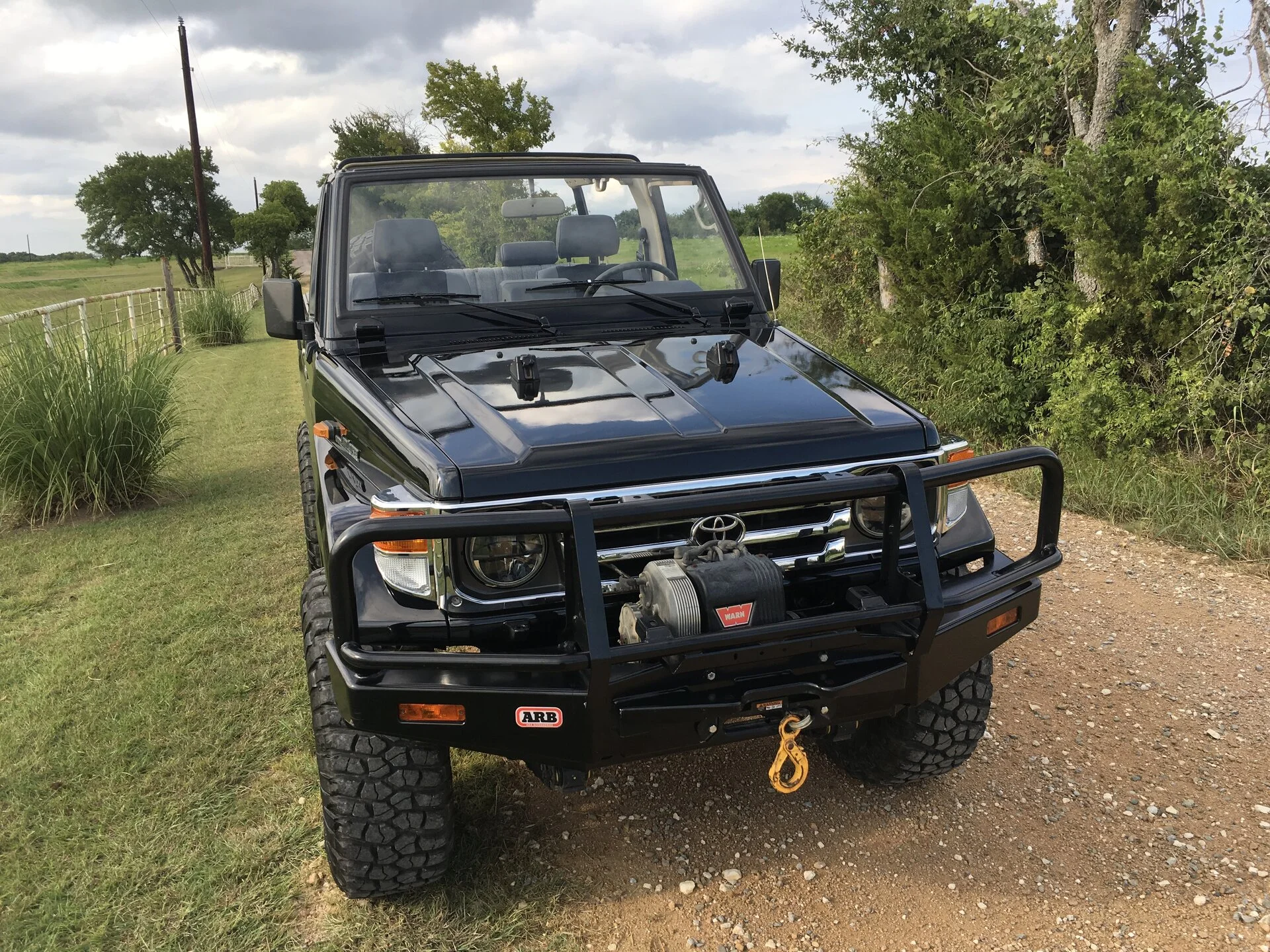

thanks, irish 11 for the information . no other with a picture ?
Sorry I’ve got a 8274 in an ARB bull bar.

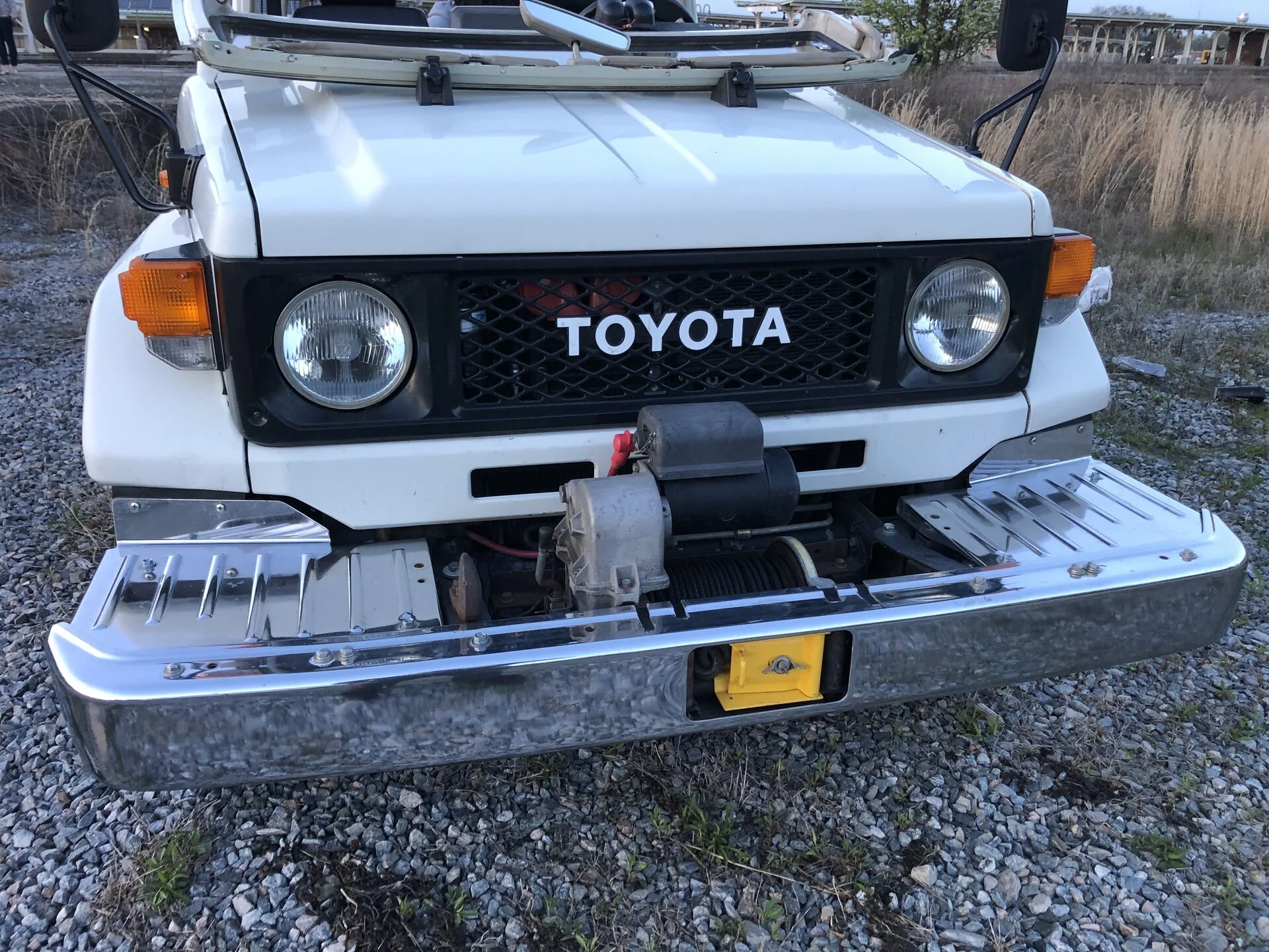

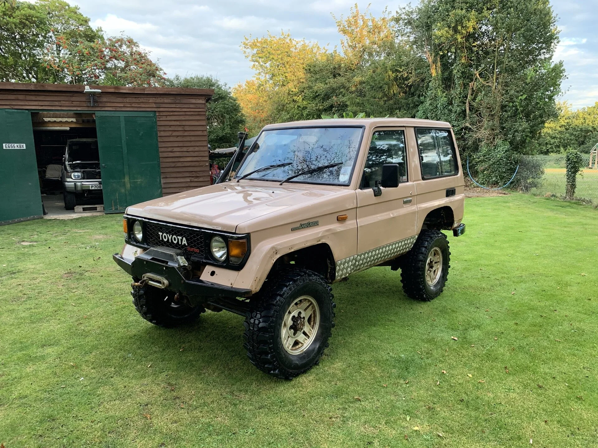

Some photos in another thread came up showing what I think is an 8274 with low profile bumper. The set up looks pretty good.
thanks, this looks really good . i intalled also a arb but now i prefer a classic oldstyle look
