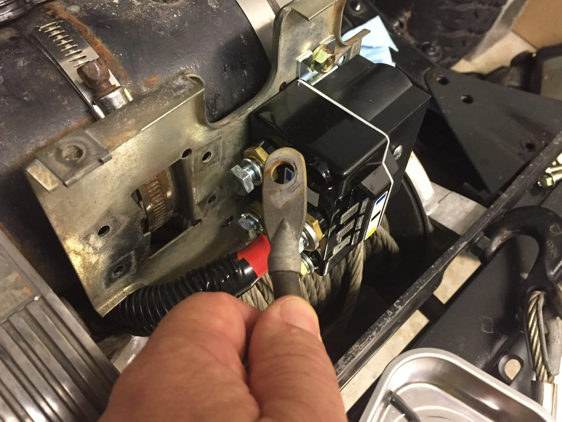

I’m installing a 8274 and went the Albright route. With the thick welding cable from the battery, I mounted it sideways. What gauge wire is recommended for the three wires going from the solenoid to the motor for occasional winching? I’ve seen 2 AWG written, but that seems thick. The second photo below is the wire I took off the original solenoids. That is a lot thinner. What did Warn use? I cannot find it on the parts diagram. For routing purposes I’m hoping 4 or 6 AWG would be okay, but I want to do it right. And since I don’t have a heavy crimper, can I use silver solider lugs like they sell on Del City on a winch application?
Thanks!
I would use #2 copper and I would crimp the ends. If you use undersized wire and just solider the lugs on. The under sized wire is going to get hot and the solider is going to melt out. Then you would have possibly a very loose wire or the wire could come out of the lugs and ground out.
I will check my 8274 tomorrow and see what size wire is coming out of the solenoid.
Thanks. Yeah, the concept of the heat with the solder is what I’m worried about.
I don't remember exactly what gauge I used, but I think it was 2 AWG. The cables were a little difficult to fit under the cover. There are photos of mine in this thread if that helps: Wiring an 8274 + Albright
The thing is, an 8274 draws some serious amperage on start-up, so you don't want to skimp on the cables.
Warn used 2 gauge, so I'd consider that a minimum.
If Warn used 2 gauge, then 2 gauge it is. I won't go less that factory.
